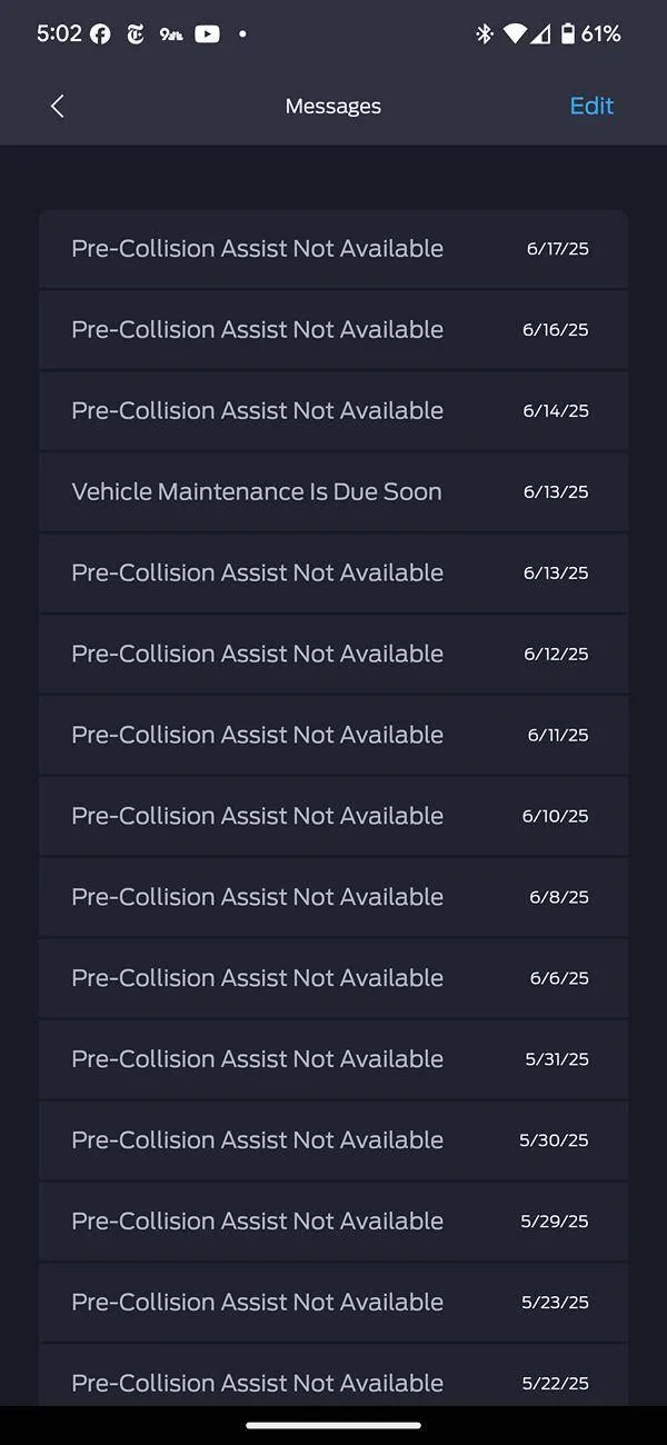

Okay I'm at 550 miles and 2 weeks since I swapped in that new cable and have had no front camera faults. Feeling like maybe it's really fixed!
Fault log clean since 19 June:
Ford Mustang Mach-E Front Camera Fault Errors - Issue fixed! DIY How-to Screenshot_20250703-170217

I just got my first fault today while wife driving 2021 GT. 47,000 miles. Are these pre collision messages showing up in the Ford pass app? I have an extended warranty so I am not sure whether I should take the time to go with doing all this myself.

@Falcon53
Yes, the faults show up in the Ford pass app in "messages". Follow the red dot.
Question: Have you ever had your windshield replaced?

Yes twice. But its been over a year since the last time. It was hot today in Portland area. However when she started car it did not do it again. So far it gas not shown up in app. Maybe it takes over night?
For me, the fault message appears pretty much right away in Ford Pass.

I'm now at about 700 miles and 3 weeks since cable replacement and still no front camera fault ?.
