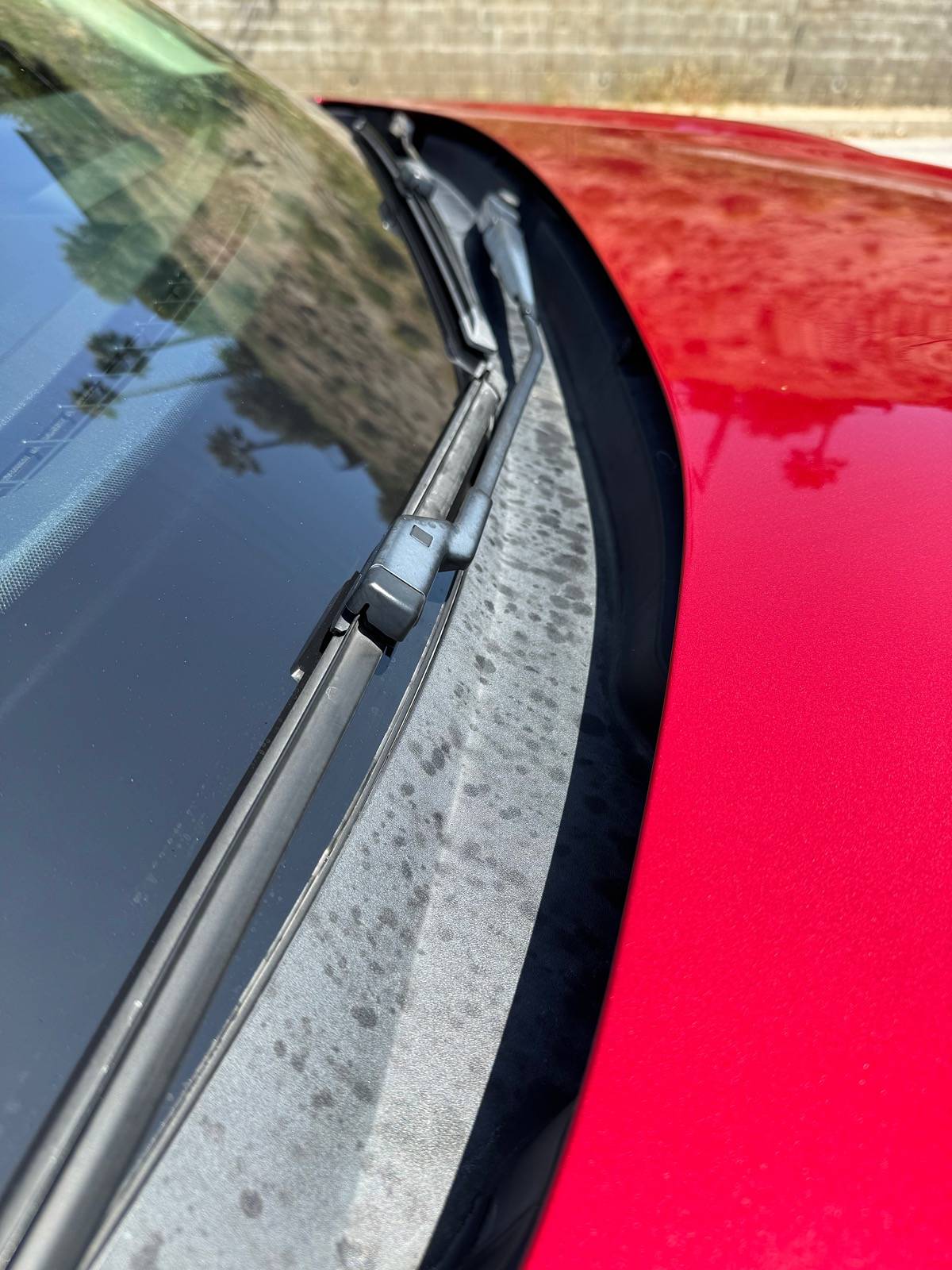

So I think the plastic trim between my windshield and my hood has been stained by tree sap. Is there any way to remove this? I’ve previously been able to remove tree sap from the paint and glass without much issue using alcohol wipes. But there isn’t really any tree sap here, just what I think is discoloration left over from it. Any advice?

Does it look faded to you? The picture makes it look faded. Honestly, if a plastic part was meant to get damaged, I’d pick this one.

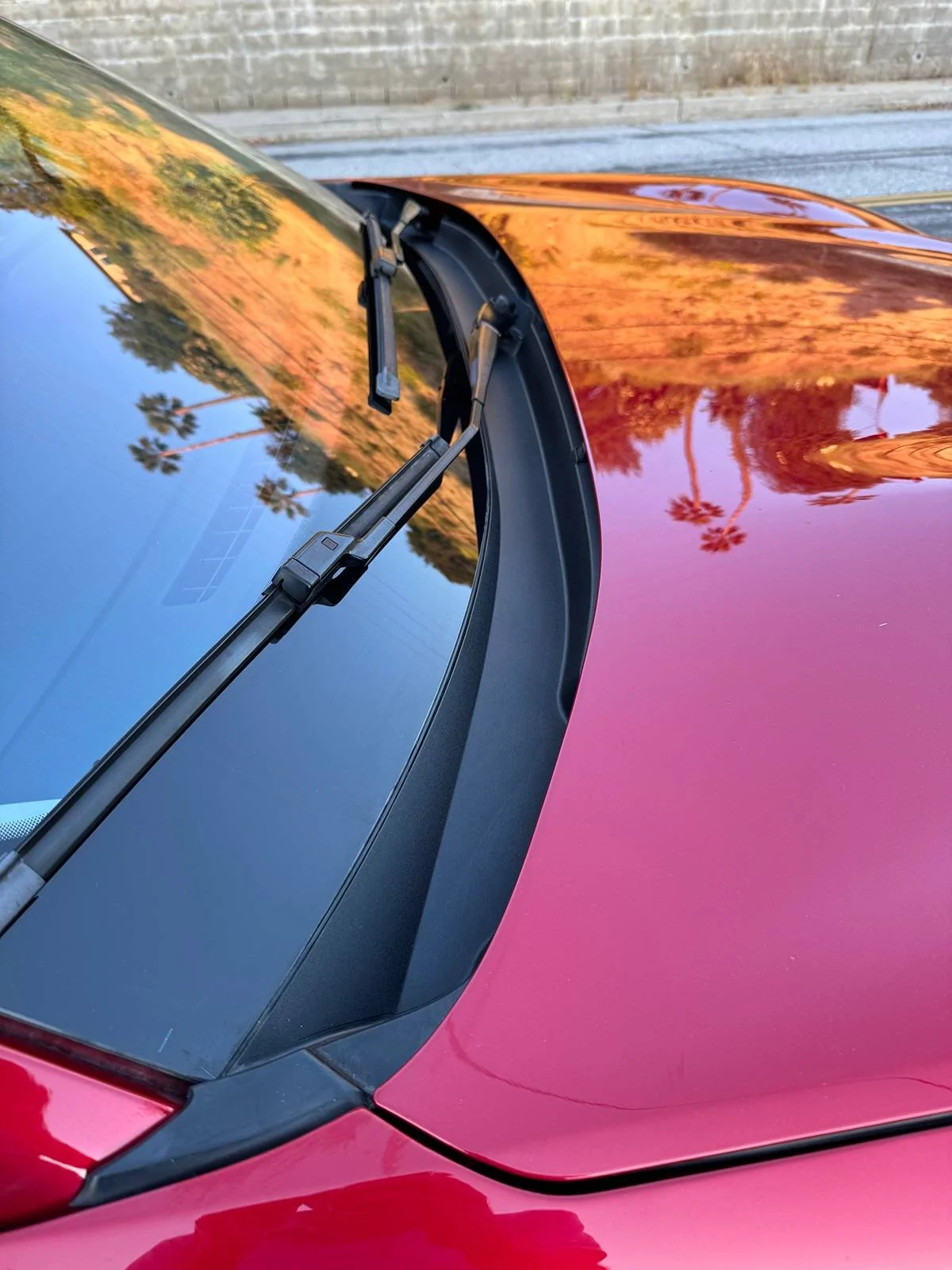

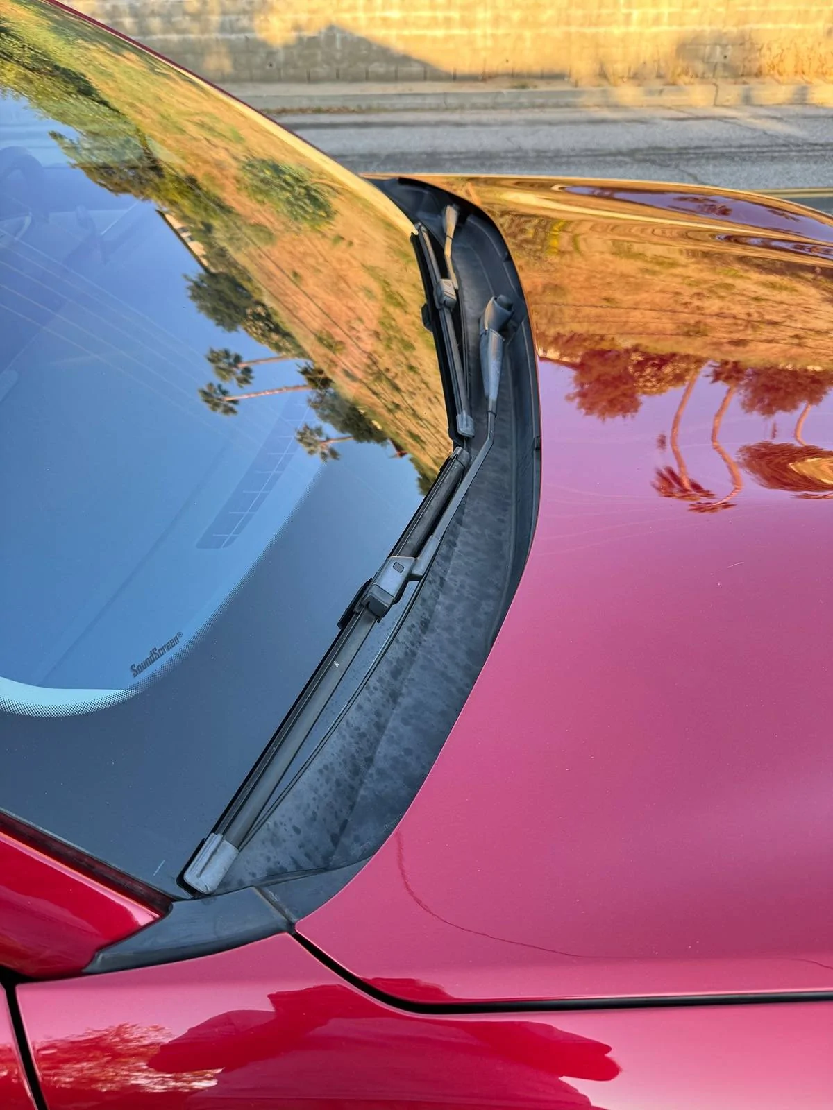

Thank you all for the suggestions and especially @CameraCarl as I purchased the Meguiar's Ultimate Black Plastic Restorer for under $10.
Here is the before and after shot right after I applied it yesterday evening.
Before:

After:
Ford Mustang Mach-E How to remove tree sap stains from plastic trim IMG_2459
For the low price and minimal effort, I am shocked at how much of a difference it made. I think I still may need to clean it up one more time, but it looks almost brand new.
Tagging @GreaseMonkey and @kindofblue for asking for more pics (no didn’t look really faded)/how it turned out.
