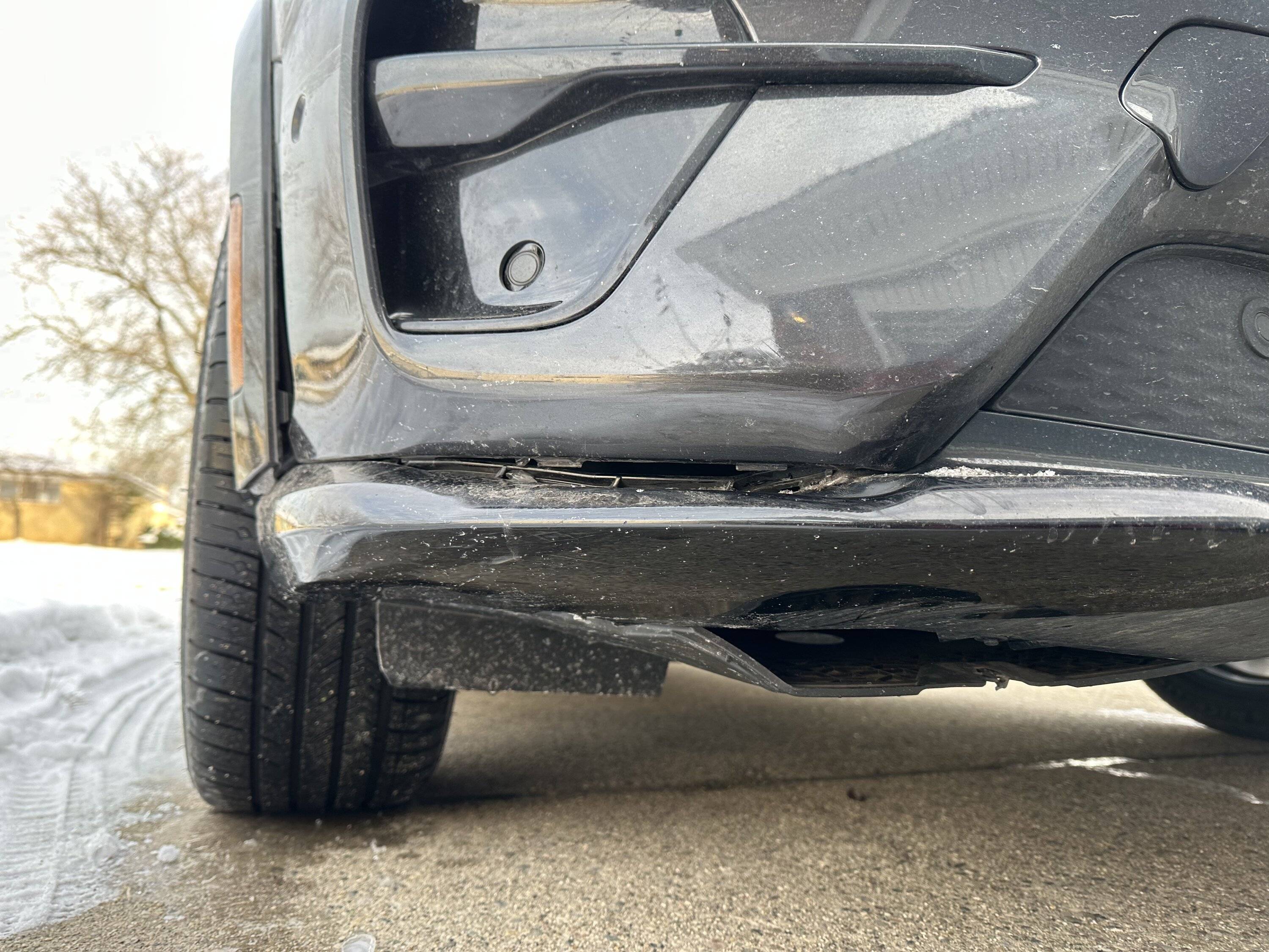

Welp, I got my car back but I noticed this when I got home. Hopefully the conversation with the dealership is fruitful…
To the dealerships’s complete credit, they assumed responsibility. Score 1 for the good guy dealerships!
