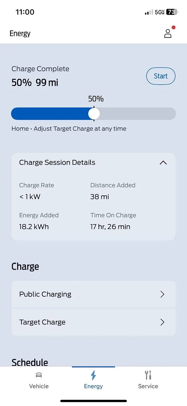

If you're charging at a saved location, you can adjust the charge limit at any time by going to the Energy tab in FordPass and dragging and releasing the slider.
Ford Mustang Mach-E I find the charging interface to be lacking 1740416951591-qk
In the vehicle, you can view your charge limit from the Charging app on the touchscreen. It will show what the current target charge level is, and it can be changed from there as well.

Hitting "start" should set it to charge to 100% this time only.
If you go to the energy tab, there's a slider where you can adjust the target charge. That setting sticks though so once you're done you'll need to adjust it back to where you want it.
