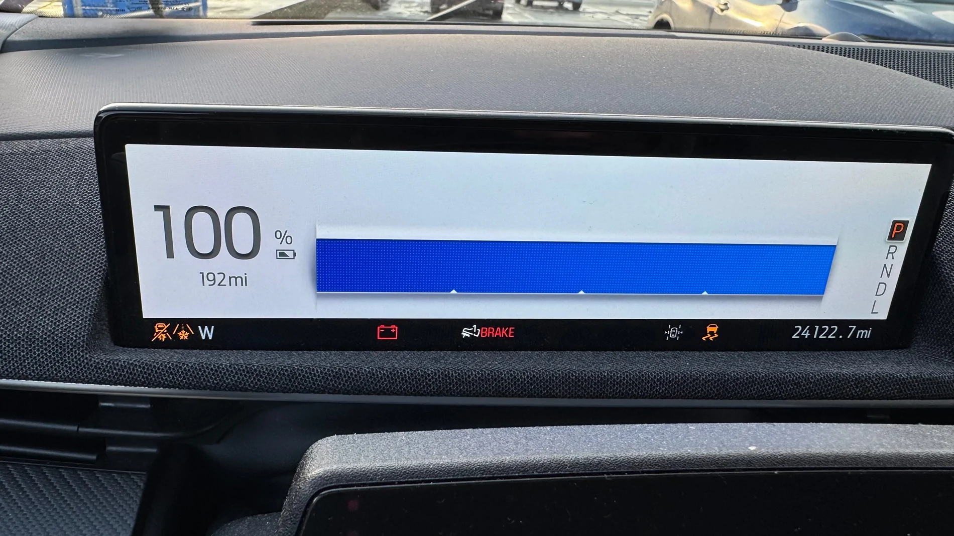

My 4 years of trouble free days are over…
With the cold New England temps and car was not driven for the last 3-4 days.
So today my wife took the car to a store about 4-5 miles from the house.
After 2 hours when she tried to start the car she is getting all kinds of warning and can’t put the car in D.
So I went there with my other car, jumper box (Blue Fuel) and jumper cables.
Car locks and unlocks.
Pressing start gives all kinds of warnings (see pics).
Pressing off moves seat back.
I tried using a Jumpbox but no luck. (To the red post under the plastic cover on the driver side and negative terminal next to it, NOT on the battery itself).
I tried adding jump wires for good 20 minutes, no difference.
I locked up the car and left in the parking lot for the day.
I do have the Ford PremiumCare warranty ($50 72 months/60K, I am at around 24K miles.
I talked to local Ford dealer but too busy to let me talk with service adviser to see what is covered and what’s not.
If tow is covered I would have it towed to local Ford dealer.
Questions:
What should be my next steps to get the car at least home so I can trickle charge the battery?
Maybe use jump wires again tomorrow and charge for 1 hour or more?
Trying to avoid unnecessary two and potential damage to the car.
Clearly I am going to replace the battery (is it possible to DIY)?
Does PremiumCare cover tow and 12V battery replacement?
What about the diagnostics?
Thanks
