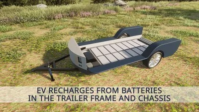

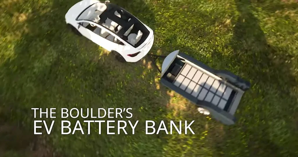

The model, called Boulder, packs a generous 75 kwh of batteries in its lower frame area—within a few kwh of the usable capacity of the growing group of compact electric crossovers rated for towing, including the Volkswagen ID.4, Tesla Model Y, or Volvo XC40 Recharge.
Once charged up, with a CCS-format DC fast-charger, the setup will be able to deliver DC fast-charging output at up to 60 kw, or potentially a boost of 100 miles of range in 10 minutes, the company claims. And to clarify, this is at rest stops; the trailer can't charge the vehicle while in motion.

The advantages of the Boulder aren’t limited to recharging the towing EV, though. The 12-volt DC and 120-volt AC power takeoff capability that’s potentially included with the setup is a solution for off-grid camping and other uses—maybe even home backup in a future application.
Including the battery pack, the trailer’s dry weight is listed at just 1,950 pounds, with a tongue weight of 185 pounds. It notes that the setup is built around a suspension capable of 3,500 pounds.
