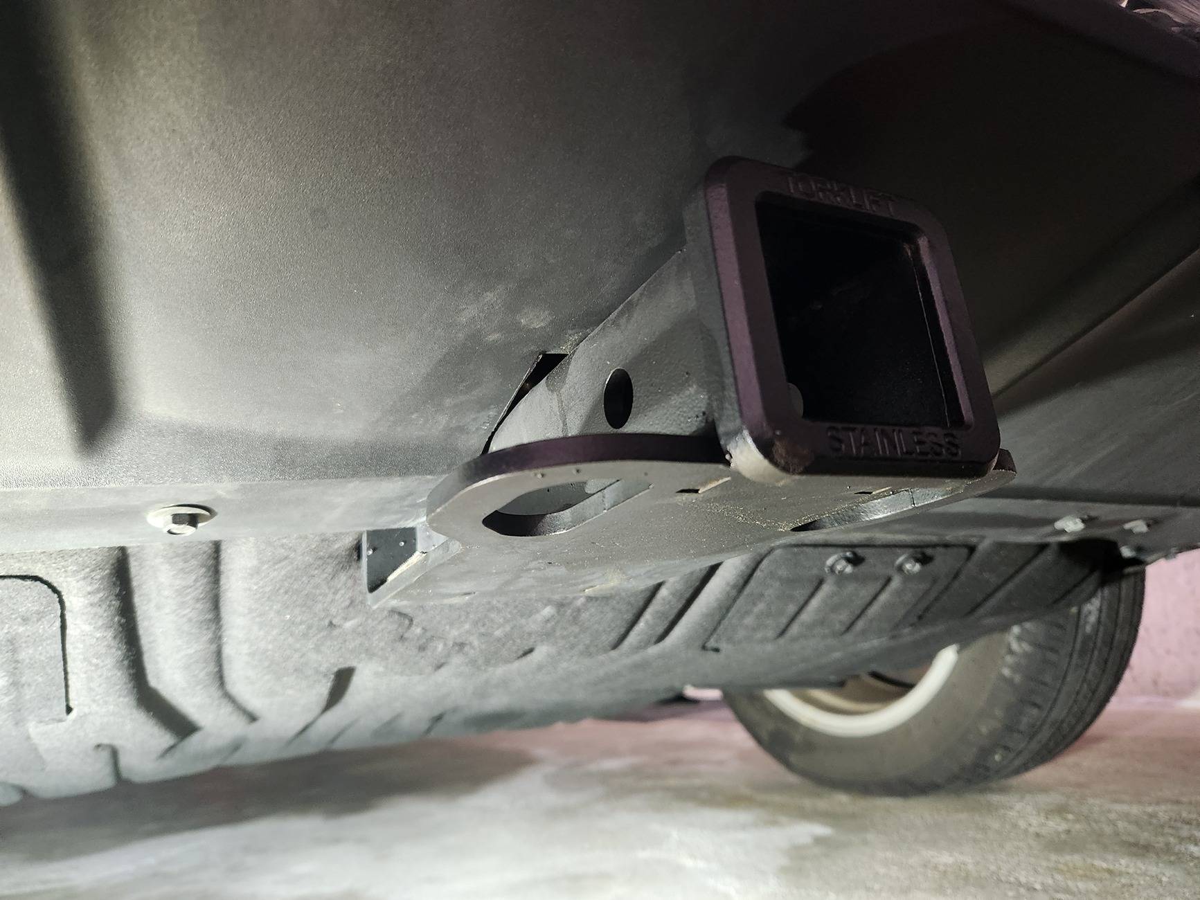

How much did they cut away? What hitch was installed? The bumper cover and mud guard(diaper) should leave no or minimal gaps. The front and rear just can be bent in with no cuts. Also remember that area is exposed from the side anyways. I try to hose that area down every week or so in the winter.
Ford Mustang Mach-E Trailer Hitch Install 20250505_125036

Yes, and it is likely because Ford has not characterized/certified it for stable towing at highway speeds in the US. Structurally the Echo Hitch install is great and other hitches brands are probably fine. From what I see on all the forum hitch install threads I think the majority are using hitch bike carriers or only doing local light towing. I certainly would not tow a heavy boat on the highway.

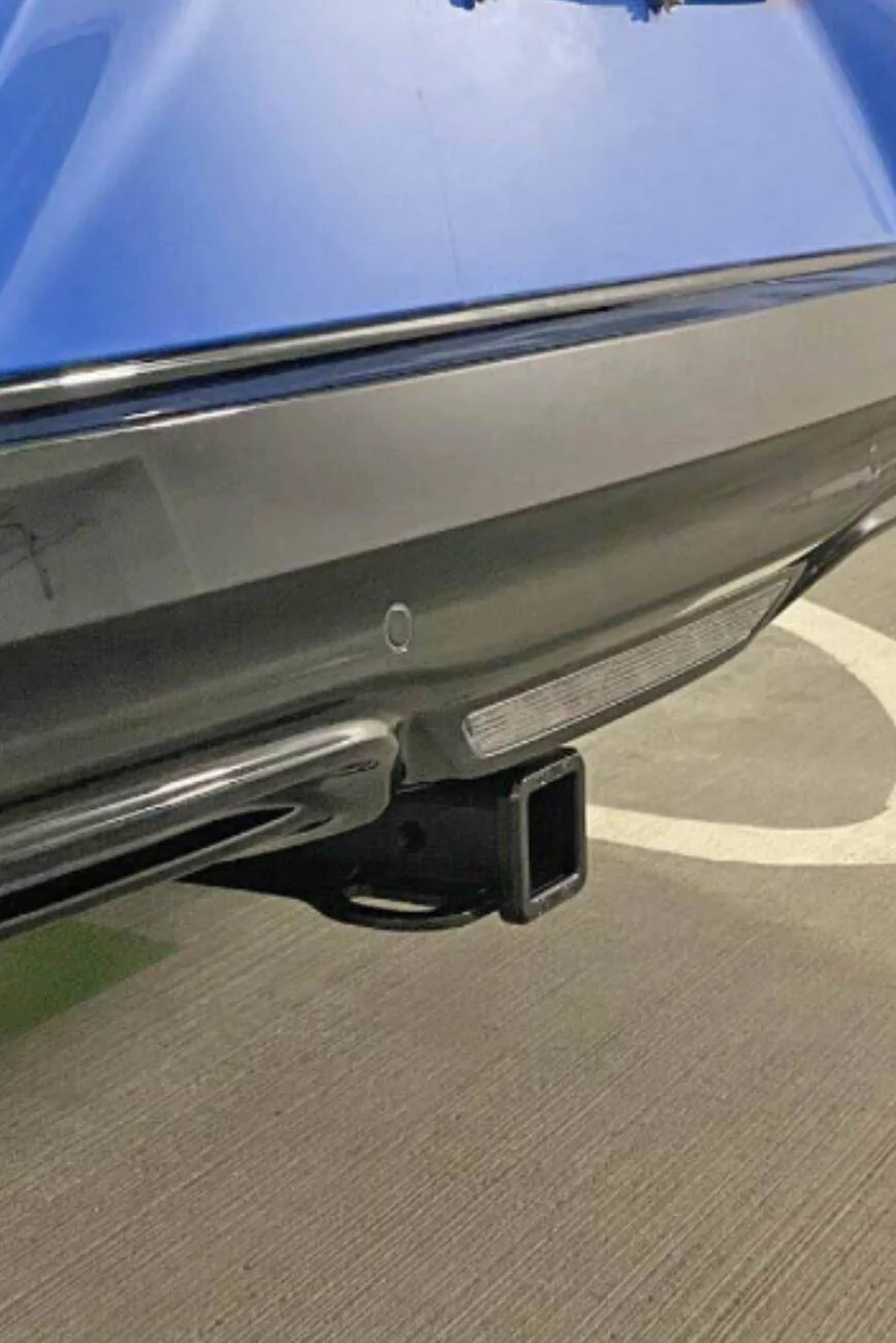

tbrumleve
Tom
Jan 1, 2023
744
987
Oregon, USA
Ford Mustang Mach-E Trailer Hitch Install 1749926924447-79
I have one like this, there is no hole.

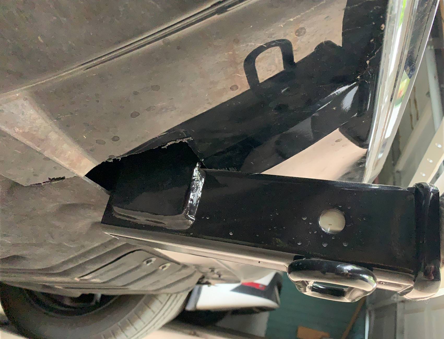

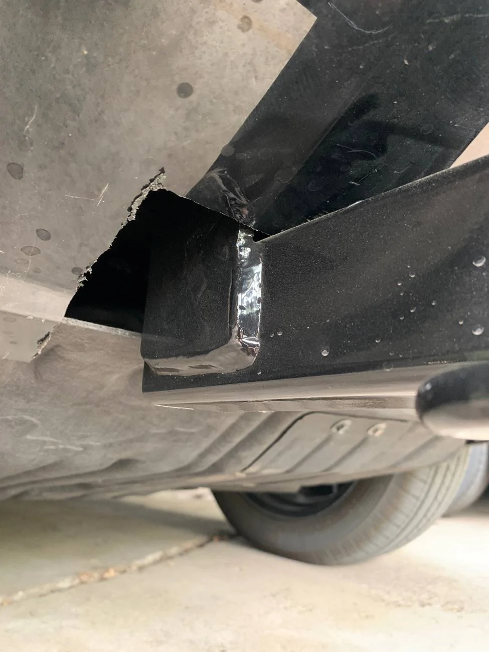

My initial comment was confusing. Uhaul made the rectangle cut in the fascia to accommodate the hitch. The cut is not flush against the hitch and looks like road grime can get under the fascia. Does the fascia need to be flush against the hitch to protect anything. My hitch is only for my one up biker rack. I feel I may have made a mistake getting this hitch.

This a picture of the cit out and hitch
Ford Mustang Mach-E Trailer Hitch Install IMG_1003
Ford Mustang Mach-E Trailer Hitch Install IMG_1006

Look under, you'll see the hole around your hitch.
Sure a hole cut but no gaps more than 1/8" or less, at least with the Echo Hitch, and done carefully. Look at the photos above. This is what OP is talking about.
Looks like the UHaul installers were really careless. I would not be happy with that install which is why I usually do these things myself. I would try to figure out a way to cover the gaps.
