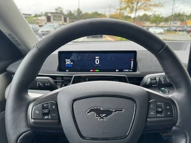

Hi all, this is my first post. I am about to buy my 2nd Mach-e (premium x range) and the one at the dealership is brand new, just built and there is something new... and I am wondering if anyone has heard rumblings of Ford changing the layout of the instrument cluster or if it is a glitch. It is software version 23151.
As you can see, the speedometer in this vehicle is permanently on the right, the way it would have been if you had activated the Lane Centering. There is a way for me to turn lane centering on and off, but the little car stays there and the speedometer is on the right. No settings or anything to change it to the middle now. I have asked the dealership and they think this is just how the new software is.
So, is it a glitch or is this rolling out? Thank you all for the input!

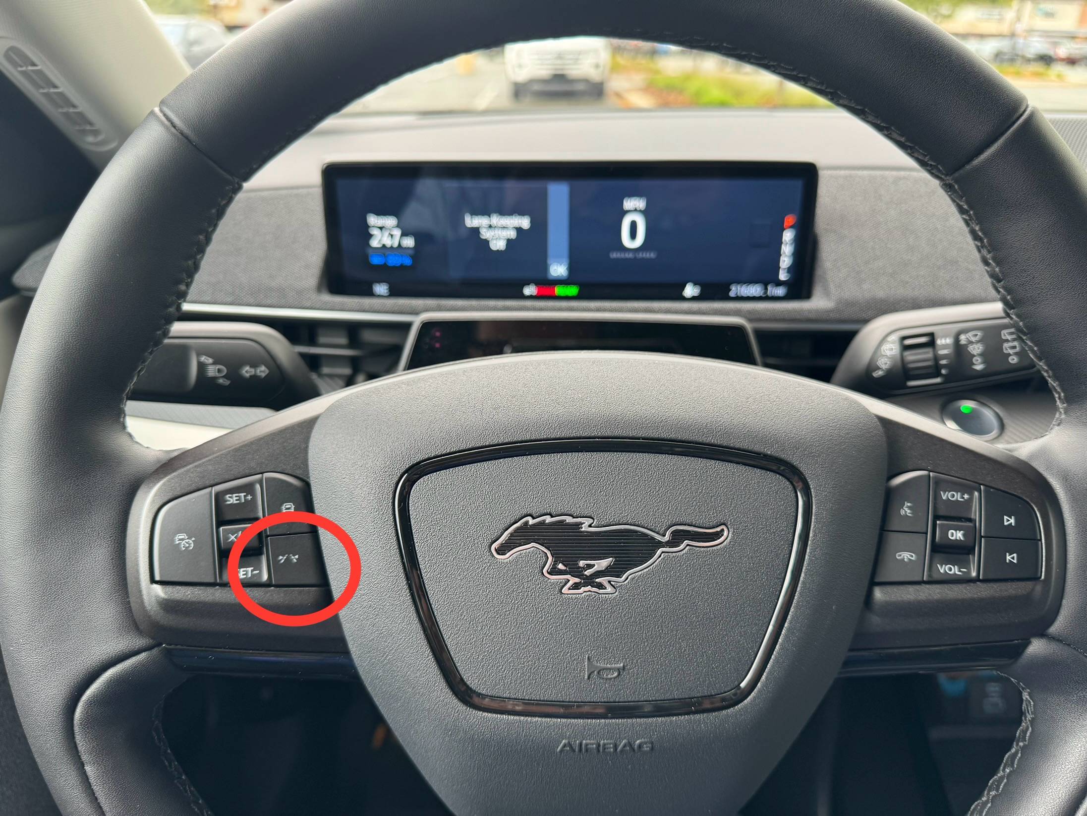

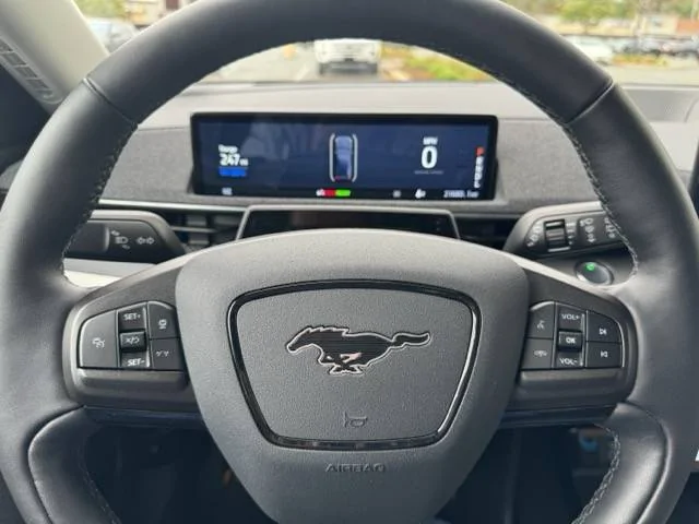

I normally have all ADAS turned on.
Lanekeeping on (via pressing the circled button):
Ford Mustang Mach-E Instrument Cluster new layout? IMG_0017
Ford Mustang Mach-E Instrument Cluster new layout? IMG_0015 Medium
And here’s what I get when i turn lanekeeping off (tapping the circled button):
Ford Mustang Mach-E Instrument Cluster new layout? IMG_0016
Ford Mustang Mach-E Instrument Cluster new layout? IMG_0014 Medium
I believe this is what the OP is looking for.

YES! This is exactly what it is supposed to do. In the one they are looking to sell me, there is no way to put the speedometer back into the centre, even with pushing that button. It should be simple! So, I am wondering if it is a glitch that can be fixed :)
