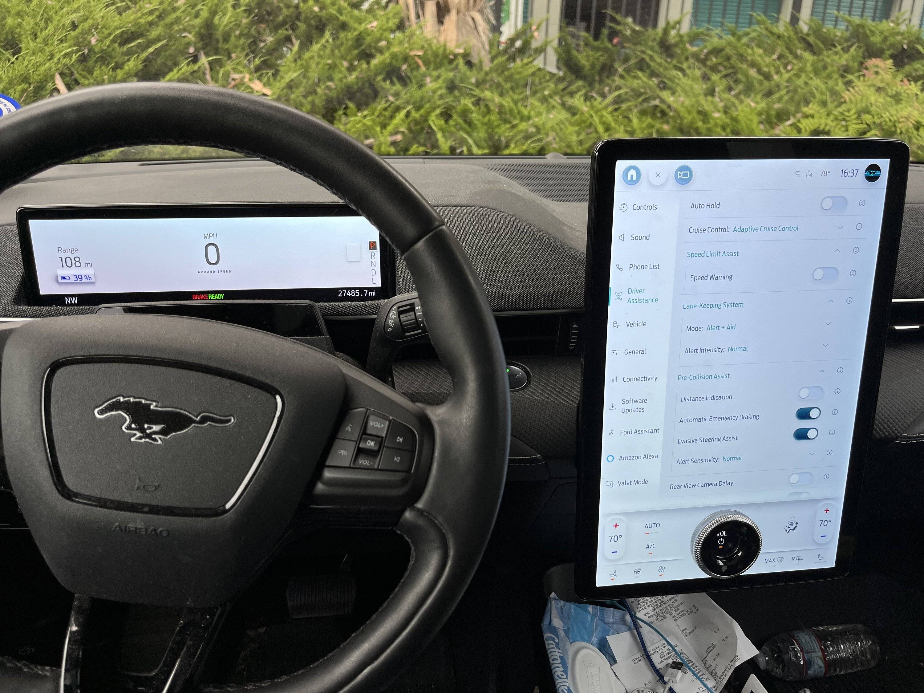

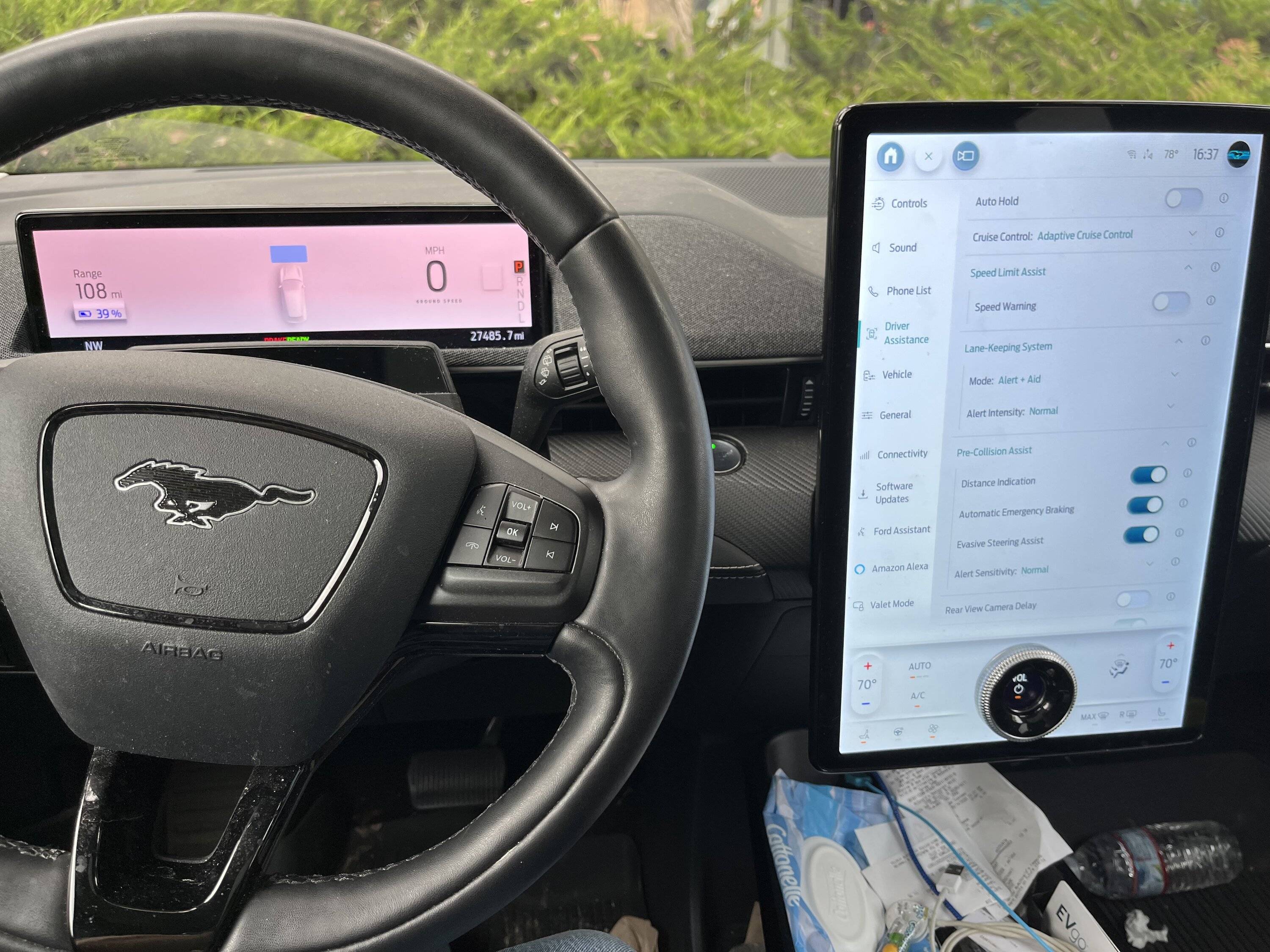

In the settings under Pre-Collision Assist, make sure Distance Indication is turned off or this car icon will remain on your display regardless of cruise control or lane keeping being disabled.
Verified this is true:
Settings-> Driver Assistance -> Pre-collision -> Distance Indication -> Off
Distance indicator On:
Ford Mustang Mach-E Instrument Cluster new layout? IMG_6105
Distance indicator Off:
Ford Mustang Mach-E Instrument Cluster new layout? IMG_6104

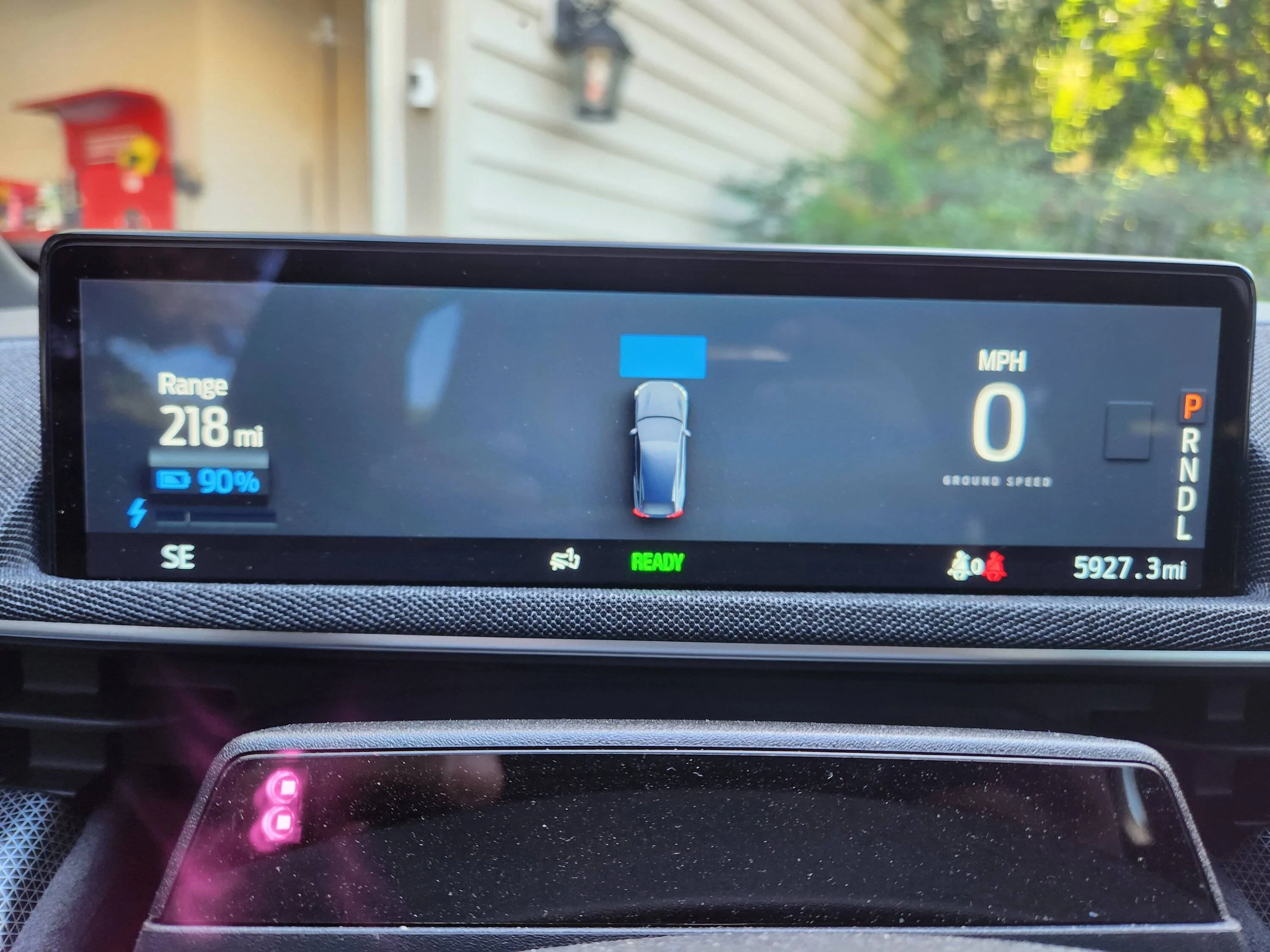

Hi all, this is my first post. I am about to buy my 2nd Mach-e (premium x range) and the one at the dealership is brand new, just built and there is something new... and I am wondering if anyone has heard rumblings of Ford changing the layout of the instrument cluster or if it is a glitch. It is software version 23151.
As you can see, the speedometer in this vehicle is permanently on the right, the way it would have been if you had activated the Lane Centering. There is a way for me to turn lane centering on and off, but the little car stays there and the speedometer is on the right. No settings or anything to change it to the middle now. I have asked the dealership and they think this is just how the new software is.
So, is it a glitch or is this rolling out? Thank you all for the input!

Yes! Please post a photo of your instrument cluster when you can. It has been confirmed to me by Ford that this layout above, with no lines around the car, is a glitch. You should be able to change this layout by following the suggestions as to how that have been shared earlier in this thread. It is quite easy to do so.

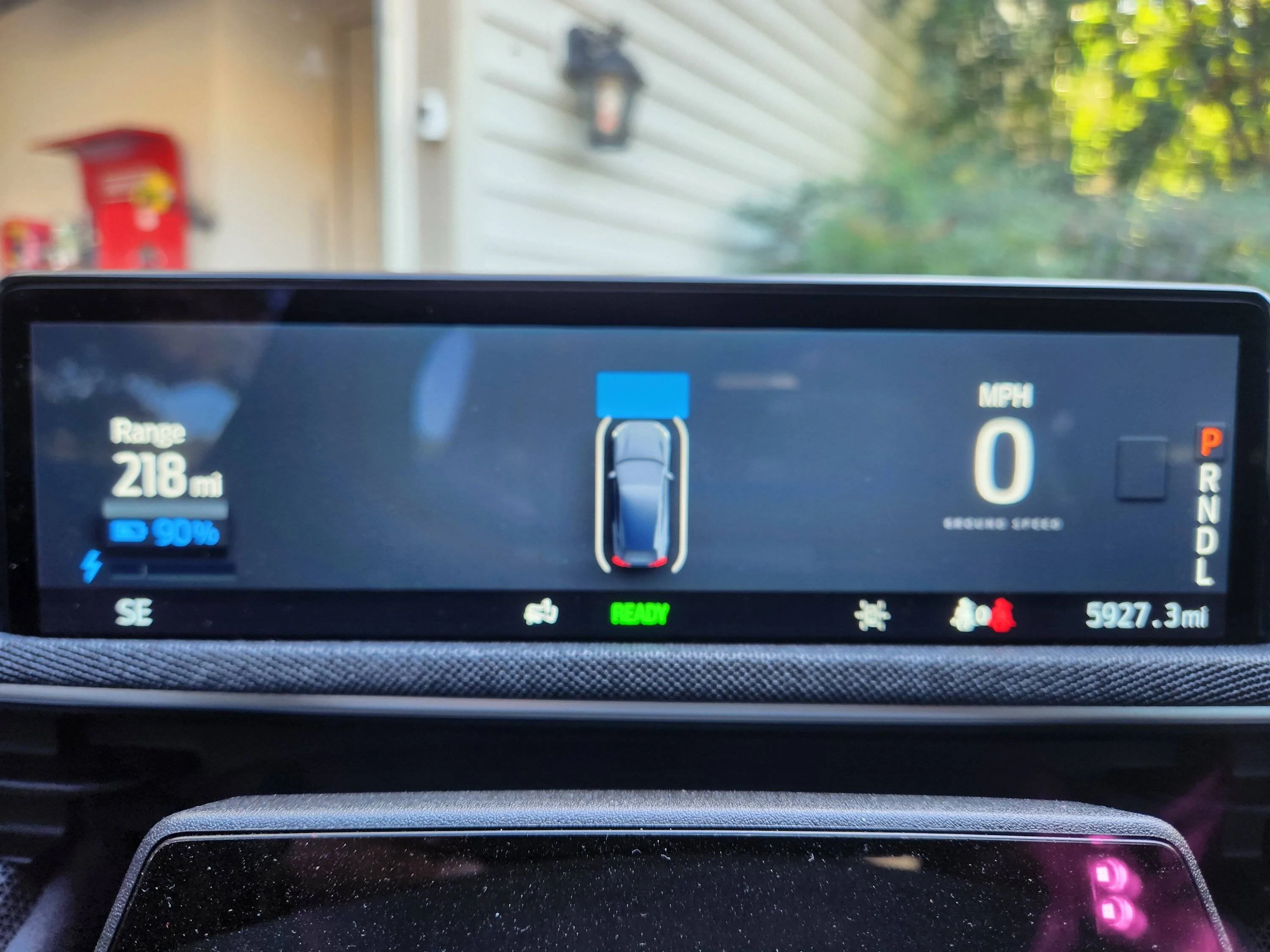

So I do get the lines when I turn on lane keep assist. I was more referring to the speedo placement.
Ford Mustang Mach-E Instrument Cluster new layout? 20231011_110101
Ford Mustang Mach-E Instrument Cluster new layout? 20231011_110110

Hi,
So, the blue block you have on top of the car when lane assist is off means you have to turn off a couple of things to get the speedometer into the middle. If I understand correctly, your cruise control/drivers assistance is still activated.
