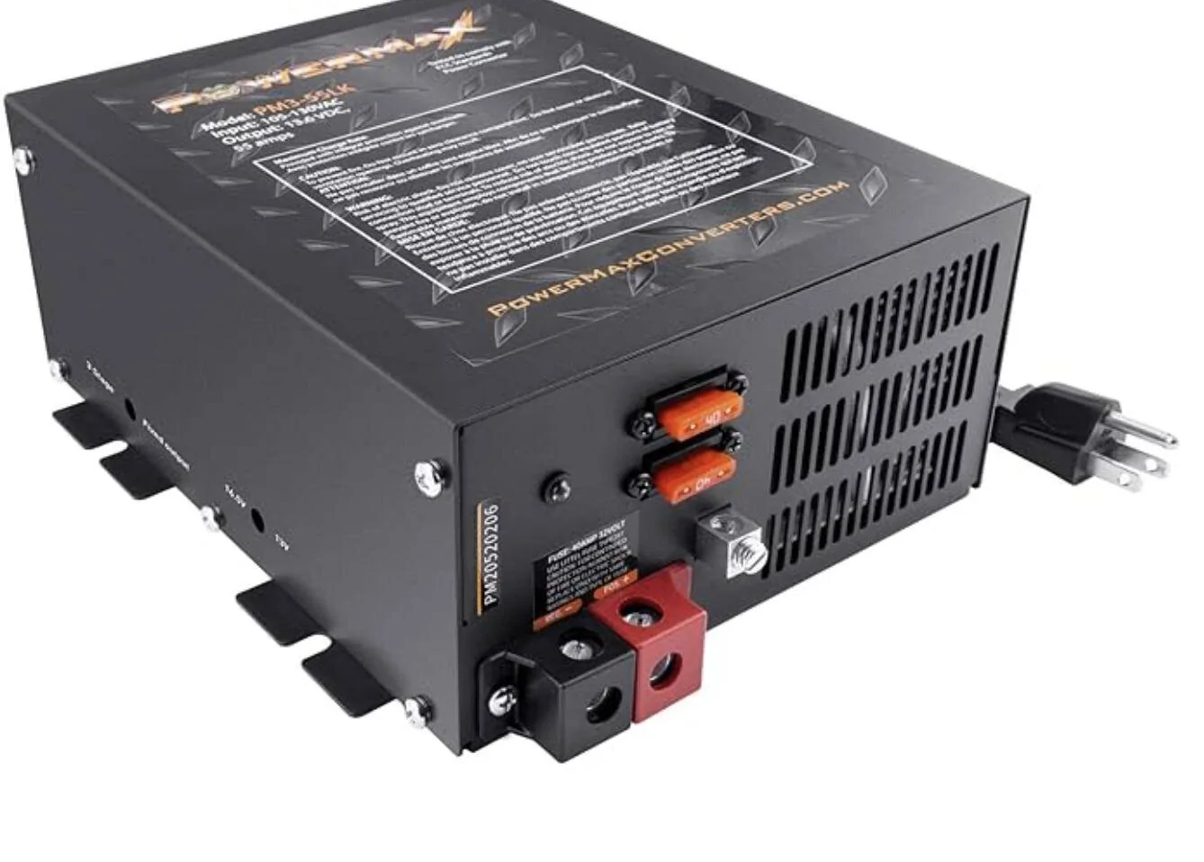

Also If you have a laptop (or PC with a long USB cord) you can get away with just the cord and power supply for $680 (plus the $50 weekend FDRS licence)
Mongoose adapter: https://www.amazon.com/gp/product/B097NHQ7ZW $540
Power supply: https://www.amazon.com/gp/product/B01ER3LH1G $140
Wow that powersupply is substantially less expensive than the Clore 6100 that I see a lot of folks recommend. And this one will do the sustained 40amp continuous output as well?
I did the super long driver monitor camera FDRS update with it and no issues. Battery stayed above 13v the whole time. Just make sure you have quality cables to the battery so they don't melt.
I have this one as well and can confirm it has been rock solid for me.

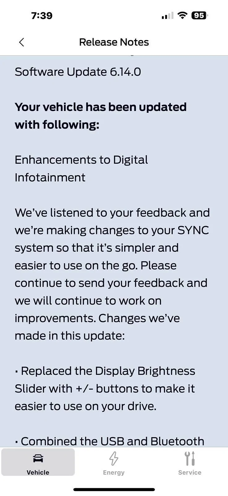

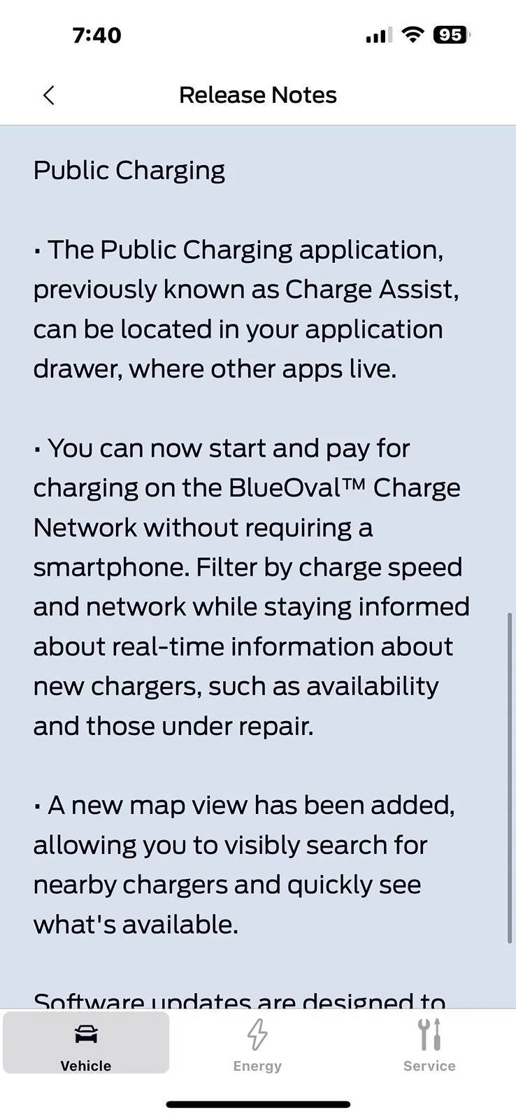

Ironically, yes. We have to pay Ford for access to apply the updates we should be getting free via the OTA process. Go figure.
Don't have FDRS - got ECG and 6.14 just this week.
By chance do you guys have any cables you'd recommend to go with that? I assume they dont' come with any.
I used a set of heavy duty jumper cables and cut them to a good length and crimped them on.
Gotcha. So the end of the jumper cables can be cut and inserted into the terminals on this PS..
