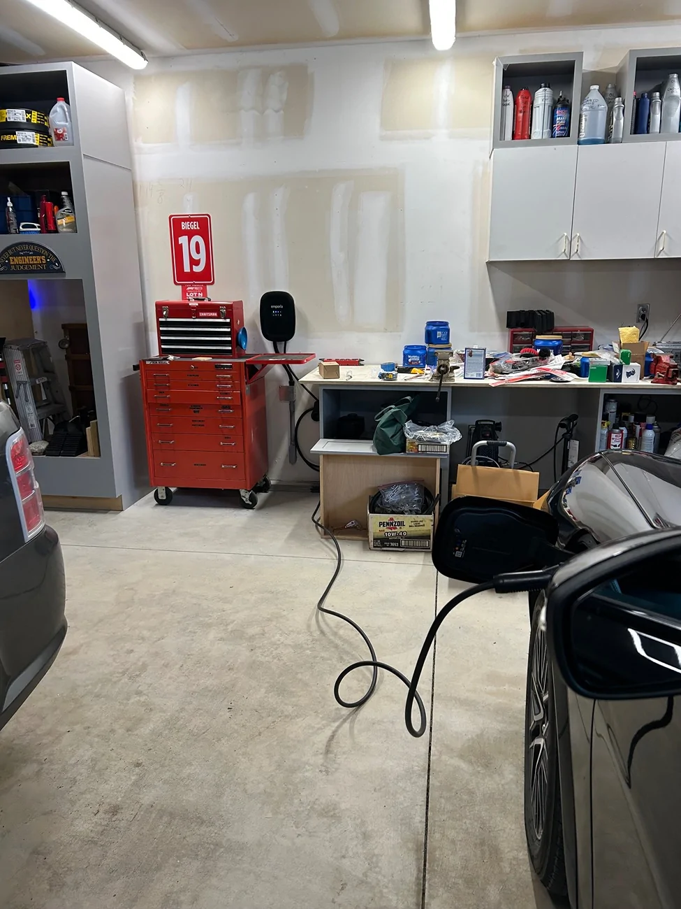

Also, no matter what setup you go with, deciding on the mounting location in your garage or outside needs some thoughtful consideration. We put our Ford Promise hard-wired Emporia on the center of the back wall for the following reasons: 1) We have a side-entry garage and prefer to pull our Mach E straight in. Backing in could have worked as well, but we find that the rear camera can become fuzzy due to the weather in our area. 2) It was the shortest distance from my basement breaker box. 3) The Emporia cord length is generous, so I can easily reach the front left fender charging port on my Mach E in either of the two garage spaces. 4) My daughter and her fiancé occasionally come up from NJ in their Tesla 3 and can back in to also easily reach the back left charging port on that car.

I second the placement focus.
We have a 3 car garage, with 2 bays for cars. We pull into the spaces forwards, and aren't going to back in. When we bought our Mach-E, I took a rope 25' long and laid it out to see where it would reach the charging port of that parking space with ease. THEN, I said, "what if I park it over there?", and laid it out to the bay on the opposite side of the garage. Then, I ran the rope from the mounting spot to the outside of the garage, for the very rare (hasn't happened in 4.5 years) situation where someone might need to charge outside. And I considered what if we shared the circuit (which our chargers handled).
When our first charger was installed by the electrician, I went to lay out the charging cord and said "something is wrong". Yup, despite advertising a 25' cord, it in fact was around 18'. The electricians (who supplied the charger as they were also a distributor) were clueless. I contacted the company (this was during Covid), and they discovered that they had shipped a "big box version" of the charger, which comes with a 20' cord. I pointed out that the cord was 18', and they responded "you have to measure the handle too". Ok, 18.75', not 20'. They made 25' cord (well, 23.75') charger and shipped it to me and paid the electrician to swap it out. I ended up getting the charger for free, because they shipped them a replacement unit also (so he was made whole) and they never invoiced me...
Anyway, we added the Lightning 2 years after getting the Mach-E, then swapped bays for the car a year later. Now, the charging cord runs from the mounting spot across the back of the garage then to the Mach-E charging port, clicked into a holster mounted on the wall. Nothing had to be relocated due to playing with that 25' piece of rope.

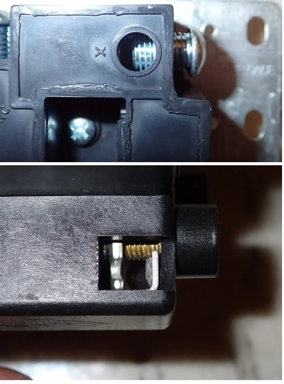

So I really do just have a simple question for you. Do you feel that if a receptacle that is not properly tightened is susceptible to potential problems no matter the quality? And hardwired chargers are not found to be a cause of any major issues in the near future l?
Proper torquing of the terminals is critical. And you need a torque wrench or screwdriver to do it properly. But the higher quality receptacles have terminal screws that make proper torquing much easier. Allen screws with saddle clamps vs slotted screws that twist directly on the wire.
The top one is the cheap Leviton.
Unfortunate circumstance there, but the customer service to resolve it was exemplary.
Adding to this, keep in mind, you can buy extension cords for EVSE's, to extend the reach. We bought a 12' extension, for our 20' Emporia, in case we need to reach outside the garage on occasion.
