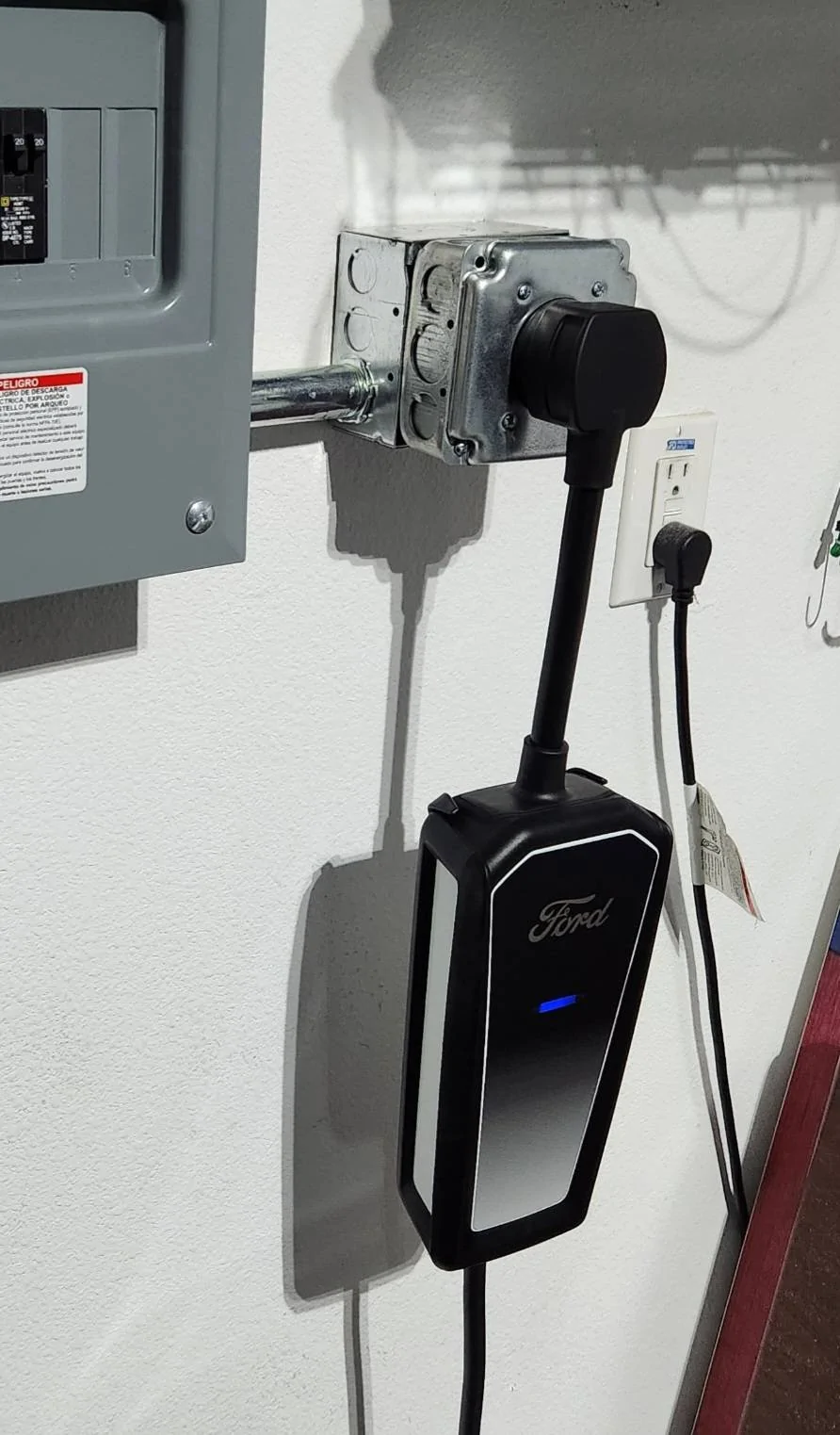

Is it okay to leave your charging cable plugged into the 240 wall socket when not charging?
I unplug mine after every charge, but it is difficult to unplug and I'm worried that I'll eventually ruin the plug.

Yes it is perfectly fine to leave it plugged in. However, you should properly mount the EVSE to the wall using the included bracket (which is already attached to the EVSE). Leaving it hanging like that from the outlet will cause the outlet to fail and possibly the EVSE itself.

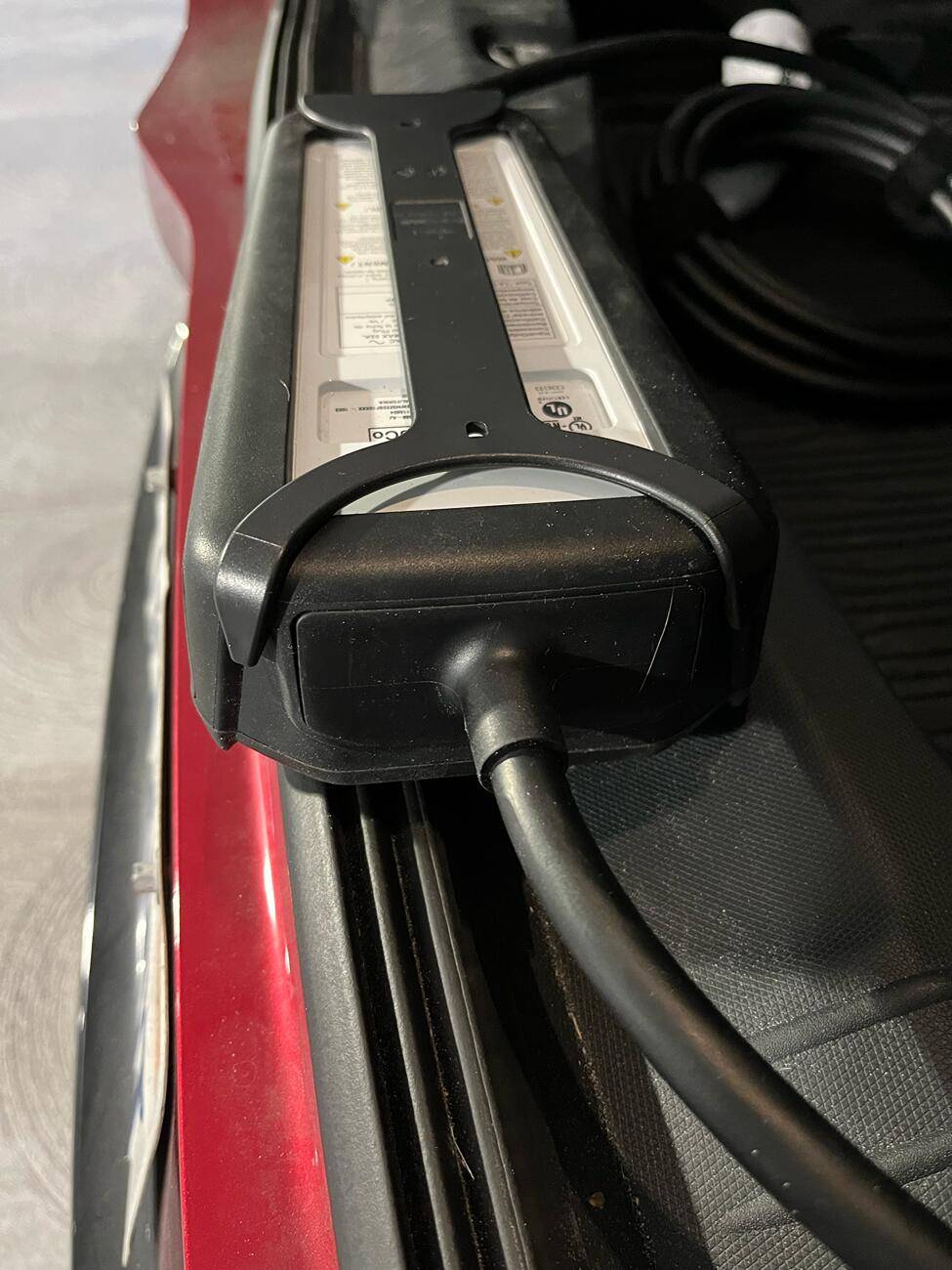

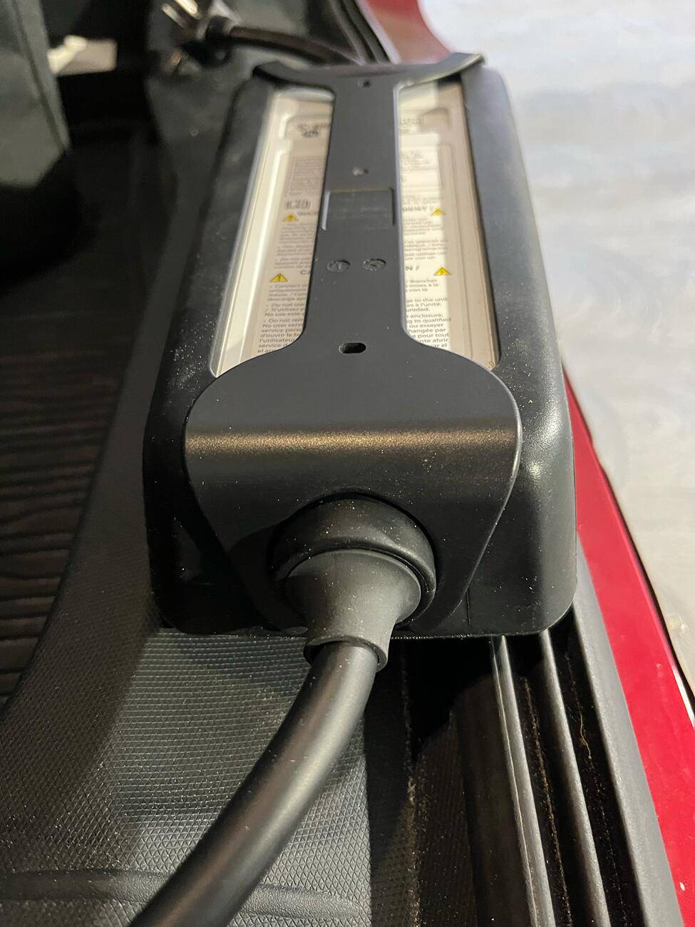

It absolutely did. Here's what mine looks like with it attached (so it doesn't get lost):
Yes indeed sir. Mine was in the bag and I never thought to look for it.
Thank you

...Leaving it hanging like that from the outlet will cause the outlet to fail and possibly the EVSE itself.
I wonder if this is really necessary. There doesn't seem to be a lot of downward pressure on it. If there was, it seems the bigger fear would be the adapter unplugging.
BTW, Mine extend out from the wall like the one above as well, and to get it to tie into the wall actually seems to be putting more pressure on that connector and outlet than leaving it alone.

Well, they wouldn't include it, and tell you to use it, if it weren't important to use it. Gravity will eventually pull the plug out of the socket, and the pigtail out of the EVSE.
You can screw a piece of 1x4 or 2x4 to the wall, and then the bracket to the wall to make it fit better and not put strain/pressure on the pigtail.
