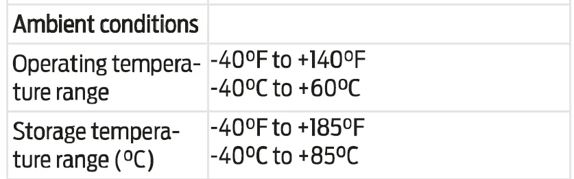

When I was surveying my options over a year ago, the two that came to the top for me were the ChargePoint Home Flex and the Ford Connected Charge Station. This was because of their high heat ratings (very very few EVSEs are rated so highly on temperatures). Here is the spec for the FCCS, for example:

I also want the EVSE to be UL Listed or Intertek tested. This eliminates most of the Amazon options, for instance.
I also want to be able to configure the maximum amperage.
So when it came down to it, I had a ton of FordPass Rewards points from the vehicle purchase (especially because I used the FordPass Rewards Visa card). And also, the ChargePoint Home Flex was out of stock. So I went with the FCCS because a local dealer had several in stock and would accept rewards points towards payment, making it less expensive than the CPHF.
If I had to buy one today though, I'd go for the CPHF (if it's available). They're both reliable at charging the vehicle, their main task. But the CPHF is a better "smart" device, it's more reliable for those features and provides more, better stats/graphs and so forth.
