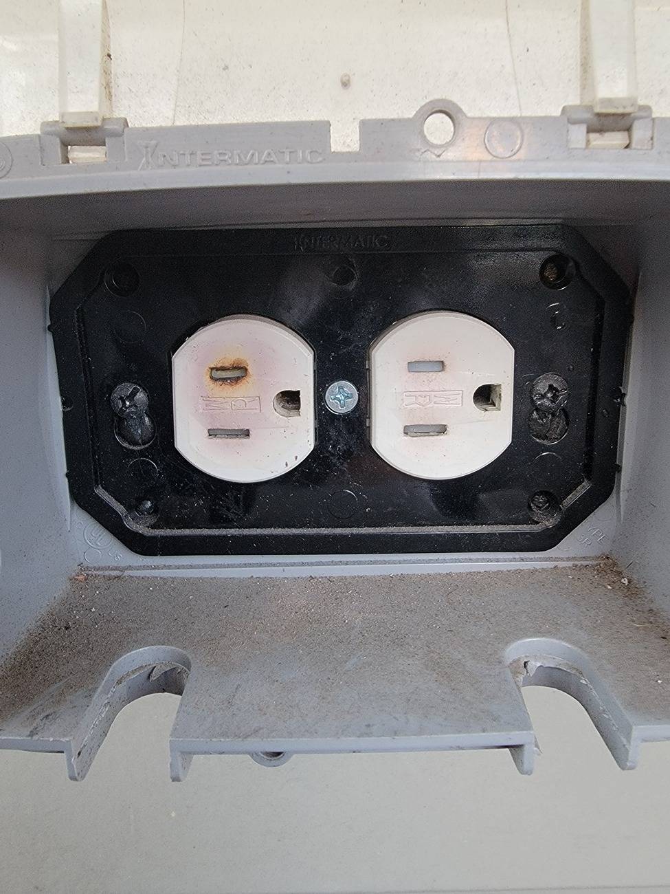

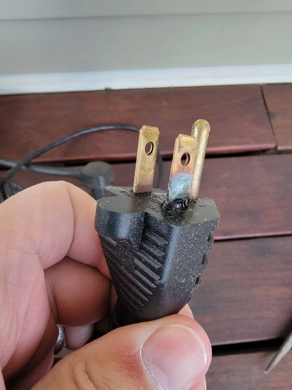

We've had our Mach-e for 2 years and really love it. Even though we drive it regularly we mostly charge it on a standard 120v outdoor outlet and up until now never had an issue with it. Last week I woke up to a very cold morning and an amber light on the charger and my initial thought was it just needed to be unplugged for a bit and plugged back in - it fixed itself before by doing this. However, when I unplugged it from the outlet I immediately saw the issue - the outlet was scorched and there was a clear indication of overheating on the cable prongs. Long story short, the charger didn't reach the nearest outlet so I attached a short extension chord to it. Apparently this is a no-no and after taking it to the dealer they reported that Ford told them this will cause the extension chord to overheat. So word to the wise, if you're doing this, stop now.
Go out and get an 8 guage ext cord and only use when you absolutely need it. Technically, a 12 guage should handle a 120v, 15amp connection. I recommend the extra spending for an 8 guage to be extra sure your car isnt cooked

Given that the damage happened at the prongs, this looks more like a loose outlet connection rather than a cord gauge problem. I've used a long, heavy duty extension cord many, many times without problem. I even once put TWO heavy duty extension cords in series on my charger, and even after charging all weekend the cords weren't warm at all, even in the middle of the day.
hmm looks to me like the connection inside the extension cord between the pin the wire is the issue.

That is a 15 amp receptacle. That happened to me with an above ground pool pump. Replace the receptacle with a 20 amp one. This has nothing to do with the breaker size. The 20 amp receptacle has one of the slots that is t shaped
Breaker needs to be matched to wire size. Expected load dictates the wire size. I have a number of 15A outlets in my kitchen that are connected to 20A breakers.

Again, much like the response in the infamous outlet burning threads.... wire gauge matters!
This includes hardwires, extensions, charging cables. Thinner gauges have more resistance, more resistance means more heat.
