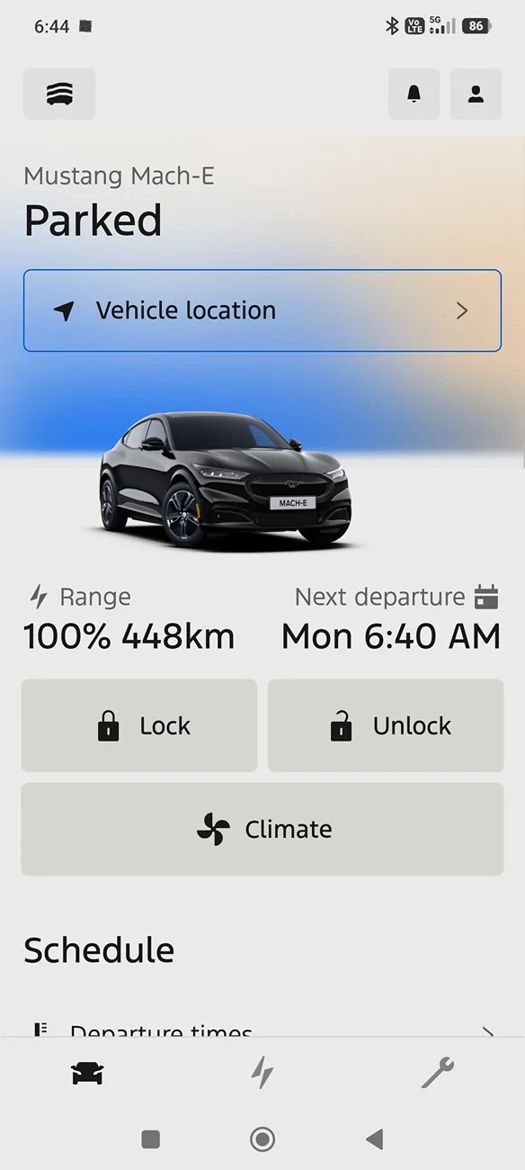

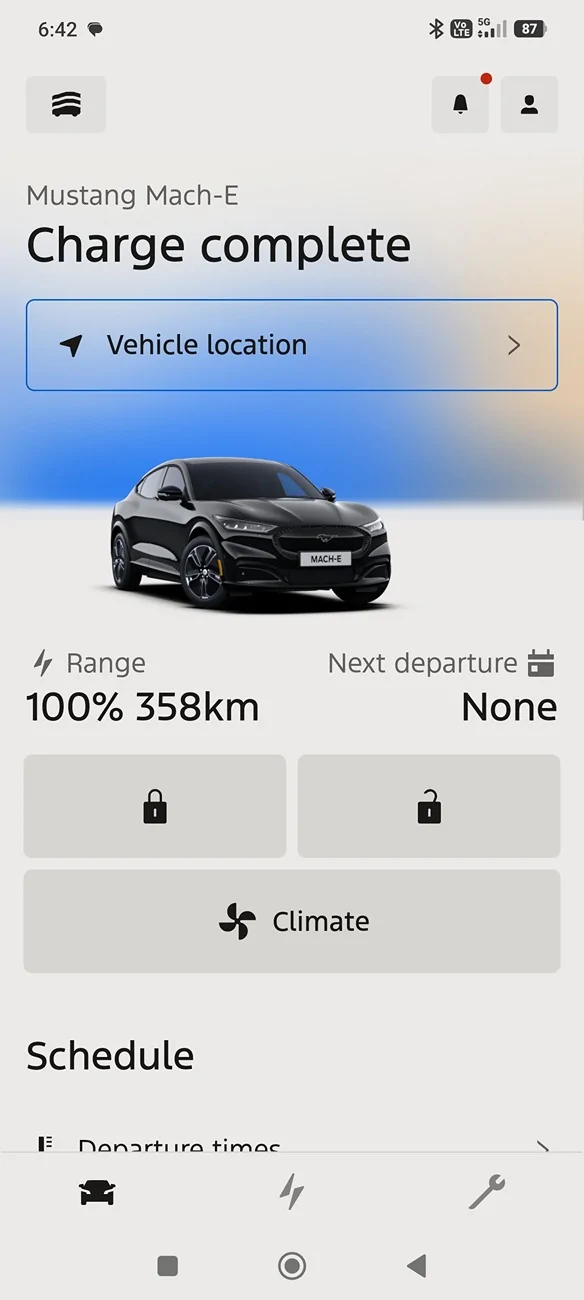

I don't think 27% loss of range is justified (from 470 to 340). And it happened overnight!
again, stop paying attention to the GOM. its a meaningless number constantly changing even as you drive.

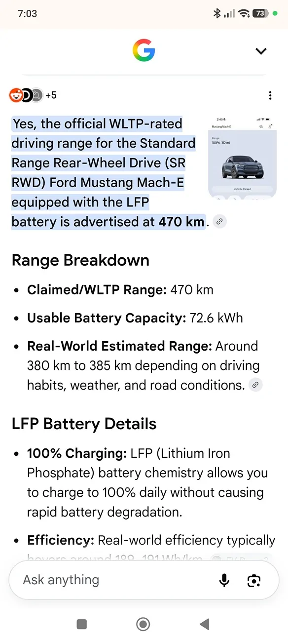

" 2024 Ford Mustang Mach-E Standard Range with the 72 kWh LFP (lithium iron phosphate) battery is 250 miles (approx. 402 km) for the Rear-Wheel Drive (RWD) model and 230 miles (approx. 370 km) for the All-Wheel Drive (AWD) model. "
you have RWD of AWD? brand new it was 370km. where did you get 470 from? the GOM? ....
you have a obd scanner. what is your cell voltage variation?

This is what it is advertised and i had a range of 440-450 up until 2 weeks ago. I will post some forscan and carscanner images later

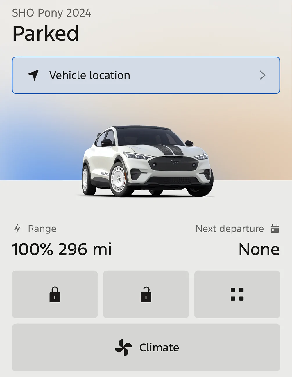

After my recent 100% monthly charging exercise, my GOM estimate is now up to 296 miles (476 km)!!! I only have 7k miles on my 24 MME, and I almost never use public L3 charging - I stick to my home Ford Pro charger v2 at 48A.
The specs on my model is 270 miles at 100%, and I haven't done much 70+ MPH driving lately.
thanks for showing off.
your 98kWh (91 usable) NMC battery shares nothing with what we are discussing in thread.

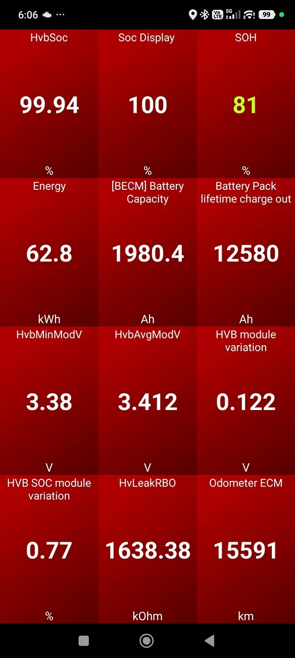

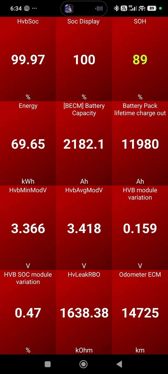

Car scanner images, before and after

Do the same screenshot after a drive. Around the 80% charge mark, I bet that variation drops to zero.
Look, if I were in your shoes I’d be very annoyed as well, I agree on paper that drop in health makes it look like something is off.
the problem though is that’s just not how batteries work. If there was a sudden change mechanically (or chemically?) there would be other symptoms. And the fact that this change is linked to ford doing a reset on the hv BMS further leans on a bad reading. That flat v curve of LFP makes it hard to know exactly how much energy is in there.
Your module variation is smaller than mine. (I have a lot more kilometers) and your at 3.4v which is the resting 100% charge v for lfp cells.
I’d also like to point out that at a full charge my GOM was showing me 344km or range with (apparently) 70.5kWH of stored energy which compared to your original number is way off as well.
To sum up, again I would also be freaking out to see that change. However you’re going to need to do more data logging to prove your point. Start at 100% and start logging the kilometers driven. Try and get the battery down to 5-10% over the next whatever days keeping track of both km’s driven and avg km’s/kwh. Come back with real world data that supports this low SoH and Ford will have to listen.

A lot going on here. The WLTP rating is the European standard (is it Canada’s too?), and it’s less realistic than EPA (U.S.). Whenever I see a WLTP range, I subtract 100 km off of it as a very, very rough conversion to EPA.
To further my point, EPA “highway range testing” is conducted between 48 and 60 mph (77.25 km/h to 96.5 km/hr). Weird, huh? Why not 70 or 75 mph? So, EPA is imperfect, too. ALL benchmark testing of any kind is imperfect.
** And WLTP range testing tends to be even less realistic. **
So, right there that tells us that measuring vehicle range is complicated and not necessarily super precise.
Your vehicle’s battery management system (bms) is often nicknamed the Guess O Meter (GOM). You can’t figure out “range loss” by comparing the GOM’s guesses. It doesn’t necessarily know how strong your headwind will be or how cold it will get on your drive. Or your 0-60 times. 😉 You *can* get a pretty good idea based on the vehicle efficiency in the Trips app.
I recommend reading some of the many posts talking about now it’s important to understand that the km range shown is just a guess. Yes, it can be frustratingly complicated and anxiety-inducing. Concentrate on the percentage.

If you look at his screenshots you’ll see the energy at 100% charge dropped from 69.65 to 62.8 kWh while SOH dropped from 89 to 81%. That’s a significant loss of total energy for a car that new should show 72kWh. So it’s much more than a GOM or EPA vs WLTP issue.

I was responding to the OP’s assumption that their standard range battery would do 470 km. The official standard-range Mach-E range looks to be around 402 km RWD or 370 km for AWD on WLTP. So, it’s possible that there’s something wrong with the vehicle, but the OP thinks the standard range battery will do better than official range. Sounds like a possible misunderstanding. Shouldn’t we sort out what appears to be unrealistic expectations before assuming hardware failure?
