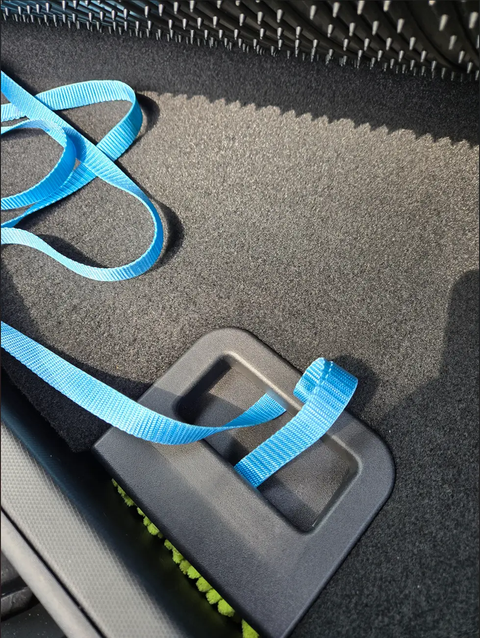

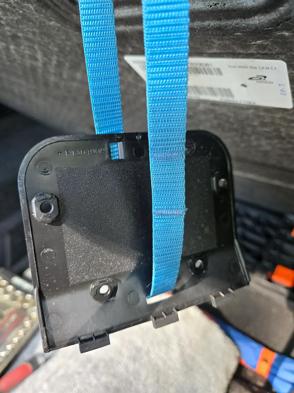

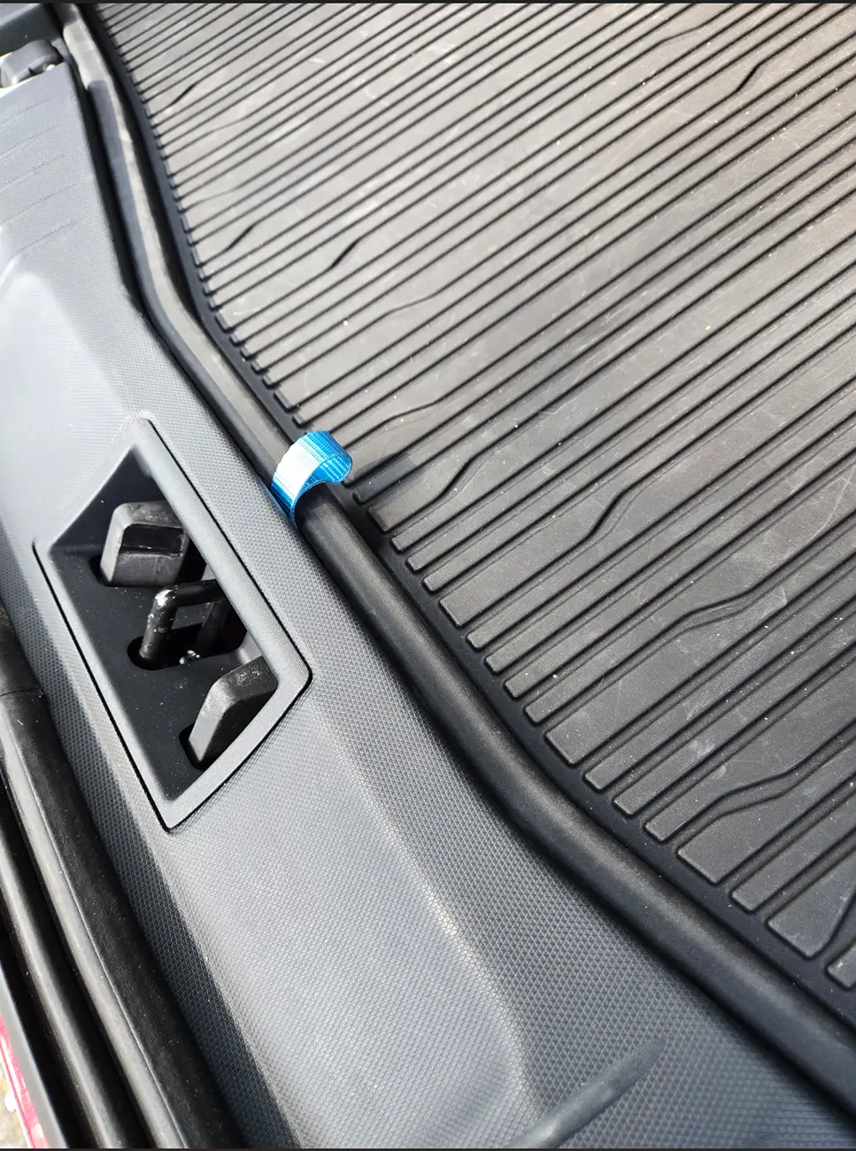

I didn't like having to lift the rubber mat to then grab the handle to lit the floor.
So I found a Mach-Easy solution. I took the handle off the floor - 4 Phillips head screws from the underneath.
The handle clam-shells at the rear edge.
I happened to have one of those slip on dog leashes from my vet, and it fit right through the slit in the handle. I didn't need to cut the rubber floor,
After checking for fit/length, I just screwed the handle back together.
NOTE, you dont want the loop long enough to interfere with the liftgate latch.
Right now I just have it friction fitted and left the entire length laying on the floor, it ain't going nowhere, and I have an easy way to lift the floor.
Those gripper spikes are a bit sharp...

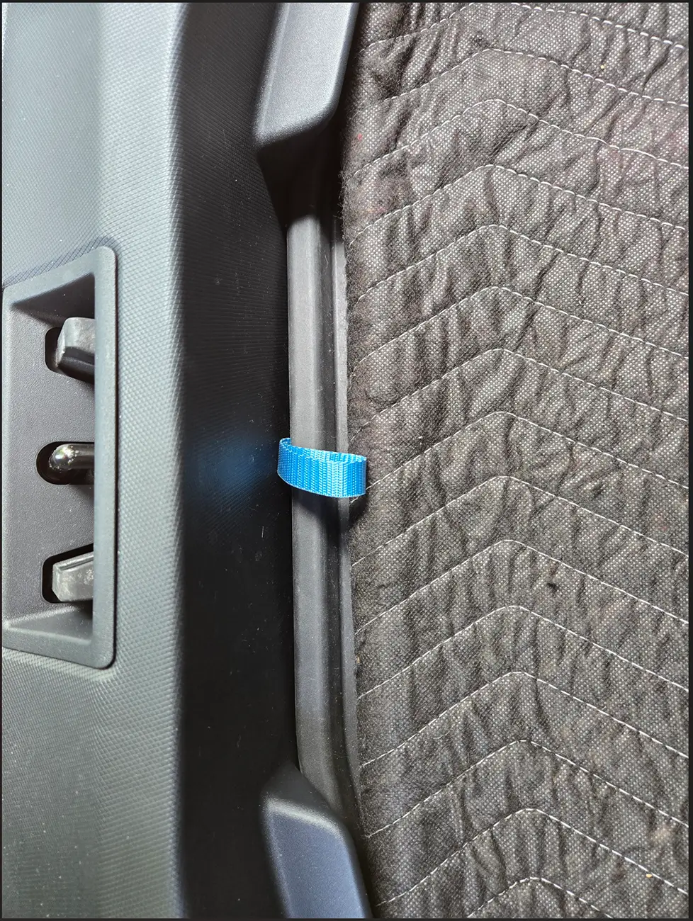

It wasn't really obvious to me as to how to lower the floor just by looking at it, but I gave it a shot.
I still like the usefulness of my pull strap... :D
Also, since I had it from my last 3 suvs (Escape, Explorer, and Cherokee), I set in a black harbor freight moving blanket, it's a perfect fit folded in half...
Edit, measured the blanket, it's 40"×72"...
