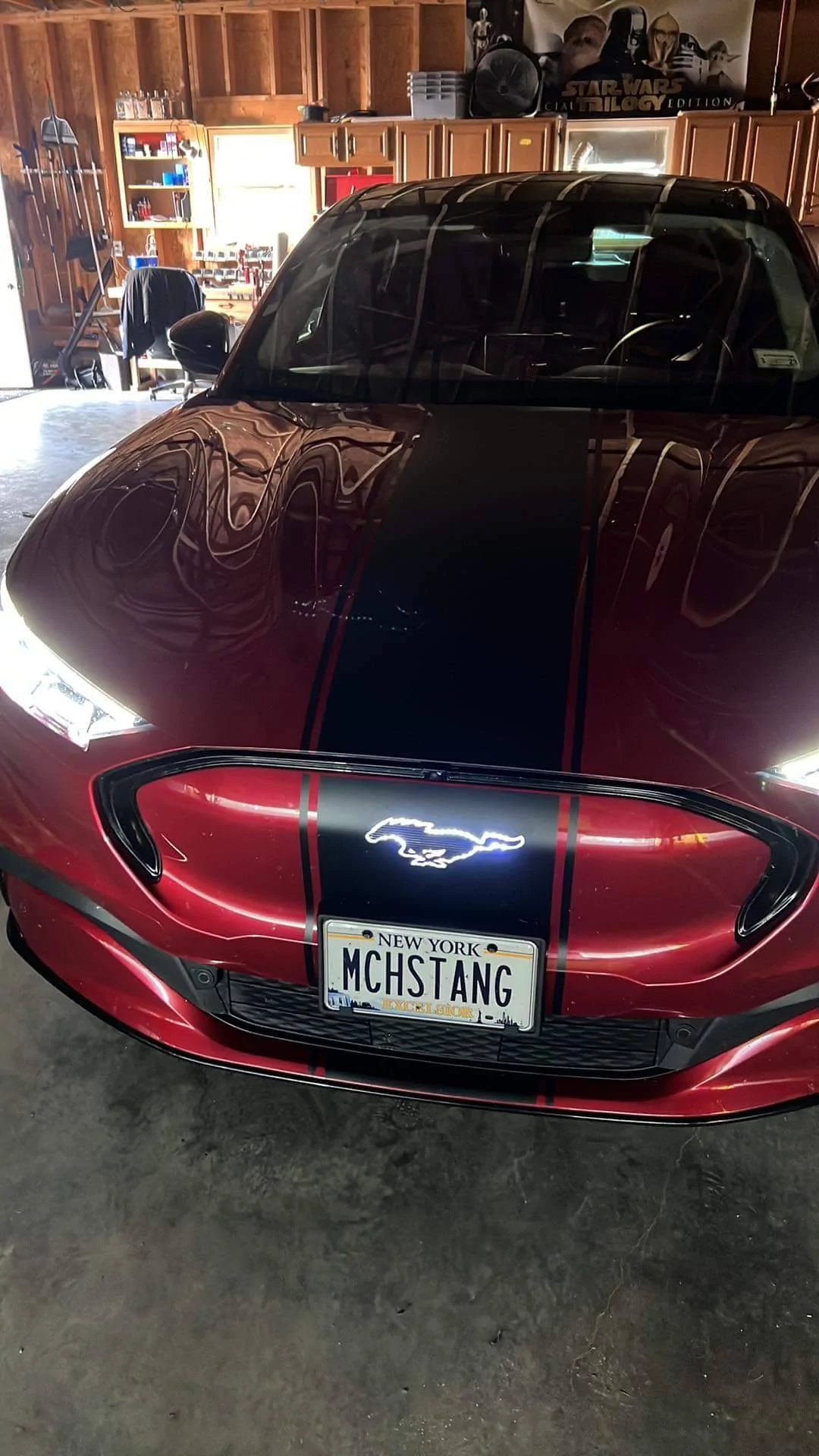

Ford Mustang Mach-E Lighted Pony Project (back it!) 5B6CDEE4-005A-4738-8011-8CE37103C654
Got mine installed this morning. Super simple install, but then I’ve had my assorted trunks in and out a ton. Also played with a lot of the wiring while doing my EL wire pony.

Looks amazing, can't wait till mine arrives

So I did my install and your Star lock washers weren’t as bad as I expected. Managed to get them on with my magnetic tool to position them and a long screwdriver to seat them. What a nice clean look. Way better than my EL wire.
