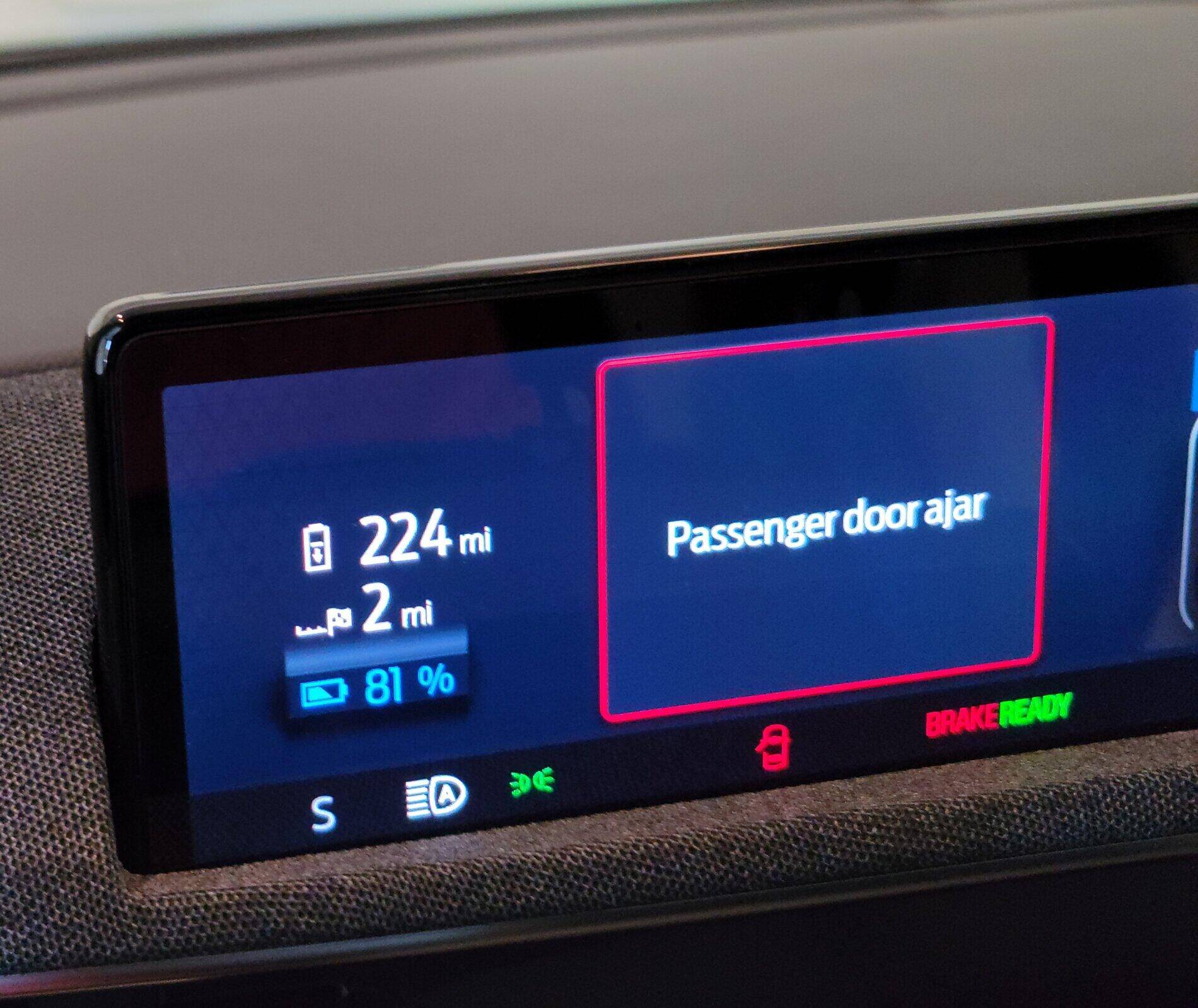

I have read through the manual. I am confused. I sometimes see the pictured little flag followed by a number of miles. Mine usually says 19.
Can someone share what this is? is it a warning setting for miles remaining? Because i have my warning range set at 30 Miles.
-Connected to this. I was getting some static on my main screen so I did the volume down forward arrow sync reset. That caused my "19 mi "flag
to go away.

It's your distance to your destination. If you set a route in the nav it shows up. I've heard of a bug that shows without a destination but I can't remember how to clear it.

Hi, and welcome to the forum. There are a lot of threads here about this; basically your nav system thinks it's still working its way to a destination. Put in some random navigation point, start navigating, and then cancel it, and you should be okay.

yeah this one drove me nuts when I had an overnite demo, couldn't figure out how to clear it at the time
