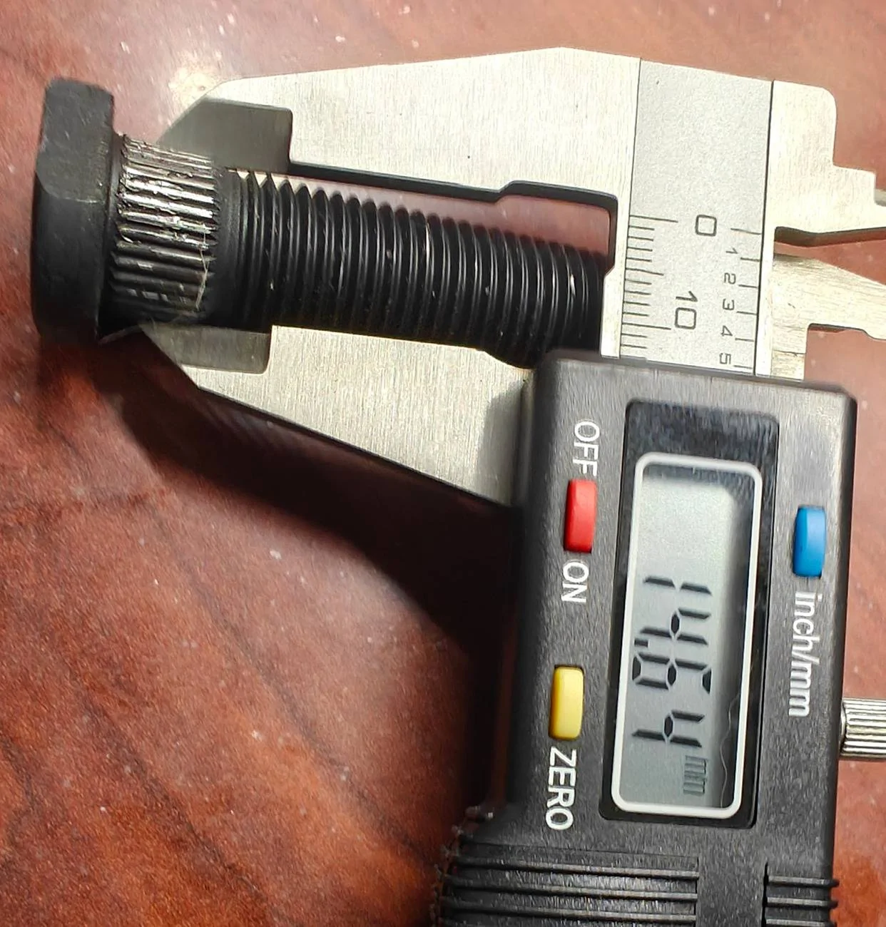

Once I had the hub I could remove a lug and measure the

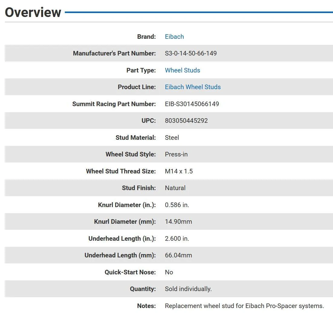

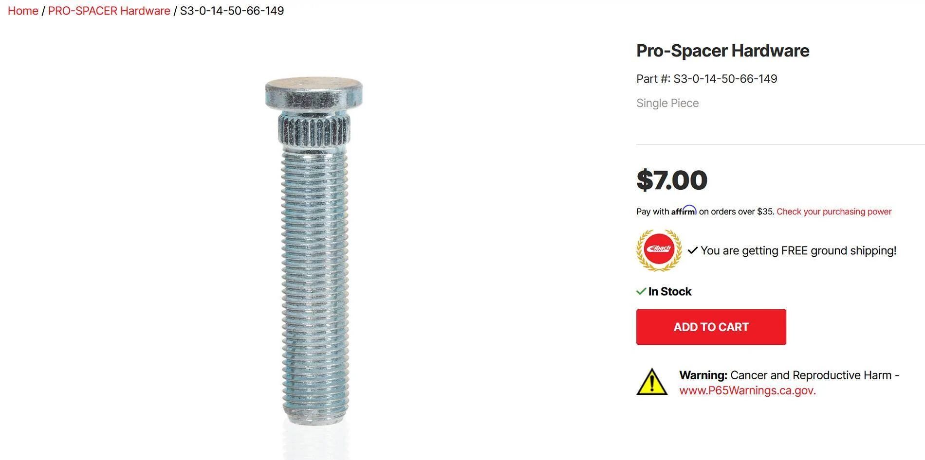

After that searched to find something close here is what I found. This one is about 15mm longer so it would work perfectly with a 15mm spacer. Part #: S3-0-14-50-66-149 I recommend you get them from Eibach.com they offer free shipping.
https://eibach.com/product/S3-0-14-50-66-149

So it arrived today and I tested fit it in the hub, and it will work.

Funny. When I tried these, they did not fit quite right. I compared the knurl diameter to the stock ones and it was just a tad off on mine. I could not use them with the spacers as they were just a tad loose. However, your OEMs are measuring smaller.

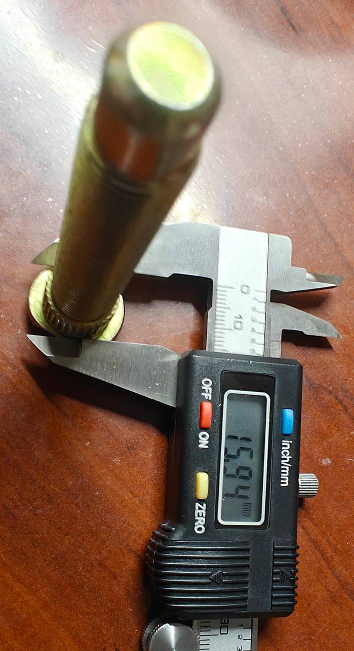

Could it be the aftermarket hub uses a non-factory size stud ? UGG, I will go pull a factory lug if 0.62 /15.8mm is the OEM MME an ICE Mustang / F150 stud would fit
It will take me some time to get one of the factory ones out (it's winter here) but if they are .62 then these will work and that's better because they are cheaper.

The Eibach one is the correct size for the aftermarket hub. Thanks for letting me know the factory hub may be different. I will verify the size of the ones installed on the car before I buy a whole set. Hopefully, they are like yours .062 because I can get a set for much cheaper.
