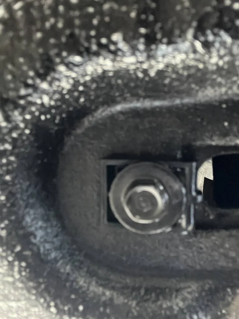

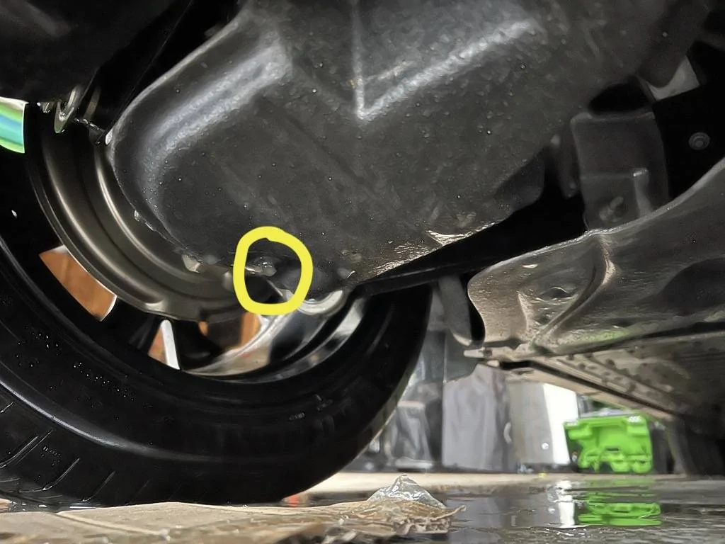

I've lost a bolt of some type and possible the nut/housing it would screw into. I checked with the local dealer and they are guessing at the part due to their schematics and don't have it in stock anyway. The picture below is the bolt i'm missing on the right rear underside and it seems to be a protective cover of some sort that the bolt is holding on. It is held by 3 bolts and I'm missing the one picture. Any assistance would be greatly appreciated!!
I have some of those (both bolt and retainer) however I am out of town until Monday. I'll give you the part numbers when I get back or I can send you some if you want.

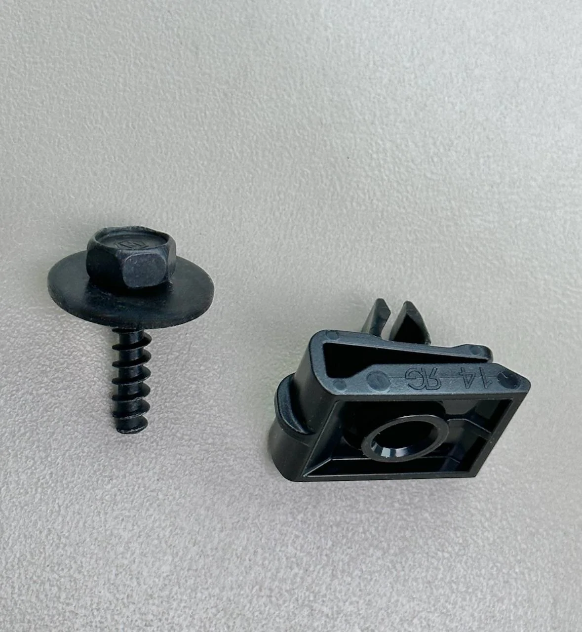

Thought I would post the part numbers of the screw and nut/retainer that Searcol was inquiring about in case others needed these parts. This nut/retainer is used on the air deflector below the rear trailing arms and also the front fender inner liners. The screw is used for all the covers under the car, front and rear.
W720874-S300 nut/retainer
W717586-S450B screw
