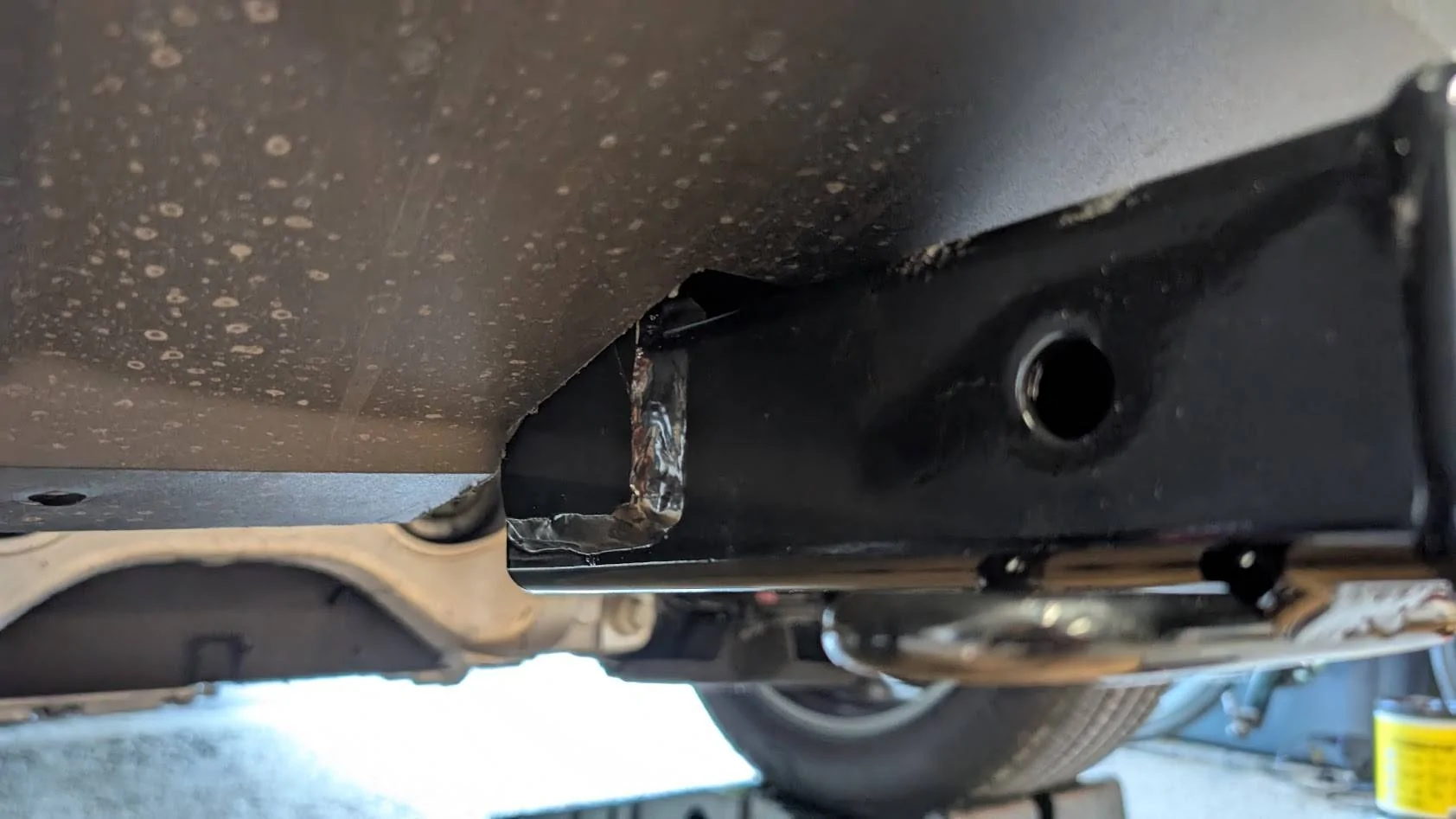

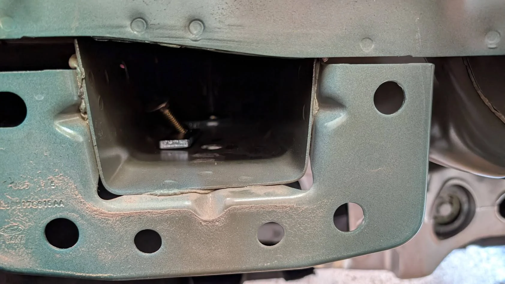

So I ended up doing the "right" thing. I did a 90% removal of the rear bumper. There is a beefy harness connection on the driver side I left free. I just dropped the bumper shell onto a foot stool.
Youtube Video for Bumper Shell removal
Here is the mess
Ford Mustang Mach-E Lost Hitch Bolt/Washer Inside Frame NoBumperEdited
Frame bolt loose in the channel
Ford Mustang Mach-E Lost Hitch Bolt/Washer Inside Frame FrameBolt

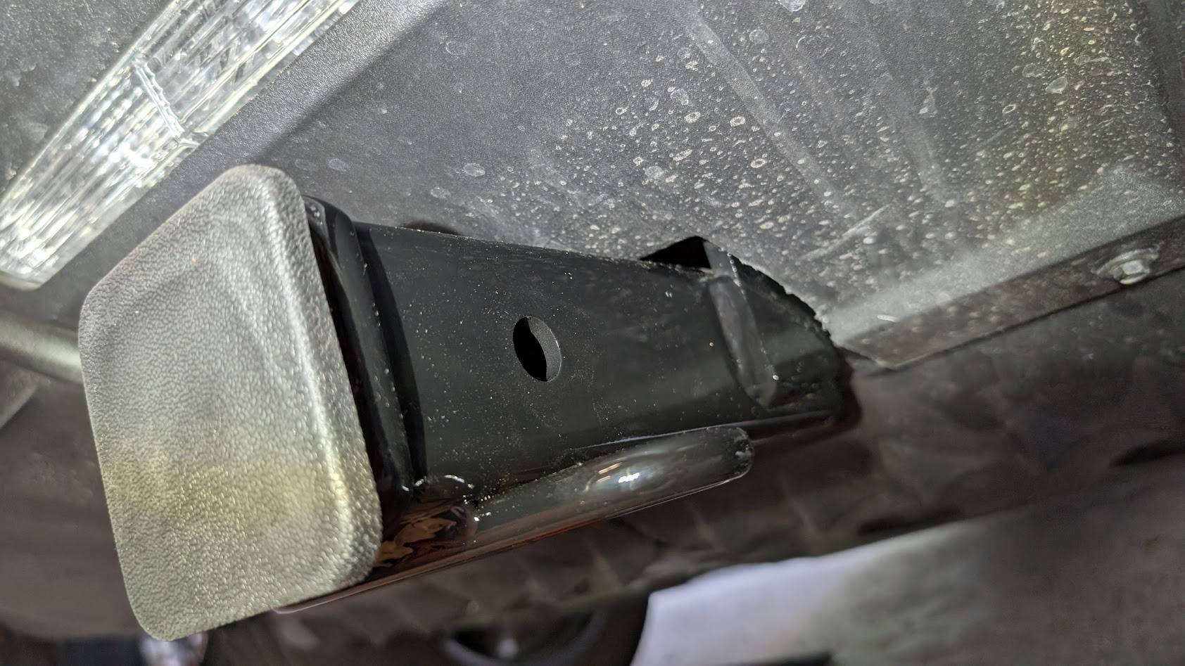

Final Results (Curt Trailer Hitch Receiver - Custom Fit - Class III - 2")
Ford Mustang Mach-E Lost Hitch Bolt/Washer Inside Frame CurtCut1
Ford Mustang Mach-E Lost Hitch Bolt/Washer Inside Frame CurtCut2
Ford Mustang Mach-E Lost Hitch Bolt/Washer Inside Frame Hangin
So I learned a lot. Not something I wanted to learn. Keep the fish wires on your hitch bolts until all 4 are aligned and you're about to finger tighten a bolt on. This is my 4th hitch install, and the first time I removed the fish wires early to "make it easier". The bumper shell removal wasn't as terrible as I was expecting. But you had to be careful to not scratch the paint or tug on any of the sensor/lighting wires.
