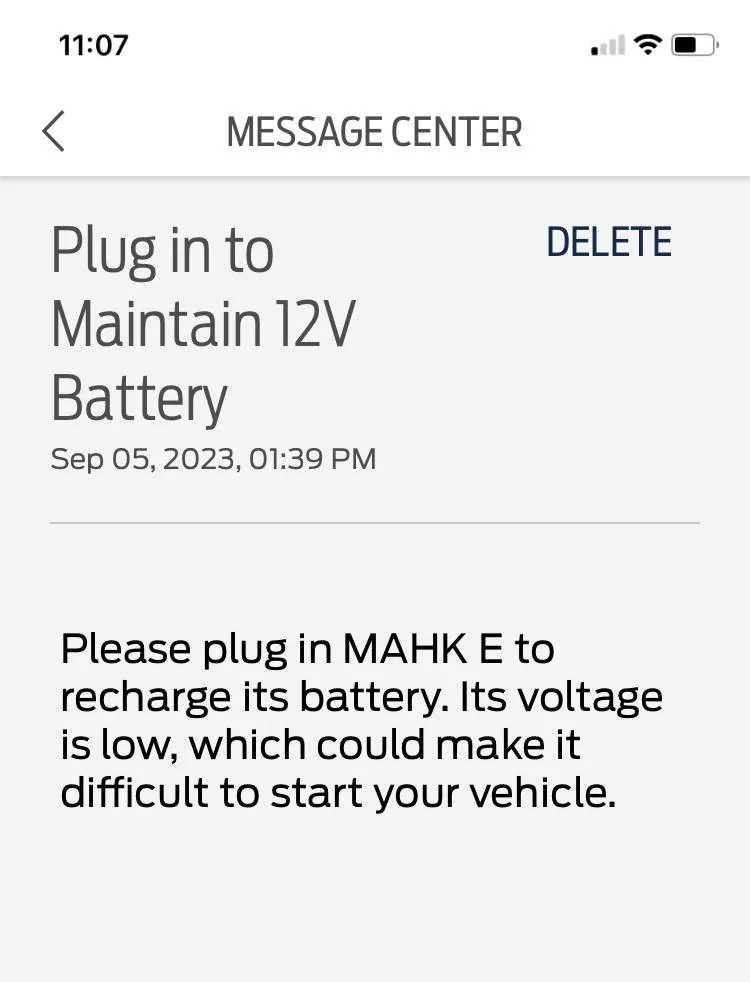

I am so tired of getting that same message, and there’s no consistency to when it appears. I drove my car all day today and this same message just appeared on my Ford Pass. This is very disconcerting and it’s the only problem I’ve ever had with my 2021 MME Premium.

FYI the 12V won't recharge until it gets down to 40-50% SoC, which is about 12.1V. You'll get a message when that happens. Based on your 12.34V reading the battery is at about 52% SoC currently. So you probably have another day or two before it gets down to 12.1V and recharges.
So what other troubleshooting steps have you taken to find the source of your drain? You haven't said much about that. Again, suggestions:
  • Remove any hardwired dashcams, radar detectors, or tracking devices
  • Remove anything plugged into the OBDII port under the dash
  • Disable welcome lighting and store your key fobs >25' from the car
  • Force quit the FordPass app on your phone or disable Bluetooth permissions for it
  • Change your FordPass password to block 3rd party app access
