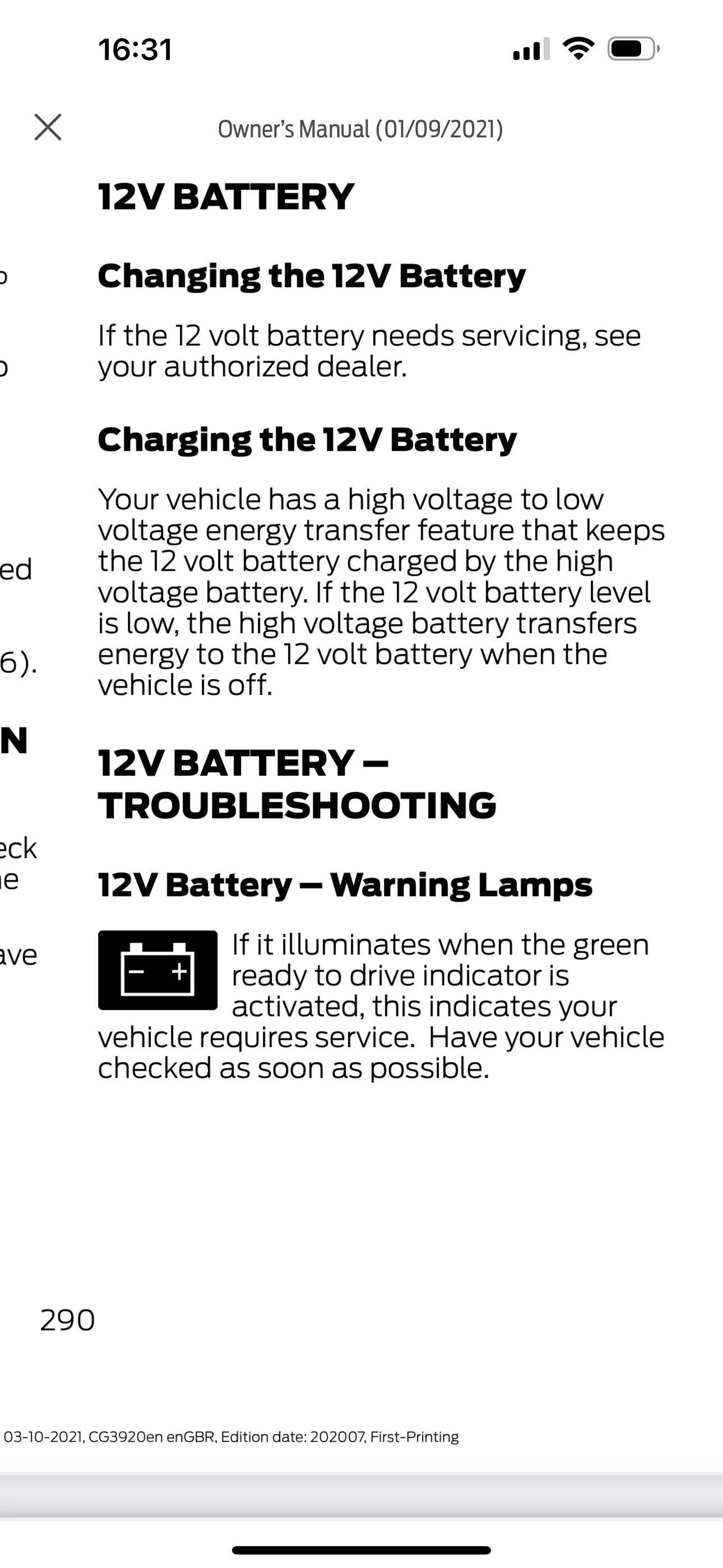

Correction to my earlier, I ignored the age-old maxim - RFM - read the frigging manual?‍♂

How did you attach your charger? Small port or took off shroud?
Sorry, don’t follow what you’re asking, I may just be being a bit thick.
It's a misunderstanding on Auto Motive's part - he's asking how you charged the 12V battery directly (connecting clamps directly to the battery). The document you posted doesn't discuss that, but reinforces what is being said in this thread - that the traction battery (high-voltage battery) charges the 12V battery, and Ford does not expect (or want) us to charge the 12V battery directly, ourselves.
Ah, thnx. If my 12v needed charging from external charger it’d have a new one after charge rate of DC to DC converter had been checked.
I think @Auto Motive is simply asking about how to connect an external charger to the battery.
Some of us have installed ports in the left beauty cover (shroud) to access the battery directly. There are threads on where to order the ports and how to install them -- even a paper template to use.
If you haven't installed ports, then you have to remove the left beauty cover.
