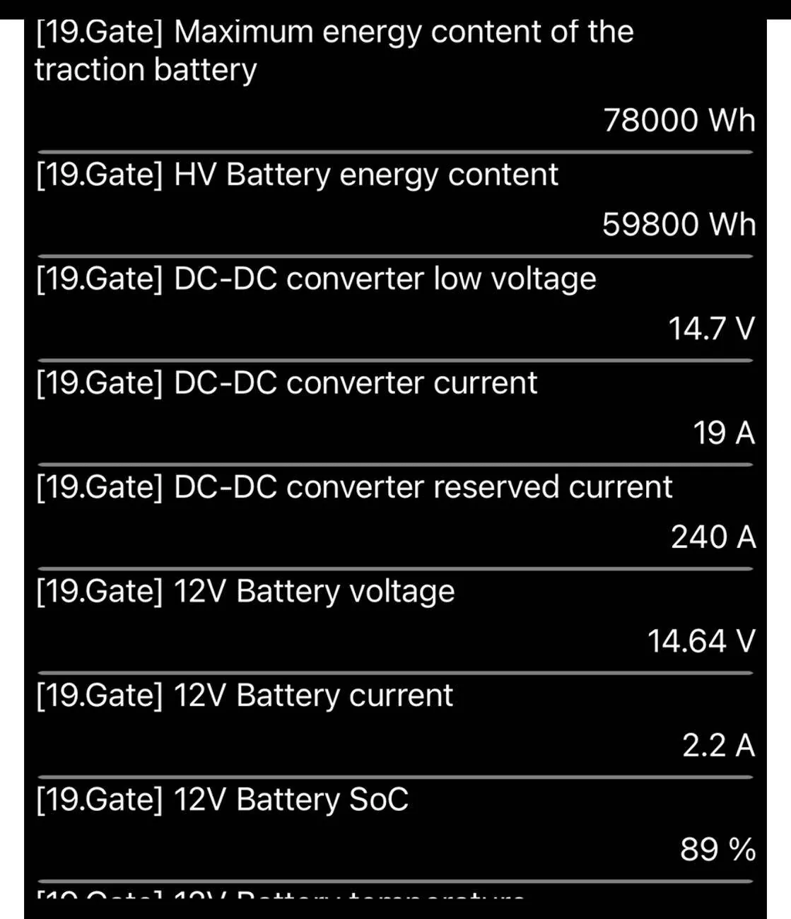

Car Scanner shows 12v voltage just fine.

Yes, Ford.com no longer shows it. Car Scanner shows it just fine.

I’m sorry if you can show me the title of it unless it’s something different. I would think it would say state of health low level or EV battery. I’m not seeing any of that all I think I’m seeing is for the big battery and it just shows the voltage of the 12 V battery, but I don’t see the percent remaining.

Someone on the Volkswagen forum was asking about the same thing and they were showing a screenshot This in the Car Scanner app? I’m not finding any of this gate stuff

the SOH% is for the HV battery only, and only visible via ODB2 with an App like CarScanner.
The Fordpass webpage was displaying SOC% of the 12v battery for a while, but that was "fixed" to show SOC% for the HV battery.
SOC% for the 12v is largely irrelevant, and will swing considerably in normal use between 12.4 and 14v. It is important to drive around long enough, or leave your MME "on" overnight, every month or two at a minimum to give the 12v time to charge up to 95+% to desulfate, and have charge on board for long OTA updates.

This is actually the one I have, and like I said, before I actually paid to unlock the full version because at first it was giving me the percentage and other things, then seems like when I paid for it and there was an update that was gone, and I thought I’ve seen others say the same thing but if somebody can show me But this works with Car Scanner?
I have the iOS version of this one though

So The one area I was talking about earlier if you’re charging the car overnight and just leave it plugged in does it do anything to the low level 12 V battery? Well yesterday I put the charger on it and it never charged up, but Just now after leaving The level two charger plugged in since yesterday evening I go out there to 12 V batteries completely charged according to the tester I put on it. So I also put the battery maintainer on there and it already said the battery was charged so I’m thinking when you do plug-in the level two charger. It does charge the 12 V battery and if that was set on here, I missed it sorry.

The 12v battery charges WHILE the car is charging. When the car is done charging, the 12v battery stops charging.

the 12v battery only gets charged WHILE the HV battery is actively charging, or the vehicle is "on".
