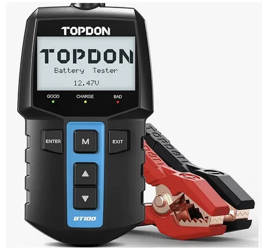

data based decision:
battery testers have come a long way ... the old load test style dont take into consideration a lot of factors. This new tech works great. Lets you pick AGM as style, the CCA of the battery, etc.
this will tell you your battery's state of charge and health, 2 different things. battery can be discharged, but still very healthy, eg.
I have the one in the pic ... ~$50 amazon at the time. Done over 30 batteries.
Huge truck style, boats, rv, motorcycles, AGM and lead acid, even 6v golf cart batteries.
Its been dead on every time.
most accurate when run on a disconnected battery ... just one terminal off is OK.

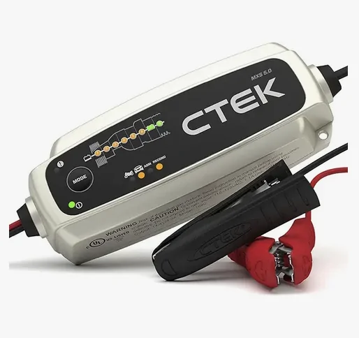

And .... topping off your 12v battery
battery tender, charger, recovery tool
Ive used this as a seasonal tender on my motorcycles. battery charger, and have recovered batteries the analyzer above said only had 40% life left.
supports AGM and lead acid
recondition mode overnight - can do it twice, leave for a day ....
can add life to an unhealthy battery or give you time to budget for a new one.
AGMs are $$$
can run a recovery on a good battery to keep it fit once a year eg.

load test - we're thinking the same thing .... but the new tech doesn't load test in the traditional way.
its actually measuring the battery's internal resistance, but you need to 'calibrate' it to the chemistry used, and capacity.
more a battery analyzer. load tester is antique tech these days.
Shops now have access to very expensive analyzers that work on the same principle.
The amazon offerings are like a cheap radioshack multimeter as opposed to the shops kilobuck 5 digit bench meter .... but who cares if all you want is continuity as opposed to ohms , or volts to 3 decimals. The inexpensive model will do just fine.

I did buy a cheap ($35) battery tester on amazon. not concerned with cranking amps, but I did get one where you can enter the type (AGM), and CCA (35). My 40 month old 12v AGM shows "100% SOH - great condition".
The only maintenance I do is leave the car 'on' for a day or two every 10,000 miles to desulfate since I mostly drive 20-30 miles a day.
so.... either our batteries can last a LOOOOOng time, or the tester is not very accurate.

Again, those testers measure conductance or CCAs, and the SoH value is calculated based on cranking amps, not capacity. So you can have a battery test 100% SoH on the CCA scale and still have a low capacity.
The only way to test capacity is to perform a discharge test (e.g. how long does the battery run a light bulb before dying).
they measure internal resistance, which when 'calibrated so to speak' with the parameters of volt, chemistry, and CCA come up with a % health,
They cant measure CCA as they just dont... that would be an old style load tester.
without spending $ on a tester, I agree with you about using an old headlight on a charged battery to see how long it lasts. Measure the current the load draws and compare it to the amp-hour rating of the battery.
more the point is, there are tools to give you a benchmark, ve working in the dark.
Always analyzer tested the new batteries Ive replaced as a sanity check. Never had one less than 100% on a new one. I dont feel they are gimmicky at all, but only feel that way now Ive had years of experience with one.
