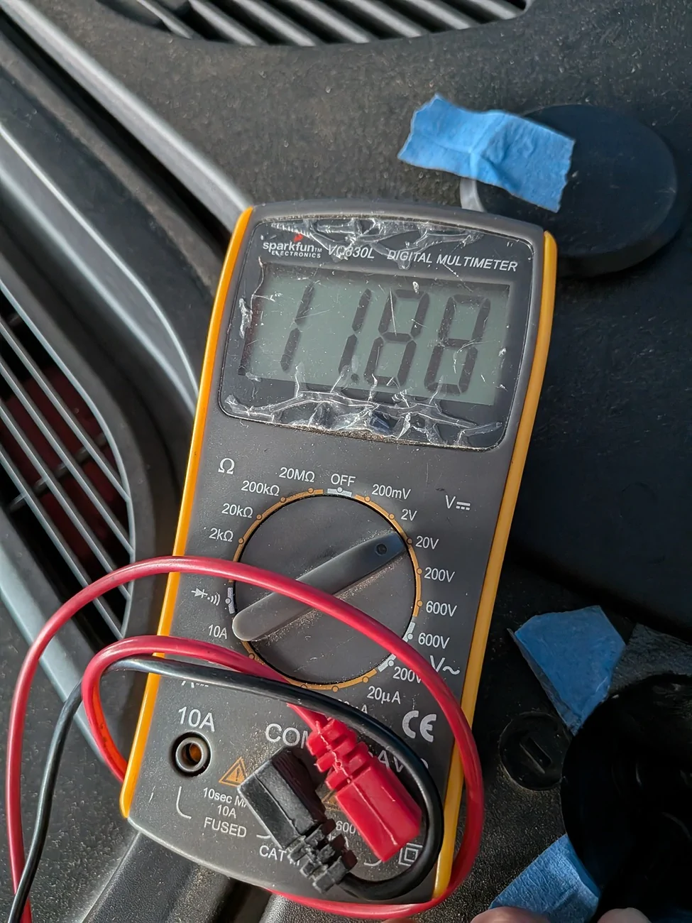

I have a 2022 GTPE and im on stock battery still. I was curious about the 3 year timeline so I got an ODB2 scanner with car scanner app to read the 12V battery SOC. Just installed it yesterday and this is what I saw, 63% soc.
I then took a multimeter to the batter (after letting it rest overnight) and this is what I read.
I don't know when the battery warning is going to go off but I'll keep monitoring it. I have a spare battery just in case I need it.
Remember if you are checking battery voltage, you have to open the hood and walk away for 30+ minutes to let the car go back to sleep. If you walk up with your phone or key fob in your pocket it will wake up the car and cause the voltage reading to be low since the car is using 12V power.
Ahhh, I didn't know that! So if I walk up to my car, unlock my car via keypad, I have to let it sleep in 30+ minutes? Even if the phone was never on me?
What I did was walk to my car (without phone), unlock frunk and measured the voltage. I was missing the "let it sleep" step
12,994
17,499
Using the keypad wakes the car so that the car can unlock the doors. So, after that you need to let the car sleep again after the frunk is open. 😁🐩

Got it! Haha. Either way, the OBD2 mentions that I have 63% soc left so I'm still OK for now
You were at 63% then. It could be 90% now...
