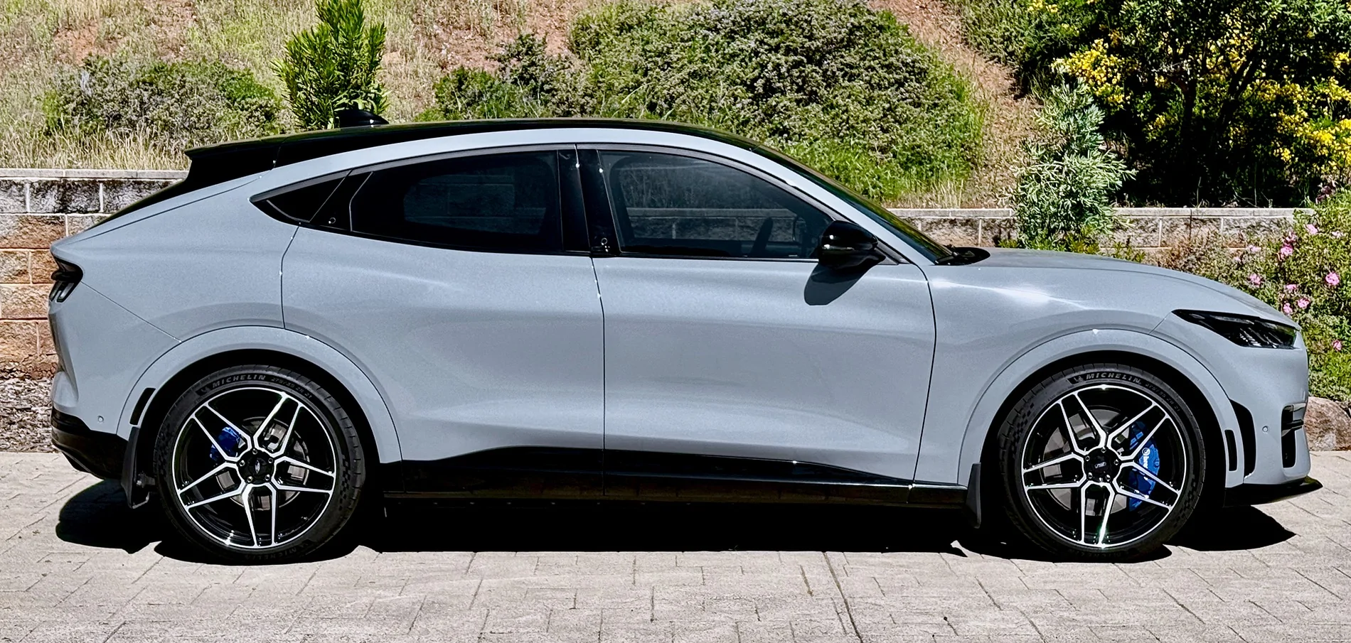

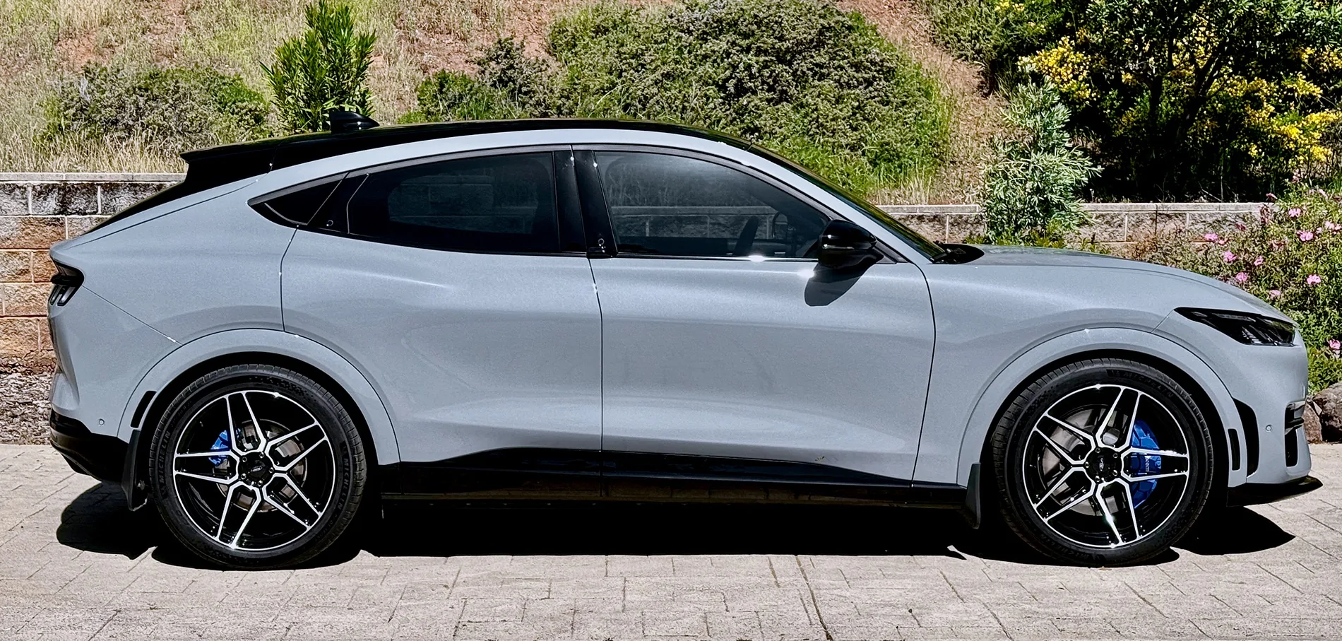

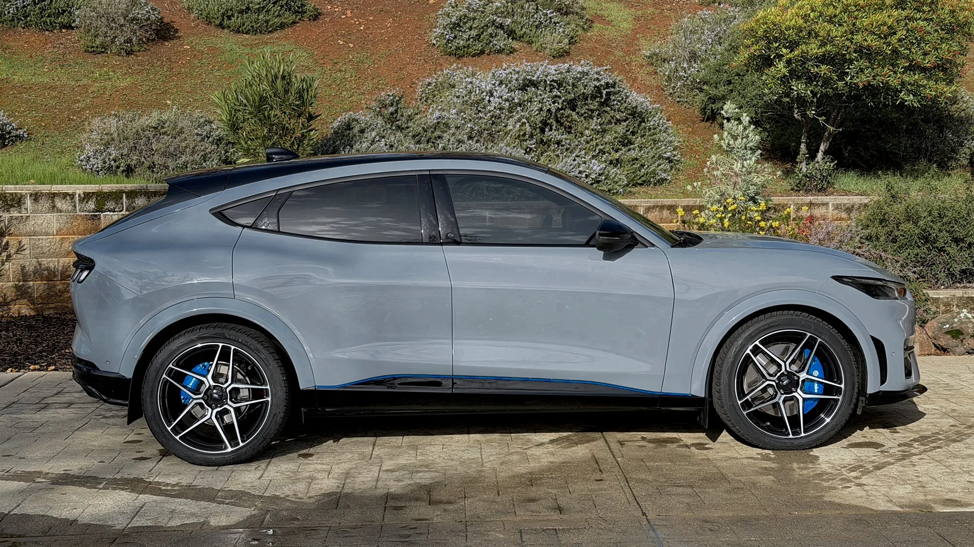

I have lots of photos of my cars with all different setups. Here are a few:
'24 GTP, OEM height with OEM diameter tires (28.7") 275/35R21
'21 GTP OEM height with 1" taller tires (29.7") 275/40R21
'24 GTP with Rally springs (1/5" higher than OEM) with 1" taller tires (29.7") 275/40R21 ( my winter tires in this photo)
