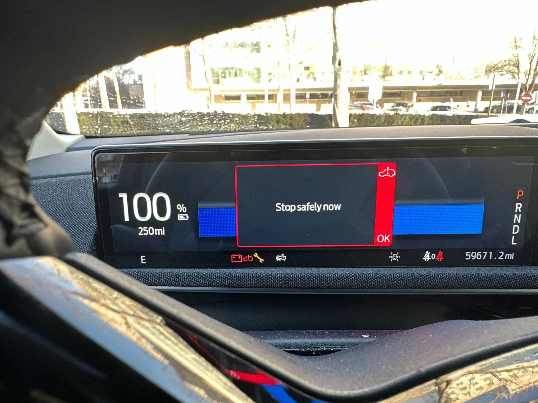

As I posted in my update, after taking it off the tow truck we ere able to get READY status and drive it but still with many messages and DTC lights on. Didn't have a scantool to check the messages like you.

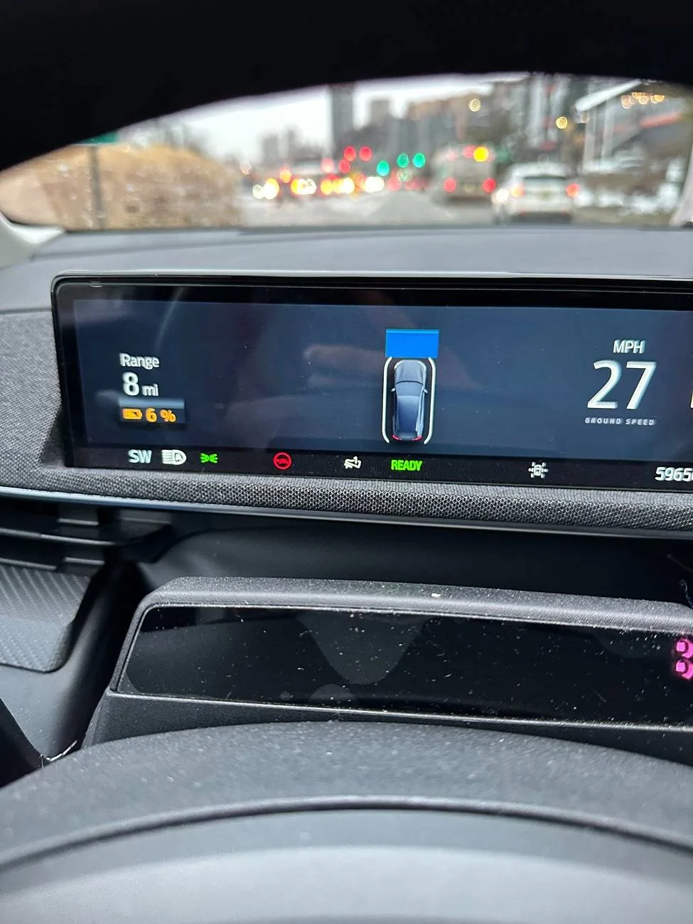

Mine showed the yellow wrench and "Service Vehicle Soon" message. Sorry for the blurry images it was cold when taking this video which is too large to attach.

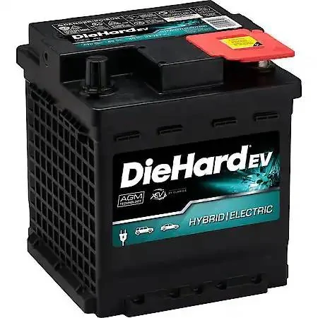

Going through the same scenario with slightly different symptoms. AAA boosted dead 12 V battery (after popping frunk, etc.) and I thought the car was fine. Drove it home and left "on" since the 12 V gets charge from the HV. 15 minutes later car was totally off again. Tried trickle charge with battery connected to car and with battery isolated: with battery connected charged stopped after 5 seconds; with battery isolated would not take charge. Trickle charger will let car turn on so plan to put car in neutral to be towed to dealer. Likewise will update with results (even though there are a bazillion other 12V battery threads.)
Had vehicle towed to dealer. Battery replaced: "sulfurization noted and smelled". I asked "why didn't a get a warning when the car just turned off and would not turn back on?" The answer was an obscure "sudden catastrophic battery failure".
Correct, sudden battery failure can happen with no warning. Sounds like a cell had an open or short and the battery boiled from the car trying to keep it alive.
