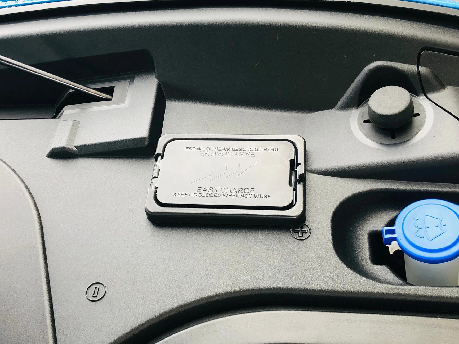

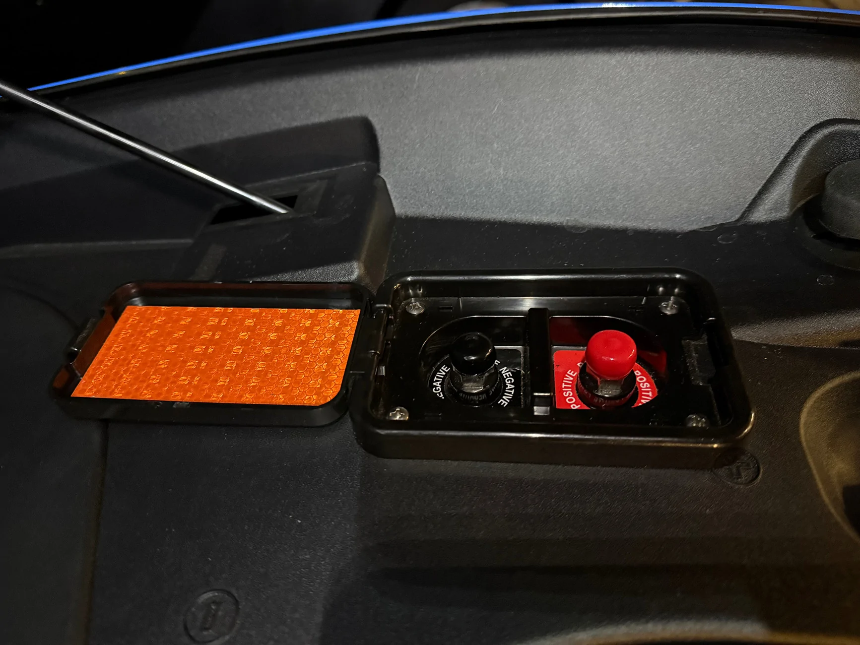

Also, many drilled out holes for easy access to the 12v jumper points (and the HV disconnect) under the hood: https://www.macheforum.com/site/thr...n-points-hv-disconnect-relay-for-safety.4107/
Some of us went a step further than drilling holes and placed a race car jump point in the car: https://www.macheforum.com/site/threads/frunk-tub-removed-pics.12094/post-882324 😁🐩
