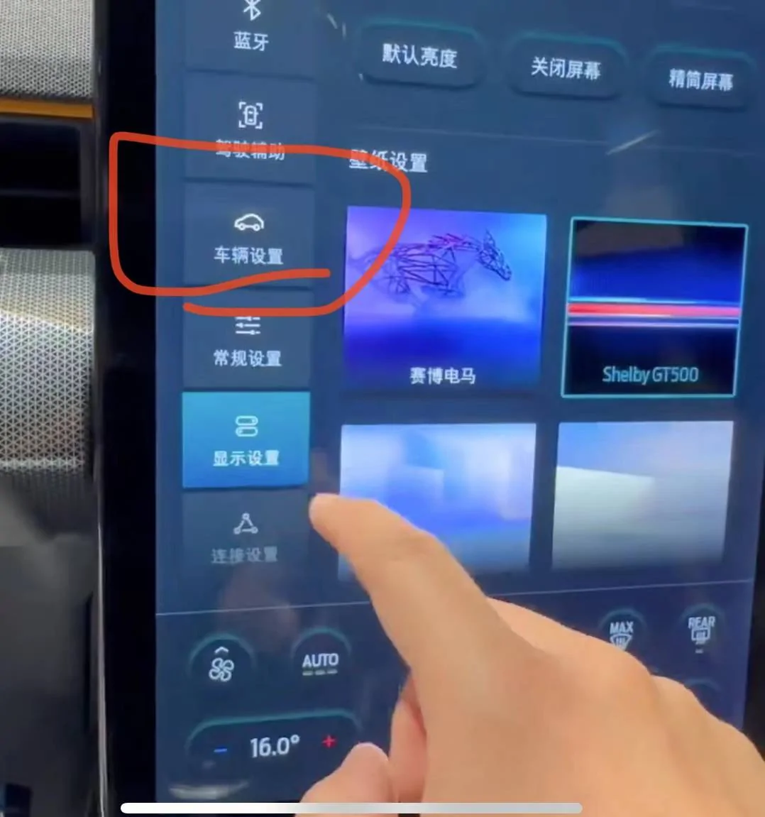

@amer gayauer, how are you charging the vehicle? Did they give you an adapter to the Chinese plug standard? (It's a different shape.)
OP‘s Mach E might bought from a private importer in Dubai.
Ford Mach E CN wholesale a lot of Mach E to some export firms after they stop their production in China. These firms usually reinstall the whole system computer to the US version or other countries' versions before they export them to the destination country. They might have missed the one OP had bought, I believe the company that OP bought the Mach E might be able to help on this and get a regular Mach E system that is compatible with Google Maps and stuff. (The Chinese version has its own Map system and entertainment system, and I don't think Dubai could use those)
At the moment, let's see if we are able to switch the current system language to English, I don't have a Mach E nearby at the moment.
I couldn't find the Language setting on the Chinese Owner Manual. Could you try to see if you are able to find "语言" (Language) on this page?

Hi All, i bought a mach e that turned out to be Chinese import with Chinese only infotainment system. Anyone knows if its possible to over-ride it and reinstall the English Version? I believe its sync 4 that's installed on it
Pm me, I can convert it for you

I have already changed languages on Chinese cars. You can't do this with any coding. You need to physically change Sync as well as the unit and new wiring. This is quite expensive. We charge $1,500 for this work.
