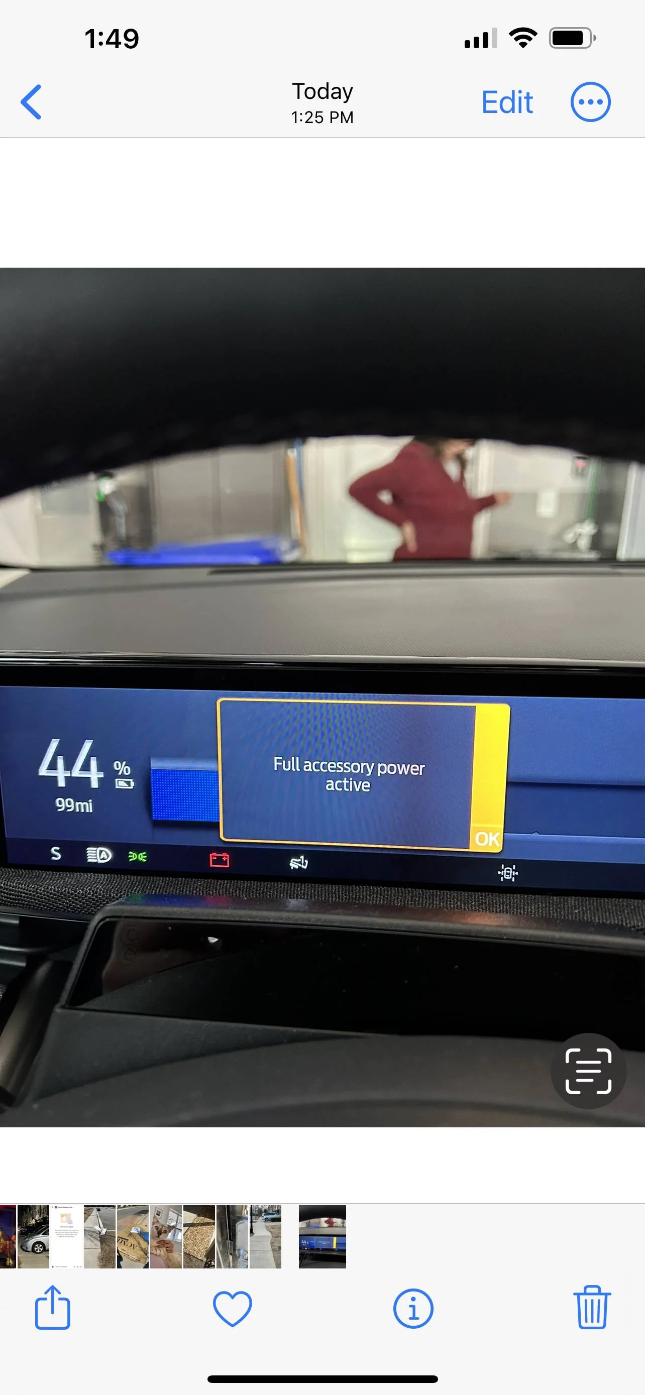

I am a new owner of a 23 Premium MME that I have been driving since 12/27/22. We have about 4,500 miles on it already, and there are a few quarks that I am hoping others may have seen and can help me troubleshoot. Overall, I am loving this vehicle, though.
First, both my wife and I use our iPhones as a key. I am 9 inches taller than her, and the seat memory settings are therefore quite different! The car cannot seem to figure out who is driving, and it almost randomly selects the seat memory on its own. I therefore am often scrunched up when I turn the car on if she is also in it. Even if I set the seat before turning it on, it will still just to my wife's setting, and I have to change it back again before driving.
Next, sometimes when I turn the car on and start driving, the Ford navigation kicks in on its own and begins to route me to places such as home or a recent location. When I use navigation, it is exclusive through CarPlay, so I have no idea why it does this! I am forced to shut it off.
Today when my wifed turned on the car, a message came on (see attachment) indicating that full accessory power was active, and it would not let her shift it out of park. I shut the car off for a few minutes and then tried again. It was fine.
Finally, does Ford have a place to enter enhancement requests or get answers (e.g. a support line) for these weird items that happen? My biggest annoyance is that you have to dig into the screen to get to the rear liftgate open from within the car. I don't for the life of me understand where there is not a physical switch or that the button is not located on the home screen. I would love to request this as an enhancement. I'm sure I am not alone on this one!
If anyone can provide some context around any of these issues, it would be welcomed as I continue to get my legs on using this car.
