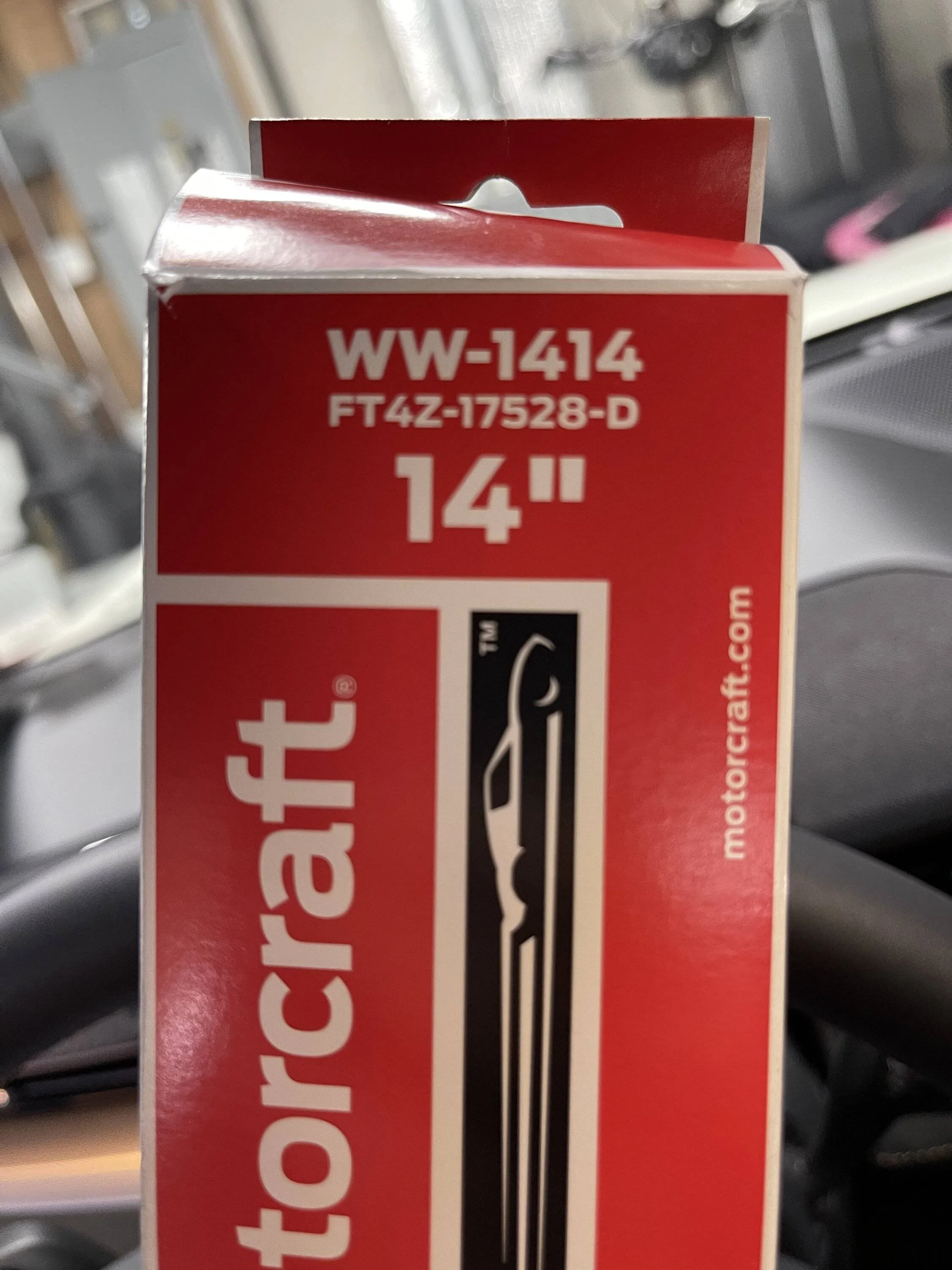

Pull the wiper blade firmly to the right side of the car. you will hear a click. Then lift the arm off slightly to drop the blade.
have cardboard ready to protect the rear window.
looking at a new replacement blade makes this obvious. The blade from the Ford edge should come from the MachE factory.

Got the 15" Trico from Amazon today. Pretty easy!

After 2 years, I am finally replacing my rear wiper! I used the Bosch A401H. The old one comes off by pulling to the right to break it free, the Bosch just pops straight on. Need to remember that when replacing it again in two years.
