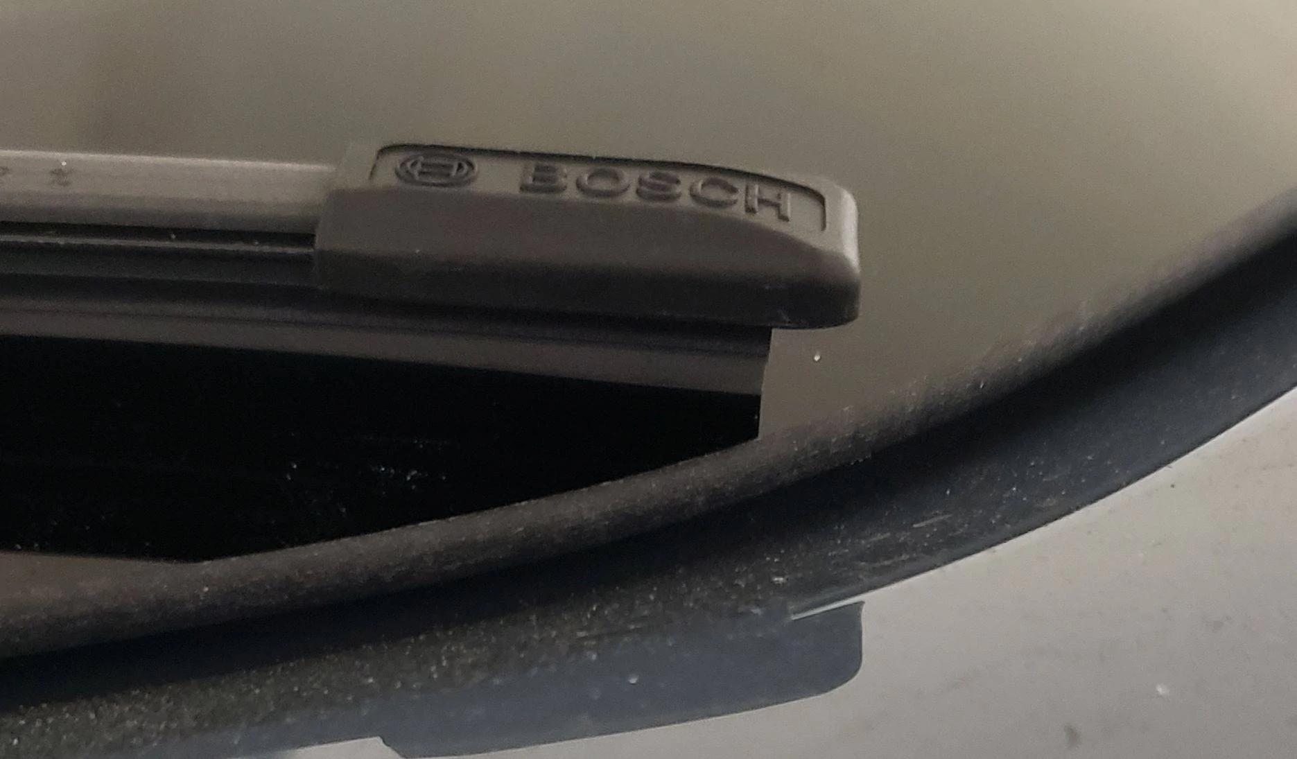

I got the Bosch R1521 from O’Reilly Auto Parts and it’s great. I had to ask at the counter as it was in the back and not out in the main wiper display.
I found the Bosch A401H 16" (400mm) blade at a local O'Reilly's. It comes almost to the edge of the rear glass:

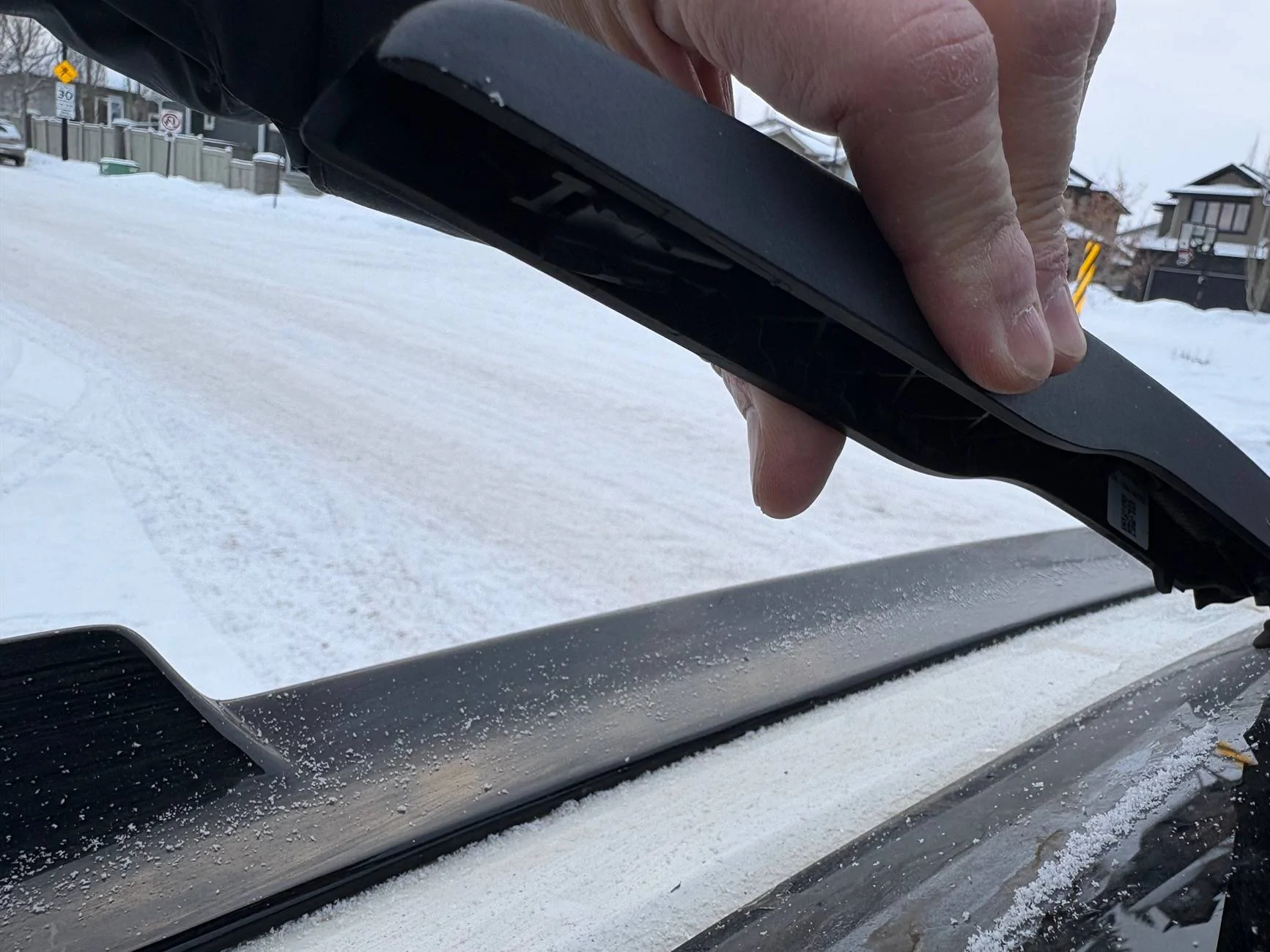

Haha! How do you get the darn thing off? I pried too hard and did this!!

Haha, the OEM one was a slide and then release like the video above (or use a heavy pry bar to snap the connector off like I did)!
New one pops on and off and the 16” is great with better visibility for my Dashcam.

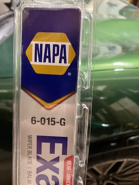

I'm also cursed with the measly 12" rear blade on my '24 Premium. The NAPA 15" I just put on today is actually part number 6-015-G. I needed the counter guy to help translate the 0-15-G number to an actual NAPA number. Slide off and toss the extra trim clip and you're set. Hardest part us lining up and snapping in the new blade. Picture hopefully shows I picked up about 2" of sweep on the upper tip compared to the stock 12". It's close enough to the edge of the glass I don't know that I need anything longer?
