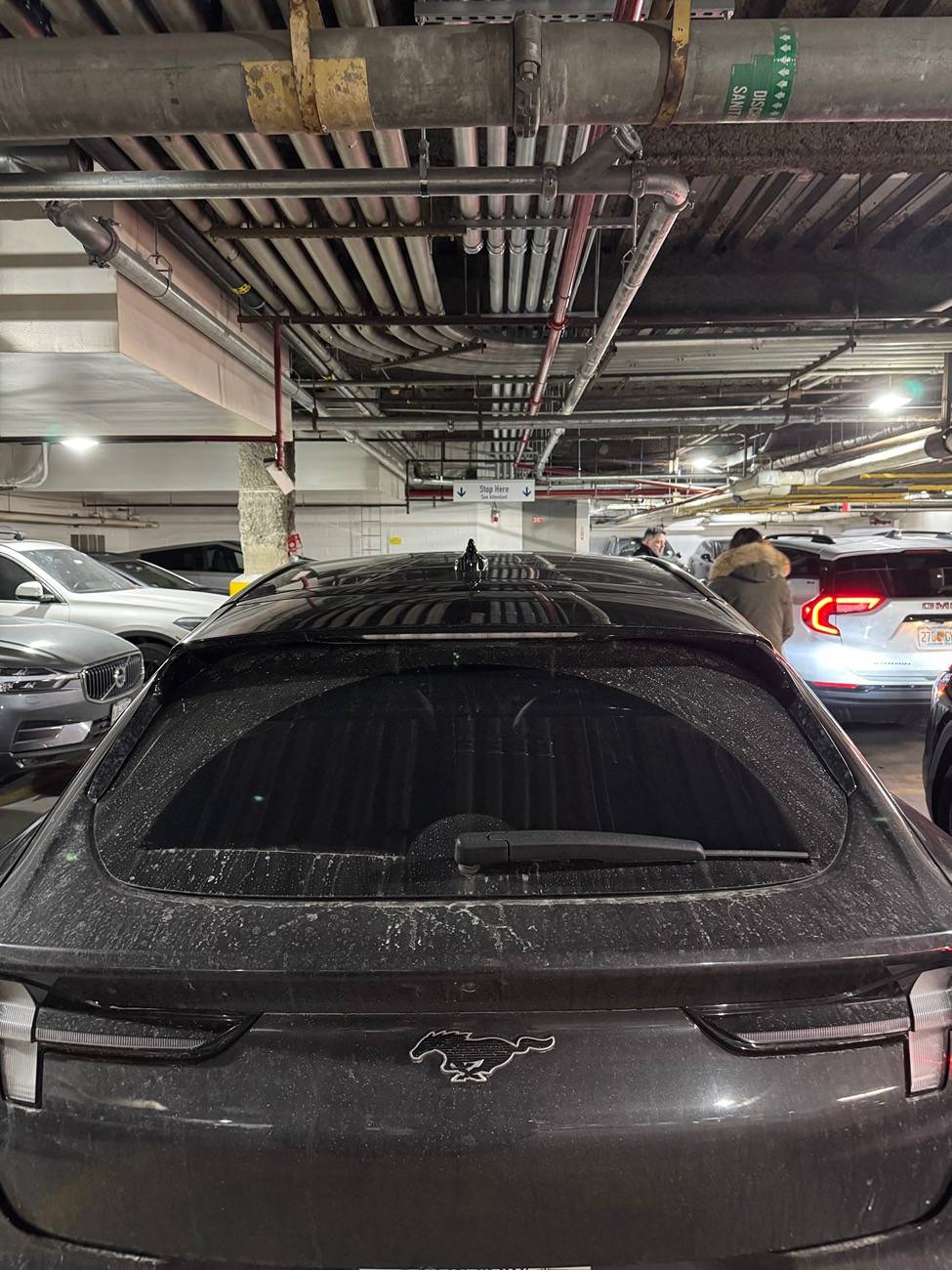

How long is this one?
Should be 14’’
Found this comment on mache reddit “Go to your Ford dealer and get the OEM type with the correct attachment mechanism. Ask for part number FT4Z-17528-D (14") or FT4Z-17528-DA (15") which are from a Ford Edge. They are exactly identical to the stock blade except longer.”
Sorry for the dirty window:)
