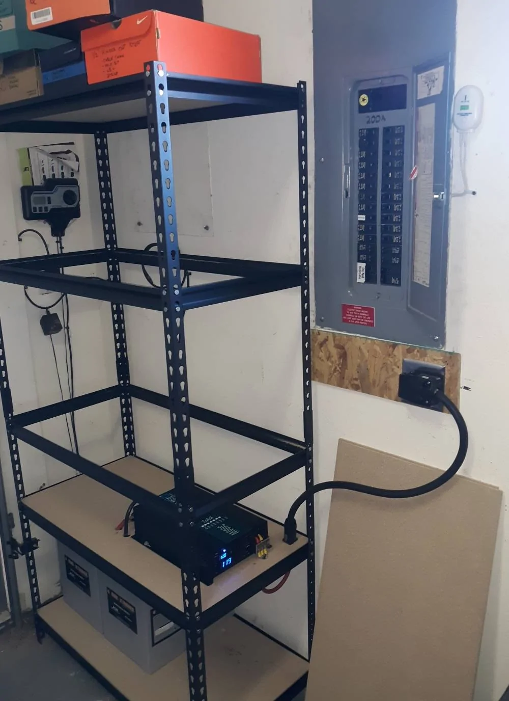

great timing... I was messing today around, and wired up a simple solution for using any existing 240v outlet to back feed energy from your MME, thru an inexpensive ($350) pure sine inverter 120vAC output, and Energize ALL your 'regular' loads.
I have NG heat, and no well pump, so my usual loads are 150 watts - 2500 watts
I used a 120v inverter as an example since they are less expensive, and eliminate the temptation for people to run the big 240v loads like hot tubs, a/c, oven, etc.....
basically, all you need at a minimum is:
- 120vAV pure-sine inverter (about $350)

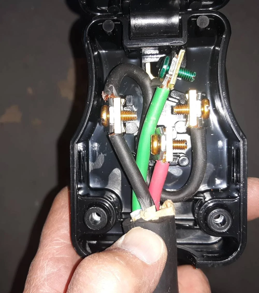

- 120v -> 240v Plug cord to energize both legs (<$100 for matls+ labor to fabricate)
- (optional) circuit breaker to prevent more than 2000 watts thru inverter

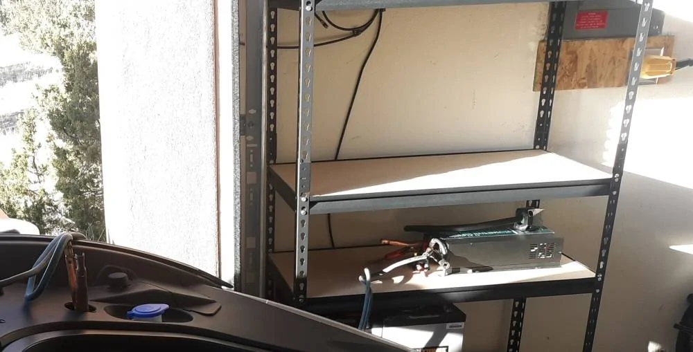

- jumper cables from MME LVB to inverter 12v input
- instructions.... you MUST turn off your Grid 'main' , and all 240v circuits besides the plug you are backfeeding before backfeeding power from inverter!!!!!!!!!!!!!!!!!!!!!!!!!!!!!!!!!!!!!!!!!!!!!!!!!!!!!!!!!!!!!!!
you *could* get a 12v->240vAC inverter, and have 240v power.... but probably not a great idea with a small inverter under 'emergency' conditions to run big 240v loads.
My home 'background load' for refrigeratior, lights, etc is 200-400 watts, with only the occasional spike when running microwave, etc. so in an emergency backup situation the average load is well below what the MME can keep up with.... if you leave it 'on', and disable 'auto-off' setting so the HV battery keeps the LVB charged. The cool thing is that my SR battery *could* run my house for about a week without any additional (solar) input in emergency situation.
