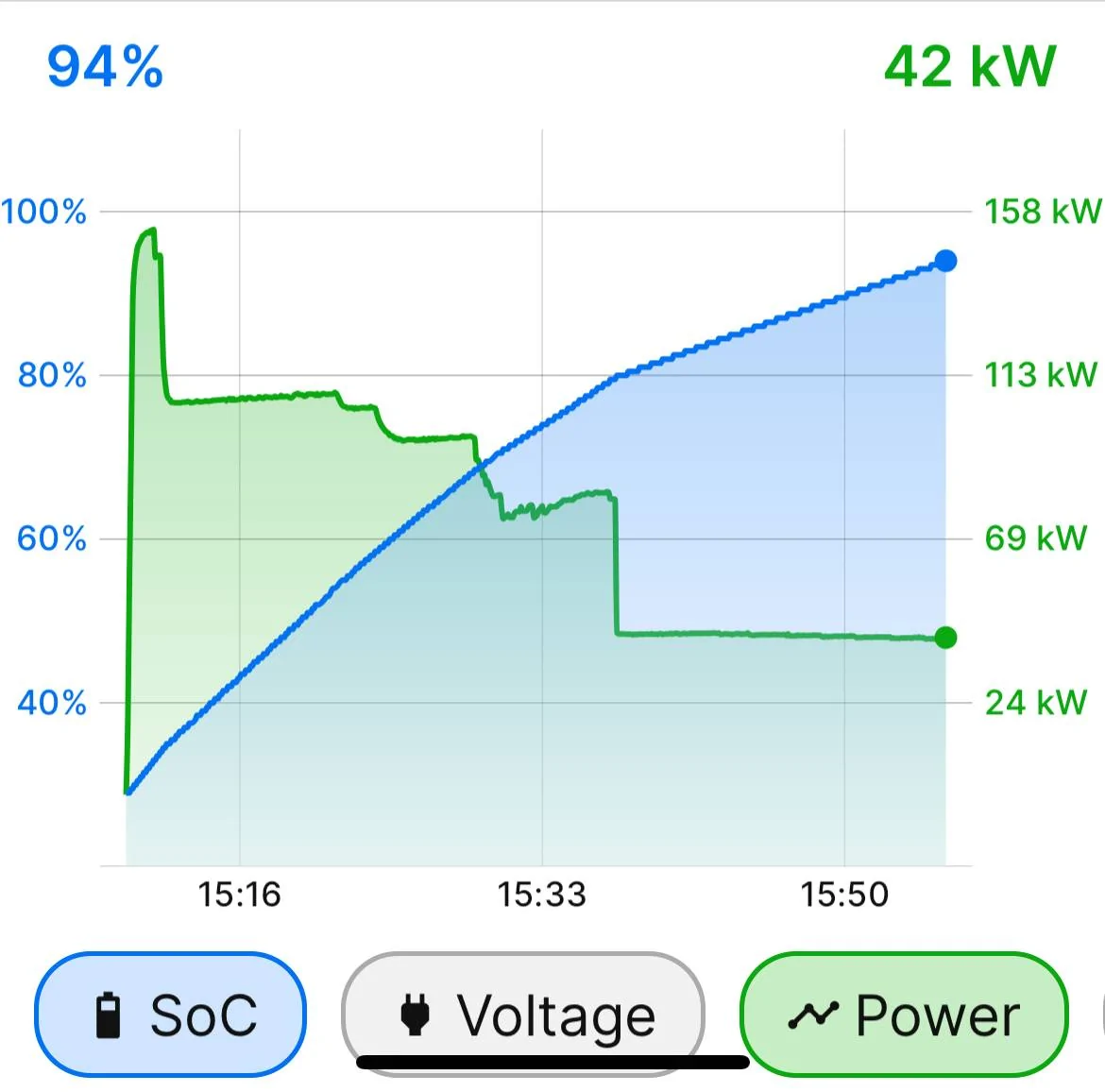

Sikkun
May 9, 2024
1,777
3,396
2023 Mach E
Mac E only hits 150 for a couple minutes of the charge, 105 is pretty stable until around 70% and then another drop.
At least on my logs.
