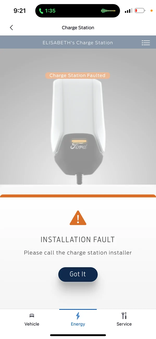

Major problems getting Ford Connected charger installed

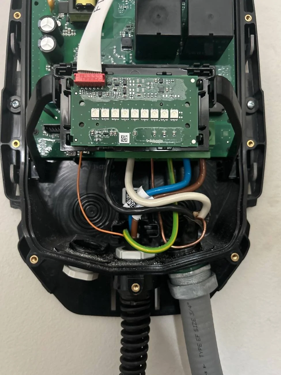

48A/60A is peak charger dip switch setting. It just means you can charge up to 48A on a 60A breaker. Yes, they used the proper gauge wire. That was the whole reason I had a 100A service installed in my garage. I wanted it to be able to use all of what the charge could do.
whew, ok, you should be good up to 48amps on a 60amp circuit with 6ga conductors, assuming everything was torqued properly.
