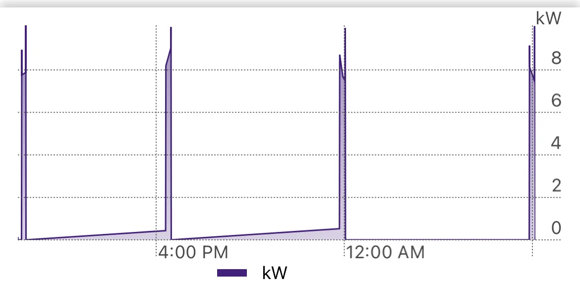

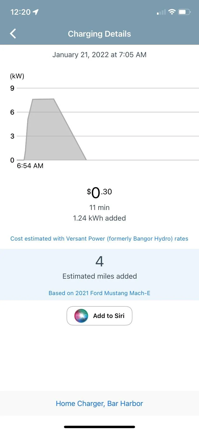

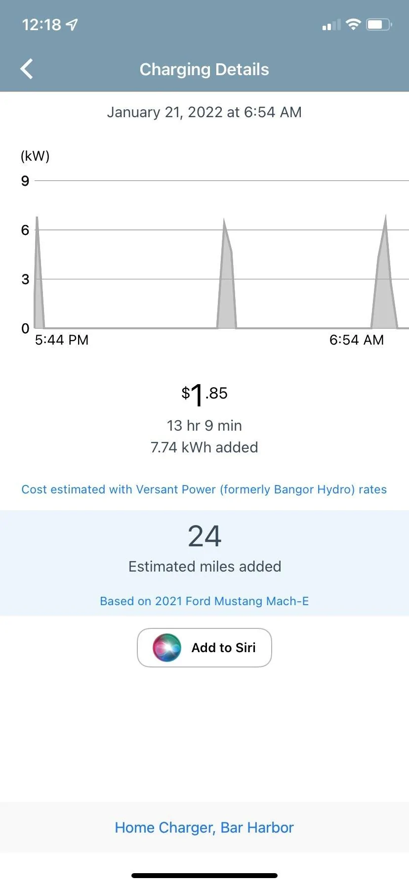

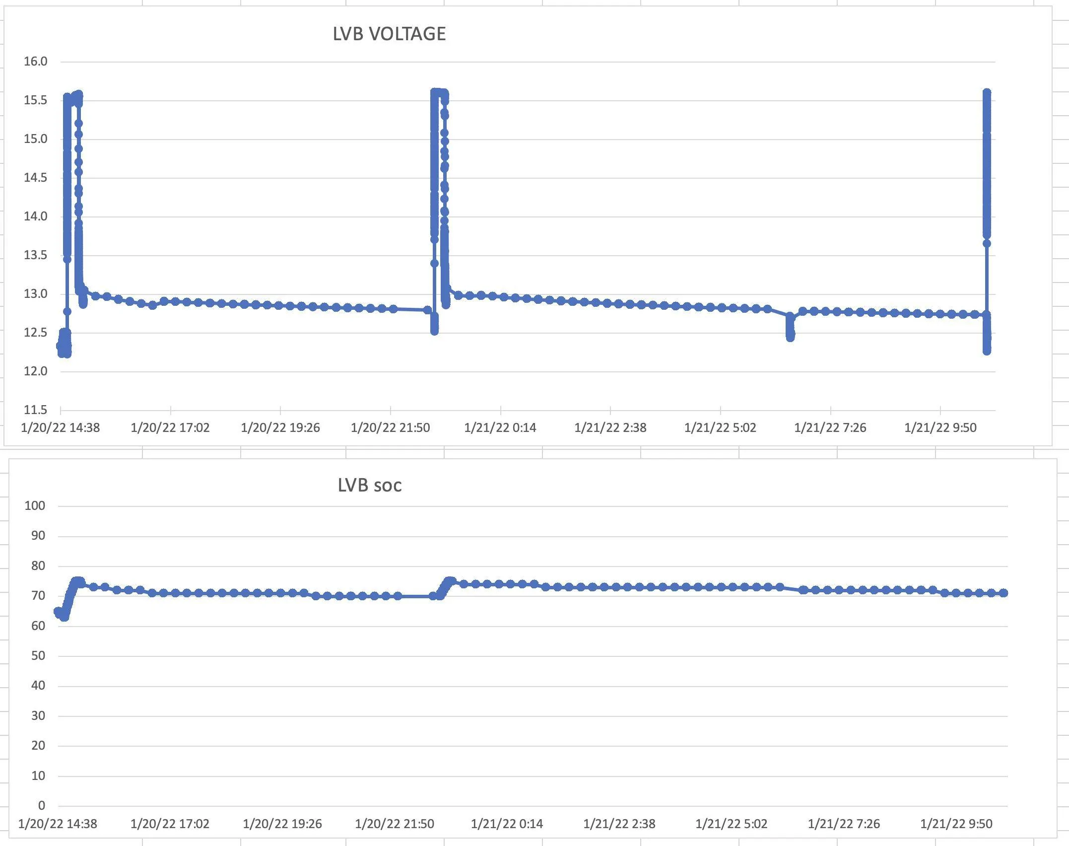

I got my first look at power usage in detail (Sense high resolution power graph) and LIN BMS LVB 12V data (BMS is the micro computer on the 12V negative battery terminal). Unheated garage, but still a bit warmer than outside it seems (original owner built it onto the side of the home, shingles and all still there on the home side.)

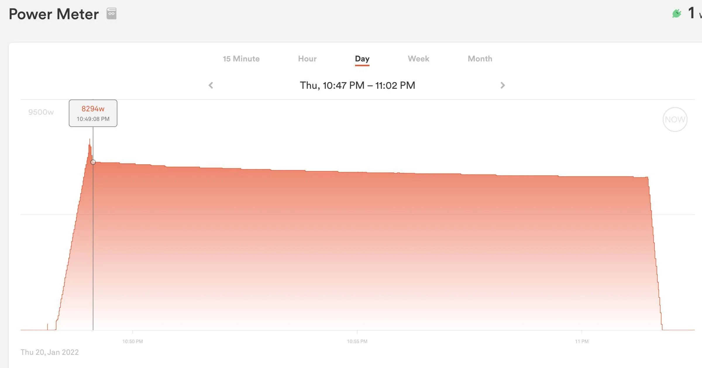

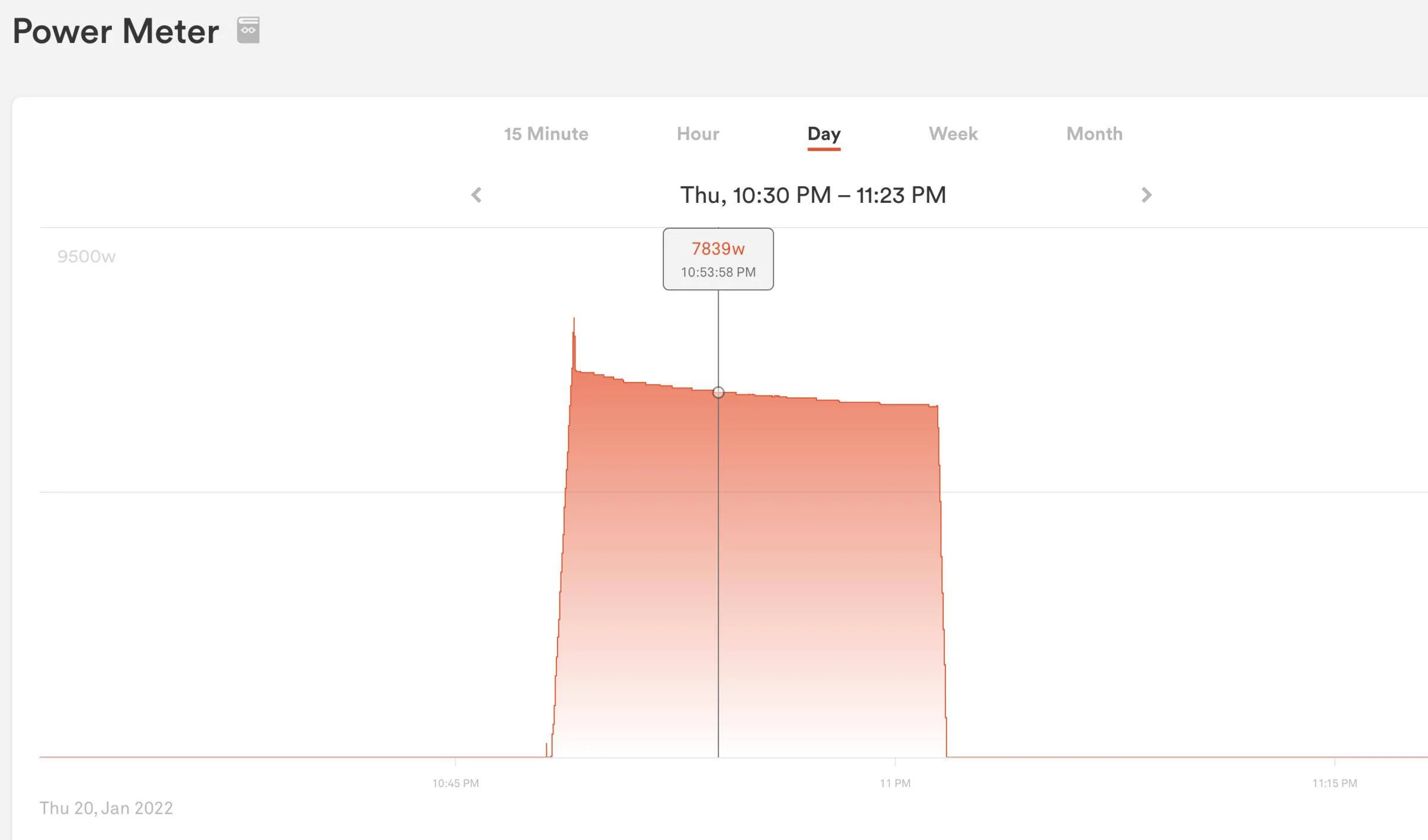

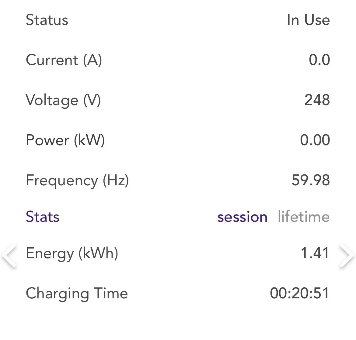

First DC/DC converter operation in the blue LIN data is where I ran a 15 minute precondition cycle. The DC/DC converter came on once more on its own at about 10:48 pm and stayed on for just under 15 minutes. The total energy draw the second time was about 1.7 kWhr. That is more than just charging LVB, so MME was probably doing some heating too. On this first look, I do not see any excessive L2 energy use plugged in over a cold night, as others have reported. Also, I did not observe any low level continuous draw (other than 1 or 2 watts for the chargepoint itself). The usage curve looks like what others with good resolution power graphs have previously shown. The spike on the right in the blue LIN graph, is where I unlocked and woke MME to open the frunk and retrieve the SD card from LIN monitor. That small negative .4V or so dip at 6:34 am is very likely the lights and pony coming on, not sure what woke it. It is possible that spurious wake events are part of the reason some LVB are discharging. As best as I remember, I was sound asleep, iPhone off, fob not moving.
There are a few more cold days, so I will try to add more graphs, still anecdotal to my FE, but hopefully I can add a few more, so more than just one observation.
zoomed in a bit

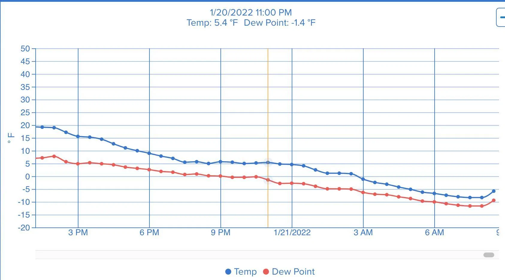

temperature on the outside wall of the unheated garage
zoomed in a bit
