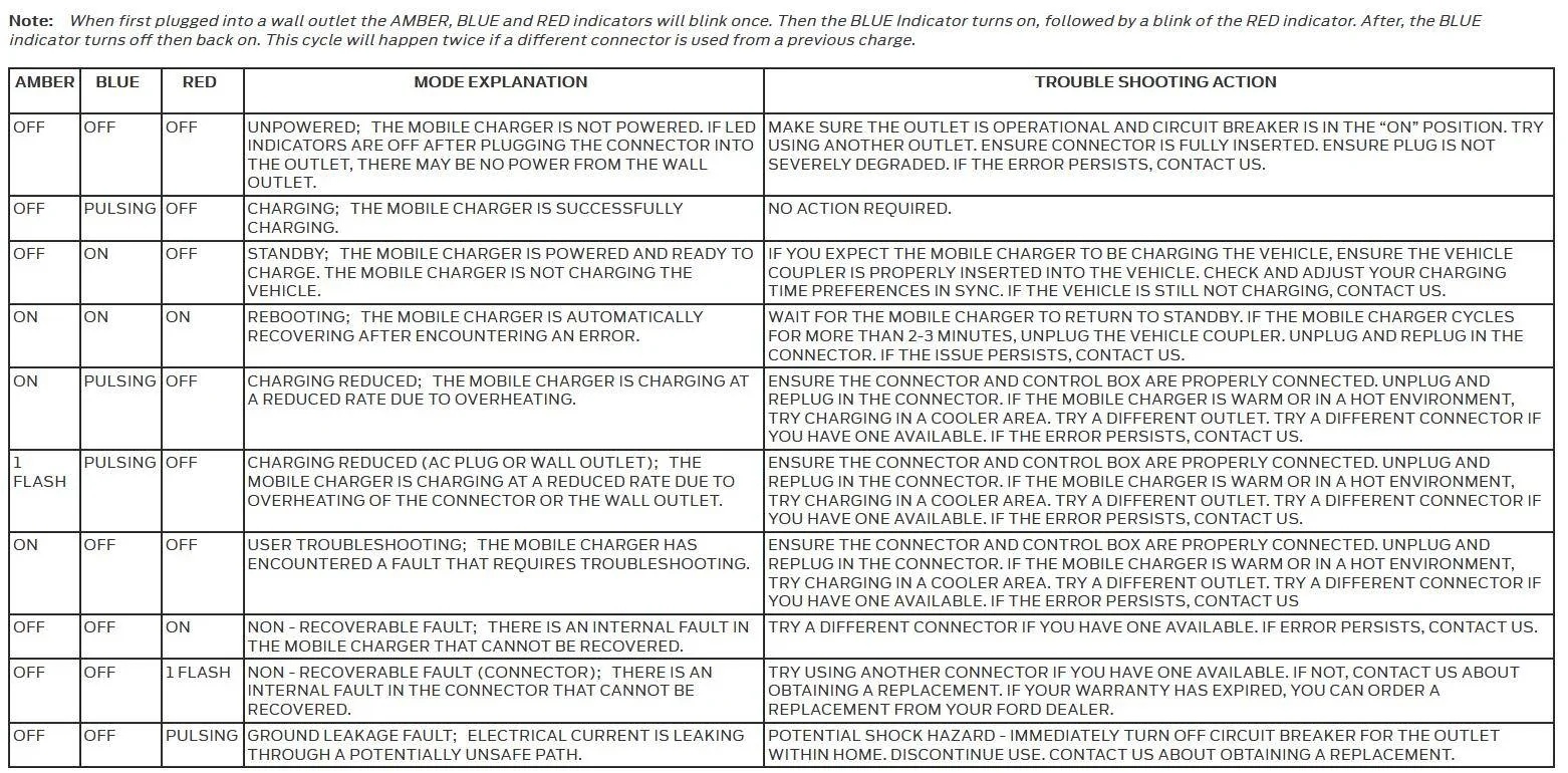

What are the indicator lights telling you?

The lights are Blue, Pulsing when initially plugged in. When the charge cuts off the lights go off. I tried plugging it in again and this time the charge has held for about 20 minutes so far. But the car is eerily quiet. I have never heard it this quiet when charging, which could mean it is receiving very few amps from the outlet?

No lights = no power. Me thinks you have an intermittent connection someplace.
It could be in the charger itself, can you power from a different circuit to check?
