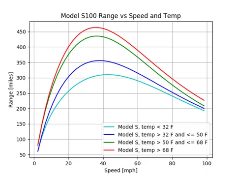

Most efficient cruise speed is 20-35 mph depending on how much heat you’re using. Shortest time with charging is difficult to answer because it depends heavily on charging speed, which varies widely. It also changes a lot depending on how many stops you’ll need, and if you’re close to needing another one or not.
I think you’re better off using ABRP and playing with the speed setting to see the effects. If you can slow down enough to eliminate a stop (and no slower) that’s usually the fastest method.
There is a practical limit to how slow you can drive on the interstate safely, but I’ve heard of some people going as slow as 55 mph to avoid a stop.
