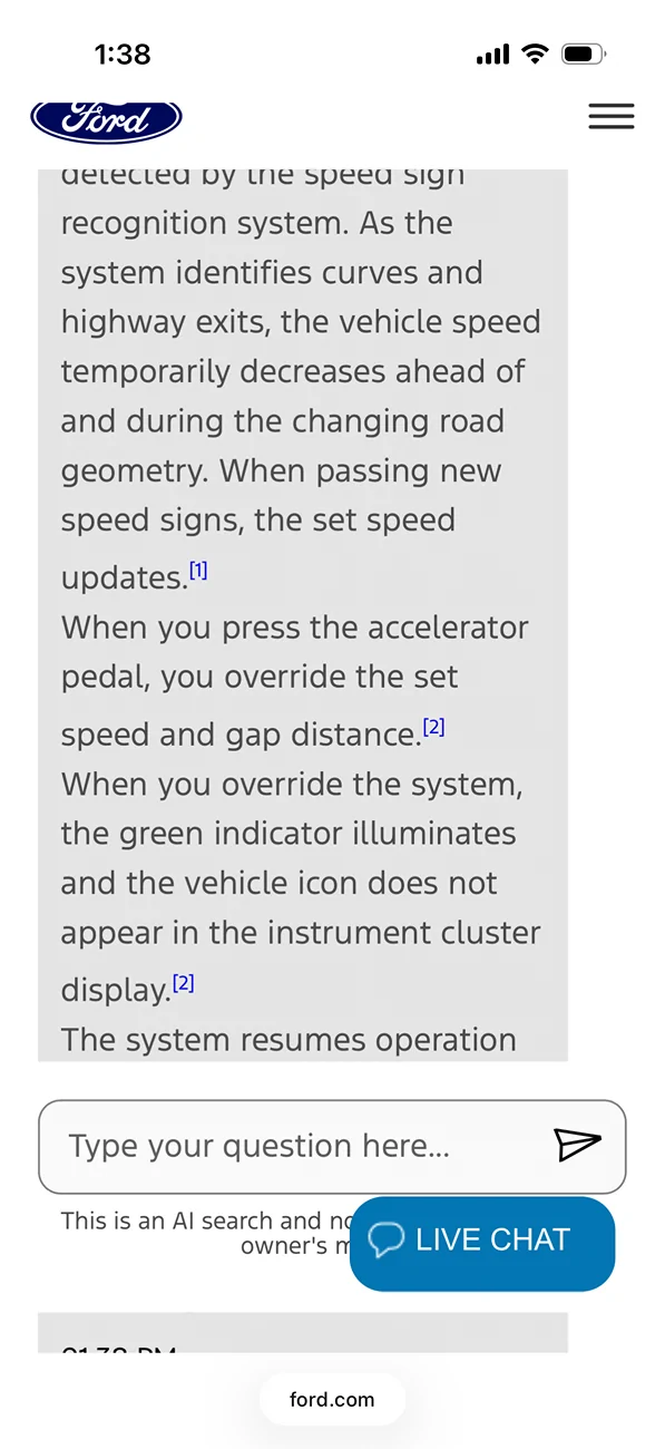

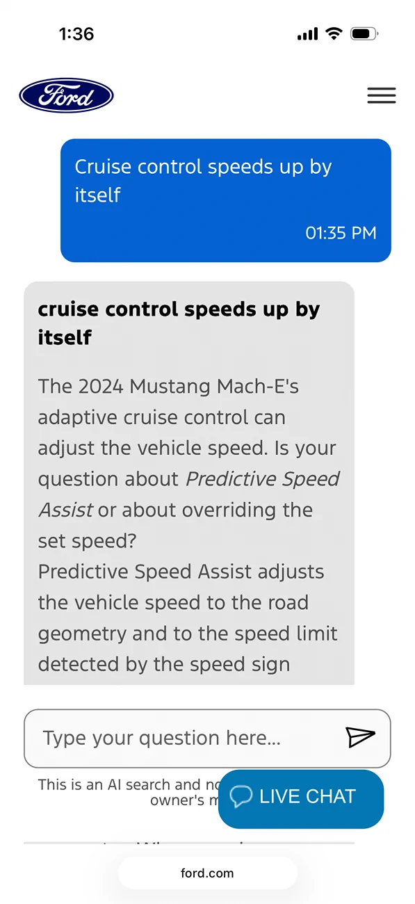

Found the setting. Thanks. The weirdest thing was when you would past a sign that had your current speed limit and it would increase the setting.
Not weird at all, since the setting we're referring to is how much to ADD to the sign it sees or has in the database.
I'm new to the Mach E and this forum, glad there are gatekeepers here. I did a search since it didn't come with a users manual and didn't find anything a. Others here were helpful and I found where they pointed.
It did come with a user's manual, built into the center screen. And, in FordPass. And, downloadable to every device you own in PDF form.
