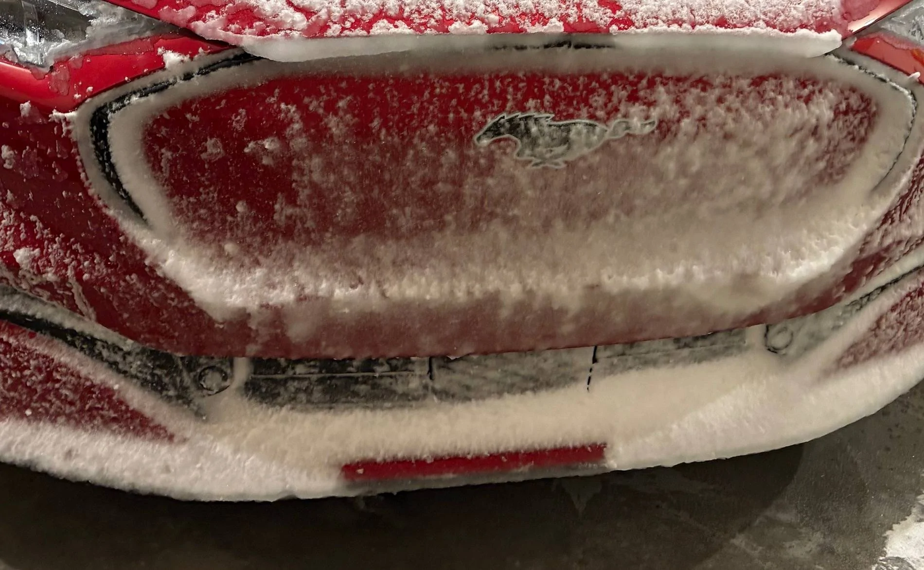

Yes, add the front radar to the list of locations you need to clear off when snow brushing. It will start to have problems once it looks like this:
Ford Mustang Mach-E Multiple sensor failures during and after driving in blizzard. Normal?? IMG_0535

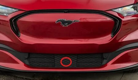

You have to clean off the radar for the adaptive cruise and crash avoidance to work. It's in between the grill shutters.
Not 100% sure I cleared snow from that area, but I think I did. Area was quite dirty but not covered with snow/ice when I got home.
But why did all the other sensors fritz out an hour or so later?
