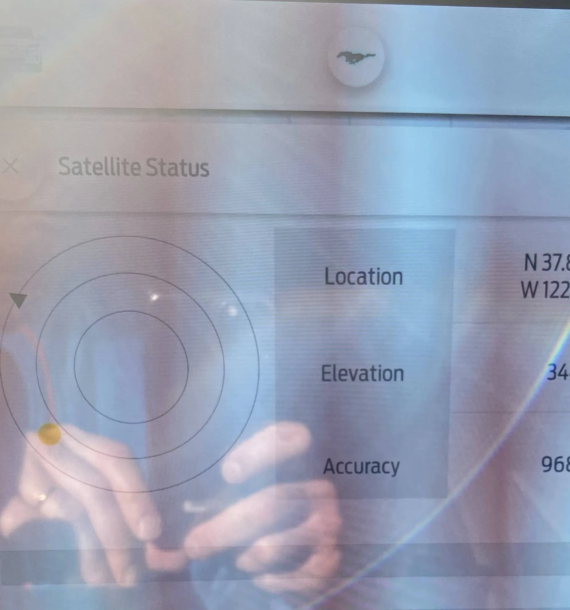

Same issue on my 2022 CR1 AWD.
Noticed it while I was driving today. Car’s location is about 40-50 miles off and it persists, when I drive - location changes but from the wrong base point.
SYNC reset didn’t fix anything, stop, lock, unlock, start didn’t fix it. Spent 40 minutes with Ford online & phone support - no luck either (got a case number and advice to take it to dealership).
I was driving on highways, open roads and across a long single deck bridge, so - the the satellite signal could not be the problem.
Did anyone try to see the nab satellite status (under navigation’s settings -> About -> Satellite Status …)?
It’s pretty empty in my case.
Yes. Mine was also empty when I checked and the location and elevation were far off (somewhere else in my state where my car's never been).

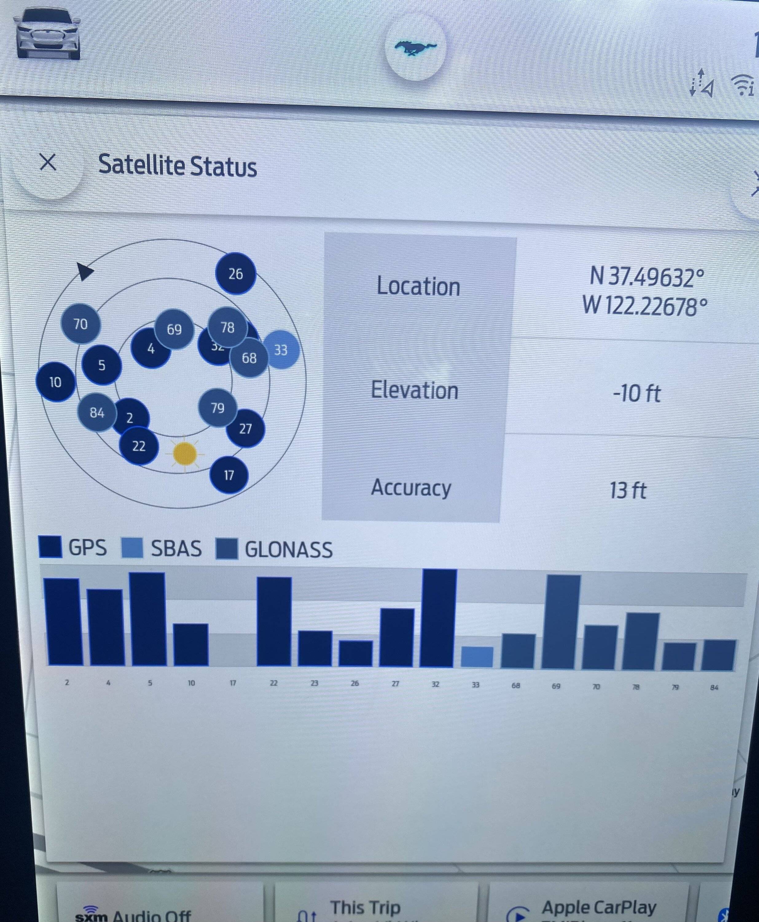

It could be HW issue as well. There are tens of thousands of cars running the same software, yet this thread is pretty small.
I wonder how the sat status screen looks when GPS function normally. Never bothered to check before I had the problem.

Did soft sync reset yesterday and no changes. 24 hrs later every thing is fine, all GPS related items working. In the near future I'm going to repeat my last blu cruise trip and see if the issue recurs.
My GPS was back to normal as well when I started the car this morning. The car was in exactly the same spot where I unsuccessfully tried to troubleshoot the issue with Ford support last night, nothing has changed.
I still took it to a local dealership to check up anyway, but they couldn't do anything, just verified that it's on the latest software.
Below is a photo of satellite status screen that I took when the car was parked under the roof of the dealership's service center, it was tracking 17 satellites even under a roof.
