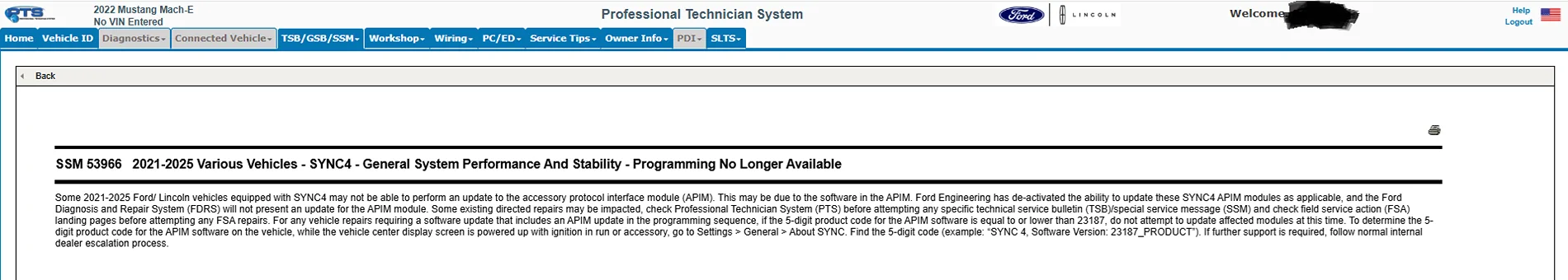

There is nothing stuck. Ford has released an SSM to all dealers that many vehicles on Sync 23187 and below are purposely not showing any updates.
Ford Mustang Mach-E Need Help with OTA Updates (or lack of) Untitled
This has been talked about on the forum for months since Ford sent this out to dealers in June and the SSM is still active. There is nothing Brian or your dealer can do. Ford knows, they are working on it and there is no time frame as to when they will release more updates for any and all affected vehciles.
Did not know that, so i have sent this PDF to my dealer asking them nicely to sort it out.

I'm aware of that one, but what about all those years/months before that?
I'm my case it was you who pointed out a problem with the IPMA module. Both dealer and Ford Netherlands were working for months on my car, and both did not come up with this!
My apologies......based on the wording I used, it may have seemed like my response was targeted to you, but that was not the case.
Aside from the SSM I mentioned, it is known that vehicles outside the US are limited to how far they can update the Sync modules. Not just Mach E's.......all Ford vehicles. By being on this forum and seeing the US vehicles on Sync 24xxx and 25xxx, this may present itself in a way where you guys are falling behind. While this is true in a sense, this is not by mistake. Ford (for whatever reason) is not sending more updates to Euro spec carson purpose.
I understand you guys' frustration about wanting the newer updates, but until Ford decides to release more for your markets, there is nothing you can do. The dealer cannot help. Brian cannot help. Having FDRS will not help. Sorry to be the bearer of bad news, but all you can do it wait.
