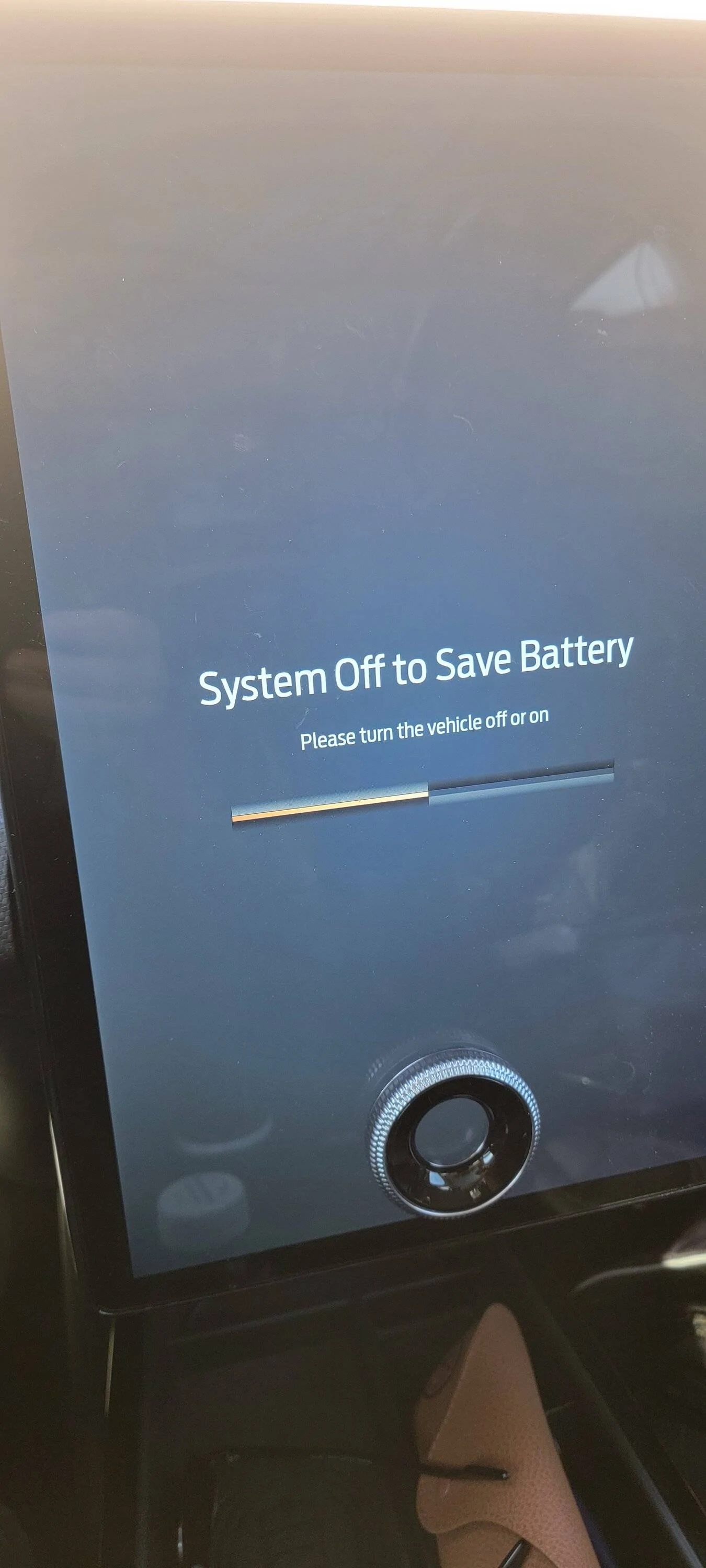

Yes, I did. I wired in a Rexing Dash Cam (Wired Constant and Switched) yesterday and this morning received this message and while driving I got Audio Failure for a minute. I should have included this in my original post. I actually like the new sounds, it sounds louder and more distinct. I dread trying to open the area to disconnect the 12-volt battery... Parking Mode did not work so I may need to check the connections, but I followed a previous poster. Thanks for the info!
Ford Mustang Mach-E New Sounds 20220613_081826
