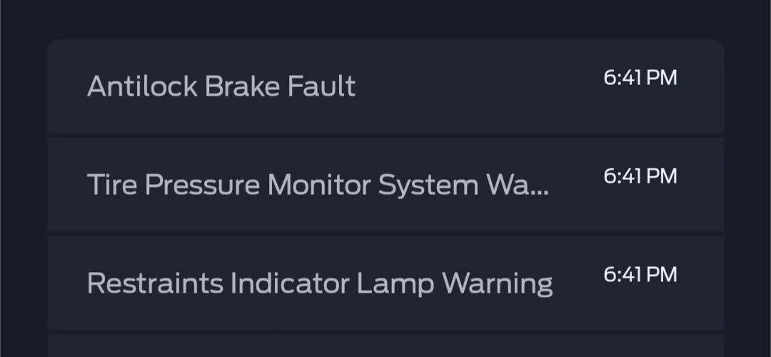

It just threw a bunch of faults via the app.
Ford Mustang Mach-E No display and a chime??! Screenshot_20240612-185122

It is the instrument cluster. Needs a new one. Luckily it is in stock!
