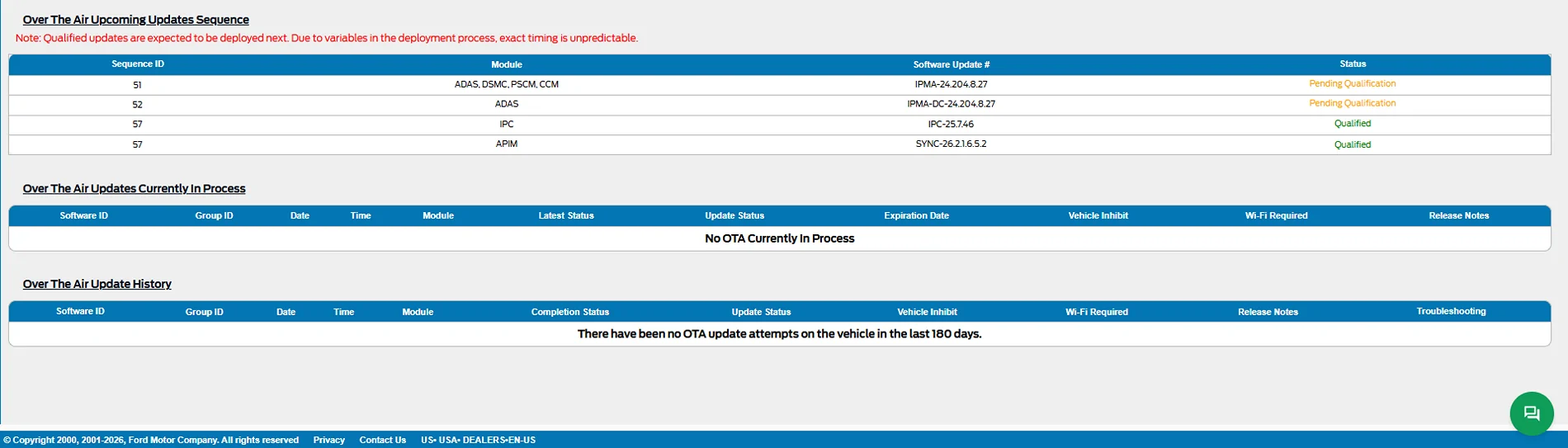

Message me the VIN and I can poke around to see if I see anything useful. That whole "pending" thing that Ford added to PTS is very new and Ford never sent dealers any info as to how to interpret that. Basically, pending qualification means you aren't getting anything any time soon, but if at least one update on the list shows as "qualified", it means you can get that OTA sent at some random point in time.

Nothing to worry about in your case. Your car is on a very new version of Sync (looks like 25094) and it shows the latest APIM OTA update as "qualfied" as well as an IPC update. The other two updates showing as pending you already have installed. One is for the software for BC 1.3 and the other is to enable the config for lane change assist and the other BC 1.3 features, but I see those are already enabled in your car. When they send those IPMA updates, they will most likley fail since you already have them, so don't worry about it if and when it happens. You vehicle seems to be almost fully up to date.

I am looking in PTS which is Ford's dealer website/tool.

Maybe a dealer installed the updates at some point. Hard to say since I cannot see vehicle history anymore. Until you get sent another OTA, that screen with the details of the last OTA you got sent are what you will see any time you check for updates. Hard to say with limited visibility, but what I can tell you is that you're not far behind and I would not be concerned about it.
