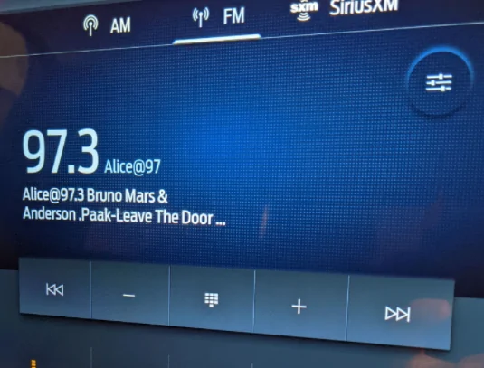

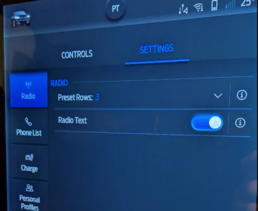

Yes, my settings only have two options, Preset Rows (which I now notice reverted back to 3 from 4 ?) and then Radio Text. I'm tuned to a station which should have HD subchannels. The direct tuning only has 0-9 and no dot as I would expect for sub-channels.
I don't remember if there was a setting a few days ago and it disappeared. I seem to remember a setting but I could be mis-remembering.
I guess this answers the question then. No HD Radio on your Select. :(

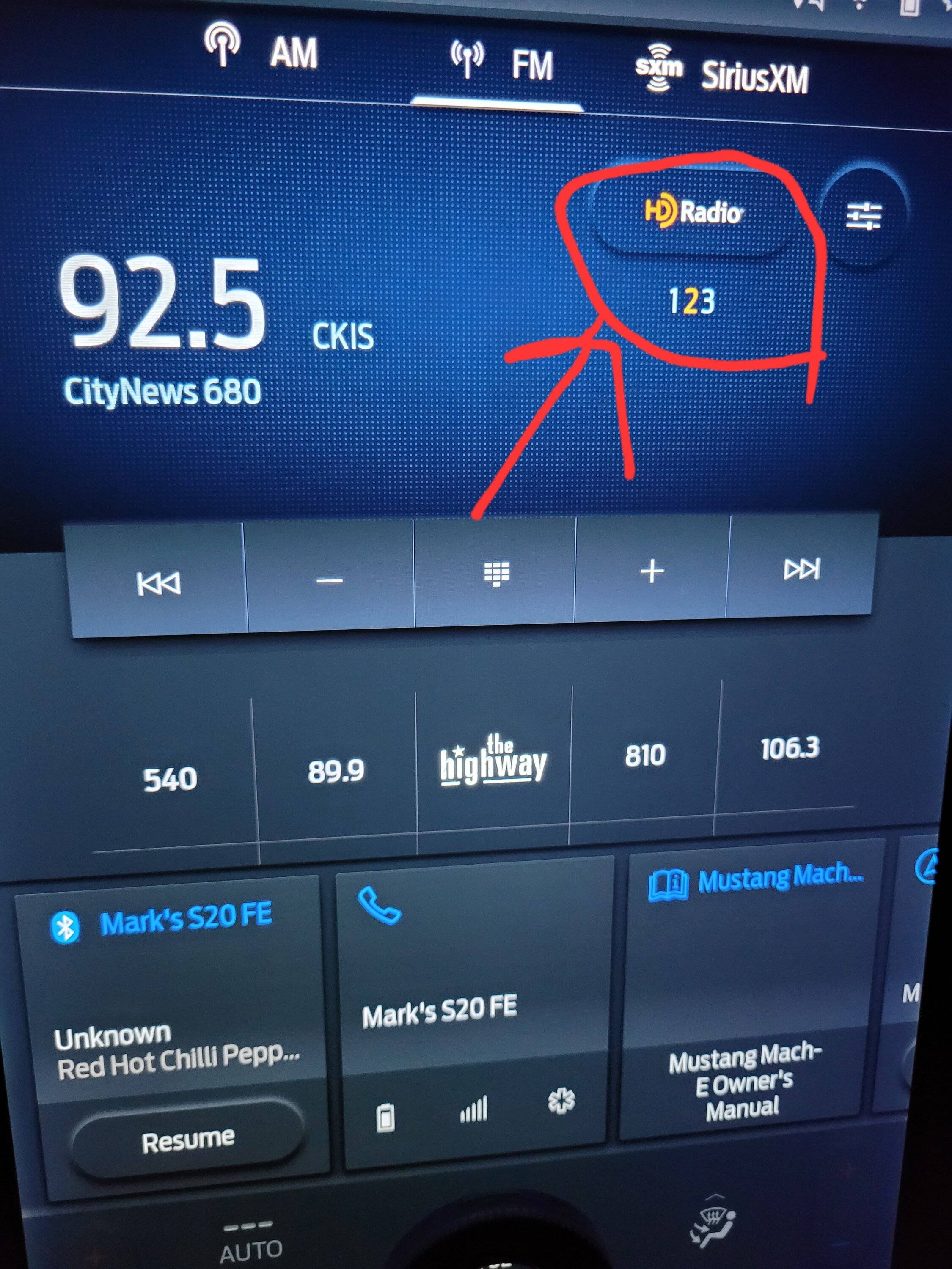

This suggestion worked! We just picked up our Mach-E Premium yesterday and wanted the HD radio stations, love the car
