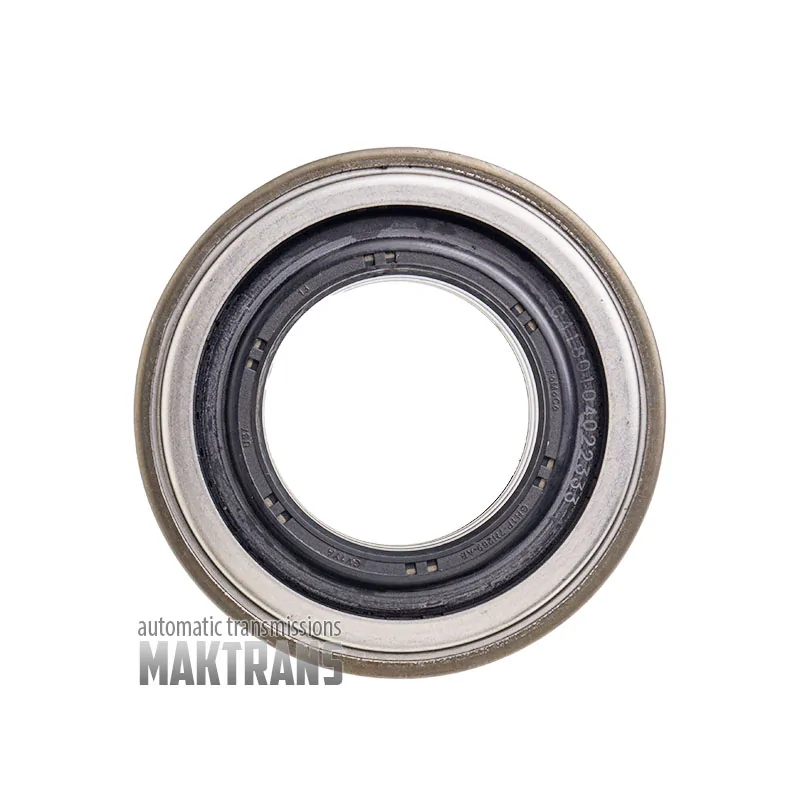

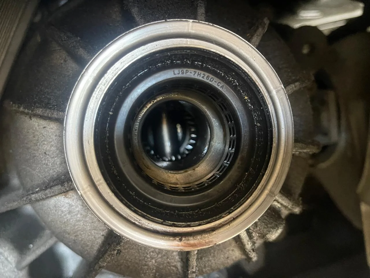

Hi everyone, I have a 2023 Ford Mustang Mach‑E RWD only and I’ve noticed an oil leak from the left rear axle area. Is this a known/common issue? Does anyone know the correct part number for the axle seal (or related parts) so I can order it? I live outside the U.S. the ford dealer here in my country told me when do maintinance to the MAch E yet.
I attached 2 photos one is the actuall part .part#(LJ9P-7H260-CA) .
The 2nd photo for the part i bought but it did not fit part # (LJ9Z-7H260- E)

Not sure how common it is because I don't see this issue much here on the forum but I did have this seal replaced on my 2021 at around 48K miles. It was taken care of under the extended warranty so I have no idea how much it would have cost.

Replacement Part was LJ9Z.7H260.B, it was superceded to LJ9Z.7H260.E
LJ9Z7H260E is the part you need according to Ford systems for your VIN.

Thanks for responding , i bought that part# you mentioned but it was a little smaller than the originall
