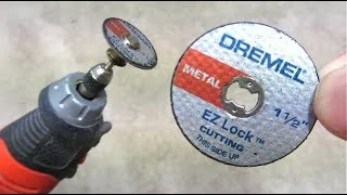

Wow, really? You can't figure out how to open the frunk, or car, without a 12v power source. Couldn't be easier...
Ford Mustang Mach-E Opening doors when battery is dead mqdefault
